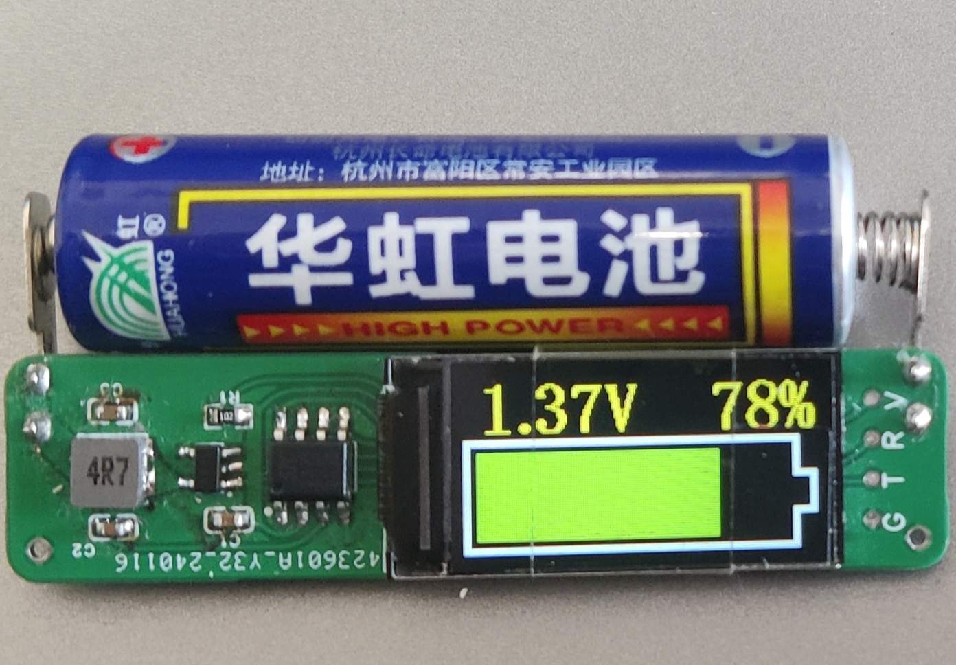

This project provides a clear
        and intuitive display of dry cell battery voltage and charge percentage, allowing users to easily monitor battery information.
The working principle
        utilizes a PW5100 boost IC to raise the battery voltage to 3.3V, powering the STC8G1K08A microcontroller and a 0.96-inch display (160*80 resolution). The microcontroller's ADC pin acquires the positive terminal voltage of the battery, determines the corresponding charge percentage based on the voltage, and sends the data to the display via the SPI interface.
Key concepts include:
        51 microcontroller, boost circuit, ADC, SPI, color screen, dot matrix, character modeling, line drawing, and graphics. Suitable for microcontroller beginners.
Design features:
1. Single-layer PCB design, voltage detection range 0.4V~3V (suitable for 1.5V dry cell batteries; above 1.56V, the charge is displayed as 100%).
2. Simple circuit, material cost around ¥5, can be hand-soldered, suitable for beginners.
3. Reserved serial port for easy program modification and debugging.
4. Consumes approximately 10mA of current, closer to the battery's operating voltage than a multimeter measurement.
