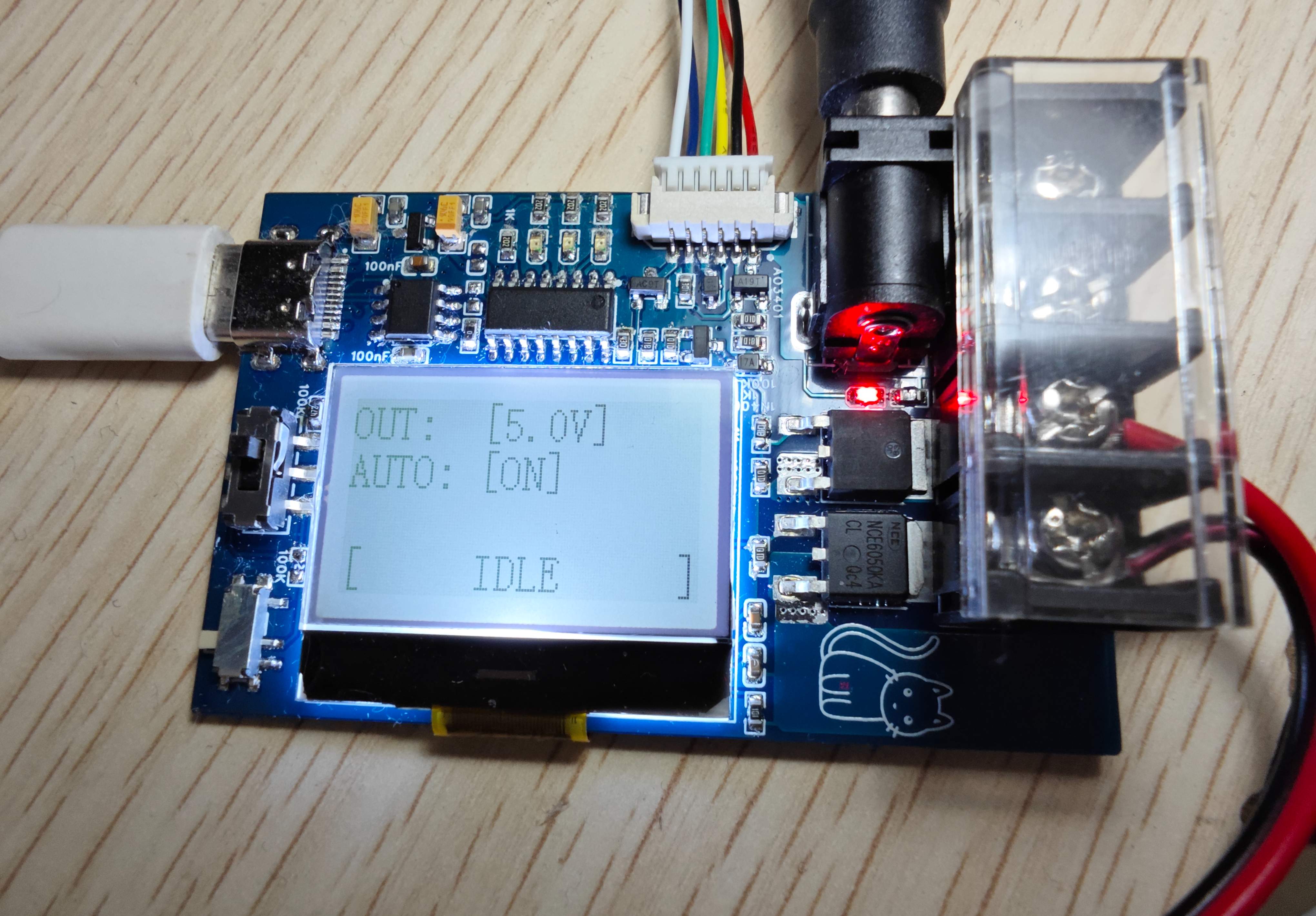

The previously DIY [【Cold Start Programmer】(https://oshwhub.com/monhoi/stcautodownload-versw)] could only program bare chips. When the microcontroller board had many resources and an external power supply (more than 5V input), it became useless.
Therefore, a new version was designed that can switch on and off power supplies up to 36V. This programmer controls the overall power supply to the STC microcontroller board, enabling hands-free, one-click programming. See the demonstration video below.
When the compile button is clicked in Keil C51, the download software STC-ISP automatically initiates programming. The automatic programmer detects the download command, disconnects the power supply to the target board (including the microcontroller on it), restores power after 1 second, and begins programming.
The LCD screen is negligible and not necessary.
![Front]
![Back]
![Wiring Instructions]
