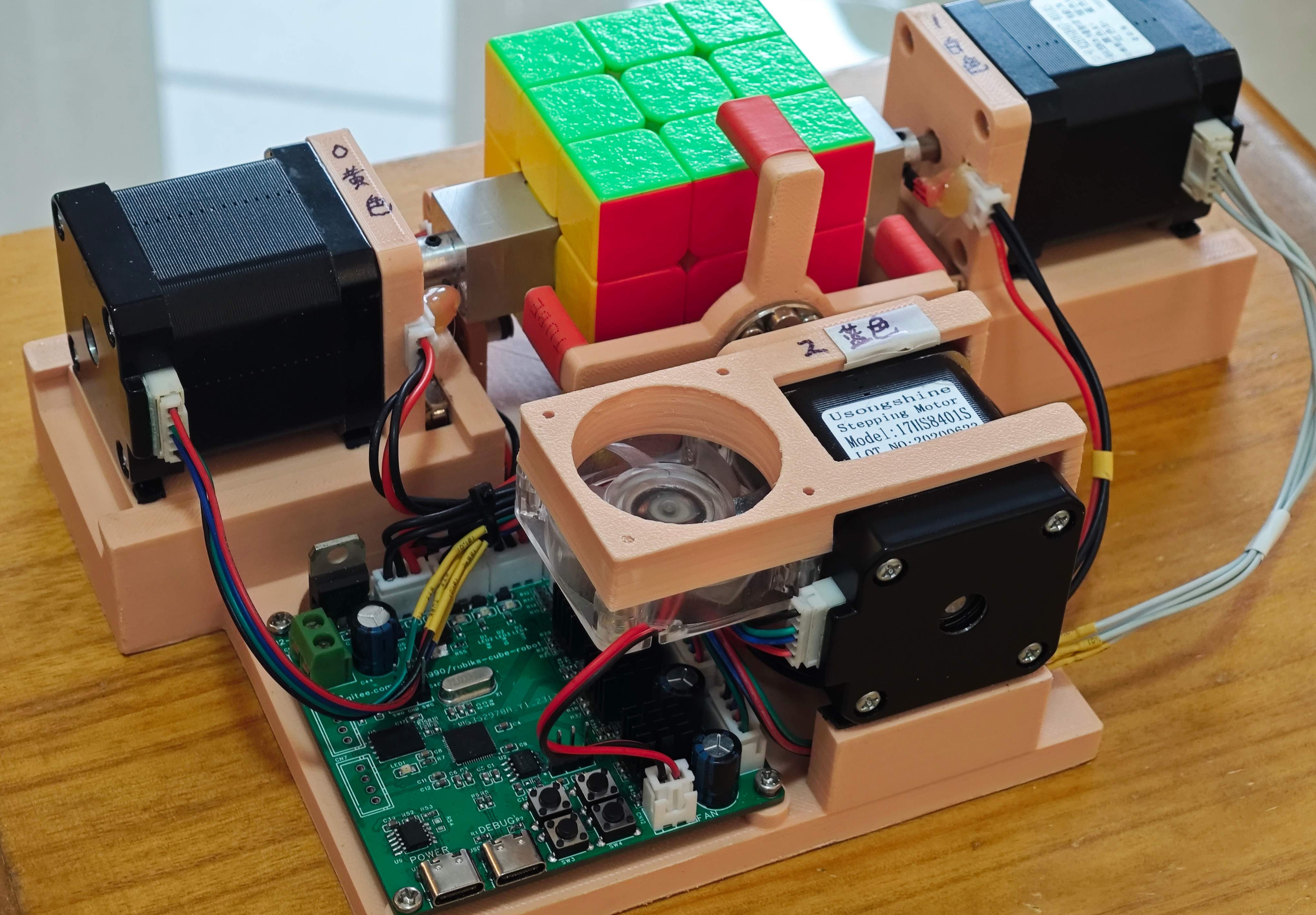

This article, "3x3 Rubik's Cube Solving Robot,"
(https://gitee.com/hemn1990/rubiks-cube-robot )
, introduces
a low-cost Rubik's Cube robot design. It includes schematics, PCB layout, microcontroller source code (C language), structural diagrams (OpenSCAD/STL format), and a BOM for major components. It uses an RP2040 microcontroller for control, with both control and cube solving handled by the microcontroller. For randomly scrambled cubes, the average number of steps to solve is around 21, with a worst-case of 22.
Version 2.0 updates include:
1. Schematic and PCB layout provided.
2. Resolved the issue of short lifespan, breakage, or loosening of the slide's latches by replacing them with magnetic fixation.
3. Supports power supply via Type-C chargers from mobile phones or computers.
4. Resolved the issue of the cube clamping structure loosening after prolonged use and potential breakage under abnormal conditions.
5. Optimized the Hall switch installation method, simplifying the installation process.
6. Resolved the issue of excessive noise from the ratchet structure.
7. Provides a detailed assembly tutorial suitable for beginners.
8. Improve the bill of materials.
9. Supplement performance test data.
Future updates planned:

About hardware design
2023-12-25 Update: Added schematic diagram and PCB design files
2022-07-07 Update: SPEPPER_EN changed to GP2, added SPI NAND FLASH model W25N01GVZEIG
2022-07-10 Update: Buttons changed from GP0, GP1 to GP27, GP28) Only modified ./src_21_step
Connect the GPIO of the RP2040 microcontroller to the stepper motor driver, color sensor, and Hall sensor. Except for SPI and UART, only GPIO is used for other pins, and no other multiplexing functions are used.
The Hall sensor can only be powered by 5V, while the RP2040 microcontroller IO is 3.3V. Pay attention to the level conversion design.
FLASH is optional. If FLASH is not used, the average number of restoration steps is about 32.
The reference GPIO allocation method is as follows:

: 1. ABS material is recommended for 3D printing, with a nozzle of 0.4mm, a layer height of 0.2mm, 5 layers for the top layer, 5 layers for the bottom layer, 4 outer shell rings, and 20%-40% infill to generate supports. For
