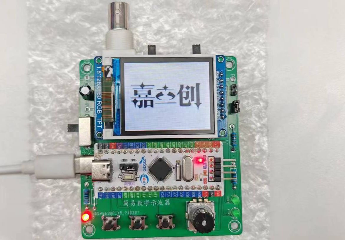

This is a simple digital oscilloscope project based on the GD32 microcontroller. It's in the beginner's section, so the hardware details won't be explained in detail.
Please see the readme file in the Doc folder in the attachments for specific instructions.
I prefer using UTF-8 encoding in Keil to ensure compatibility with various needs, so I generally don't include Chinese comments in the project. The English comments are similar to construction site jargon, and I think it's necessary to write a separate document to explain some aspects of the project. This project is based on the open-source code by Mr. Chen from JLCPCB, with some modifications. The open-source website is: https://gitee.com/chen11232/GD32E230-Oscilloscope.
Let's start with main.c, which includes clock configuration, LED pin initialization, and KEY pin initialization.
After the initialization function, a JLCPCB image is added as the standby screen. Toggling KEY1 skips this screen and enters the normal program. The header file containing the image has been removed from files with the "Simplified" suffix, which may shorten the download time.
The standby screen program is implemented as follows:
LED pin initialization and KEY pin initialization are relatively basic and will not be discussed in detail. Of particular note are the `Key_GetState()` and `Key_GetNum()` functions in `Key.c`. `Key_GetState()` returns the key value corresponding to each key pressed. For example, if key 1 is detected as pressed (GPIO PB13 pin is low), the key state is returned as the return value. In `Key_GetNum()`, the previous and current key states are read. If a key is always pressed, the current key state will never be zero, and the function returns the previous value of `keynum`. Only when a key is released does the function begin to determine which key was previously pressed based on the previous state. For example, if the current key state is 0 and the previous key state was 1, then KEY1 can be considered pressed, and the key value of KEY1 is returned.
