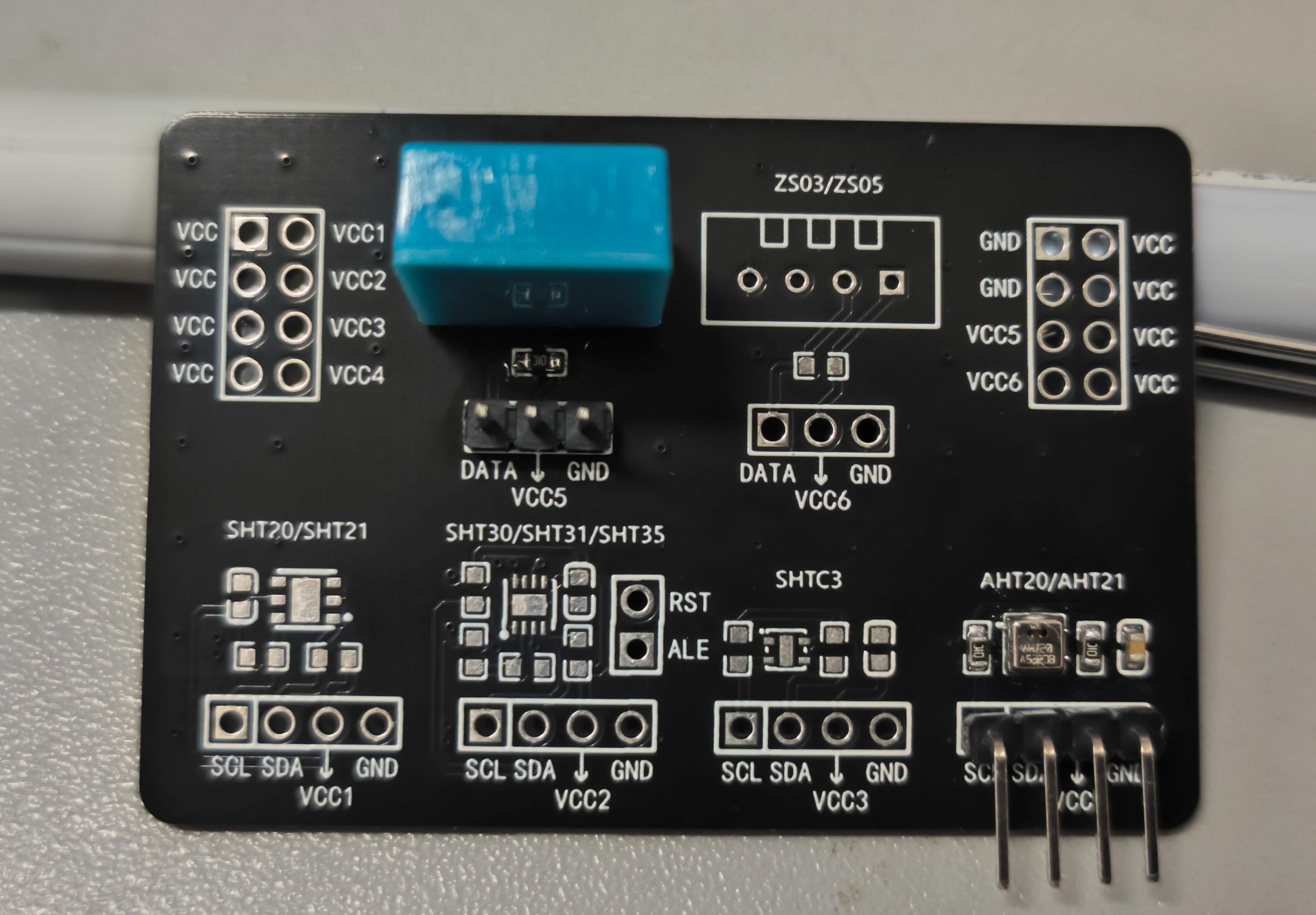

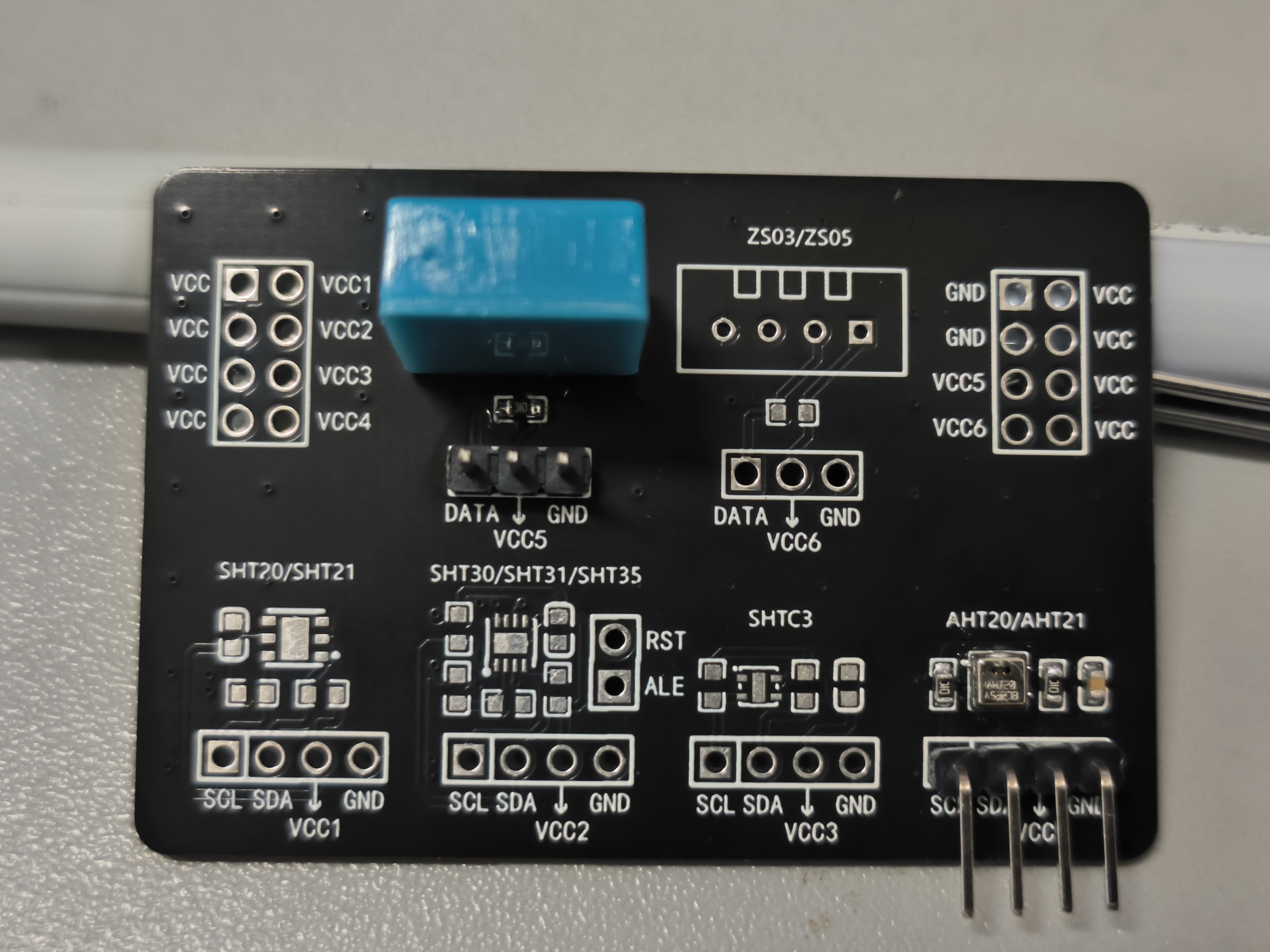

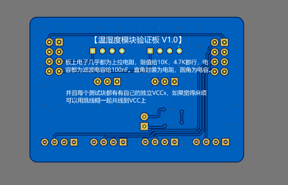

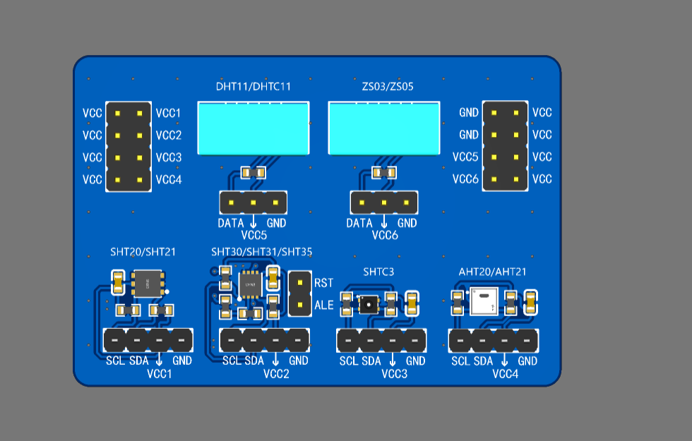

Verification board for multiple temperature and humidity modules
The board integrates various commonly available temperature and humidity sensors for convenient on-site verification and testing.
![Verification board.png] ![Verification board (back).png] ![IMG_20240331_184654.jpg]
