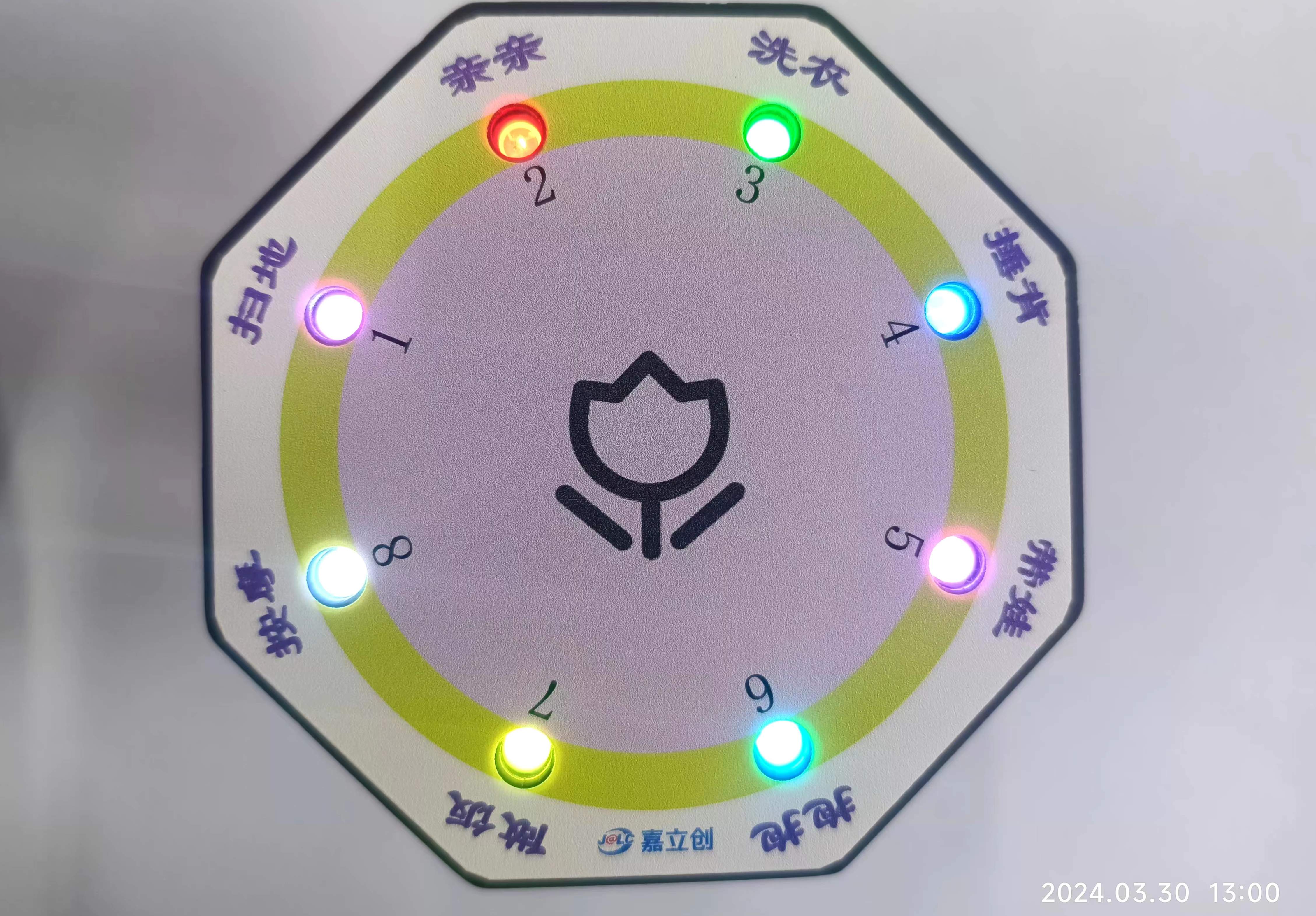

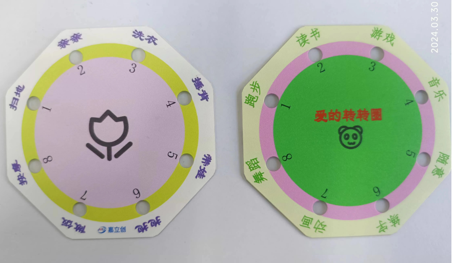

Love and Reward Mood Light
Preface:
I've always wanted to create a reward and punishment game-themed ambient light. It would be usable as both a game and an ambient light.
When awake, it could be used for interactive games for adults or for playing with kids. The game content could be customized via a panel—any reward or punishment would be possible, haha.
At night, it could be colorful, a breathing light, or simply create a specific atmosphere… Basically, it's always on 24/7. Haha, just thinking about it sounds fun!
Here it is, with customizable rewards and punishments.

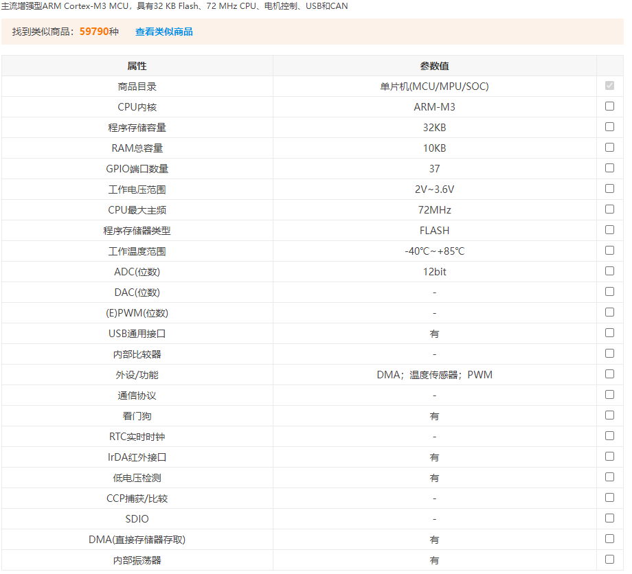

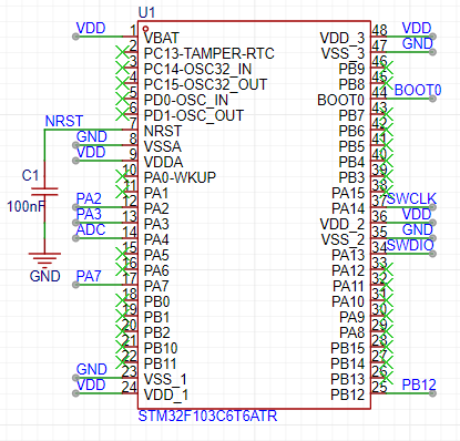

The main control unit
uses the STM32F103. Why choose this one? It has sufficient functionality and abundant resources. See
the design below:
Main functions:
1- Control the voice module;
2- Control the LED display effect;
3- Implement a random algorithm;
4- Implement power detection;
5- Parse voice commands.

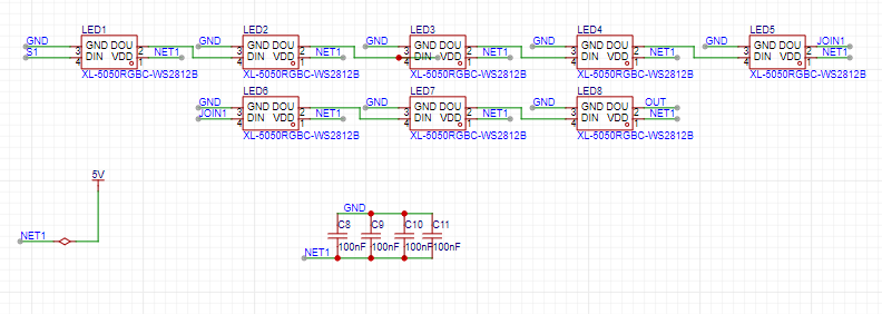

The WS2812 display
circuit
uses eight WS2812 chips. Because they can be connected in series, only one IO is needed to control the display effect and color changes, saving a lot of MCU IO resources compared to LEDs.
Note: The power supply voltage should not be less than 3.5V; the higher the brightness, the higher the power consumption.

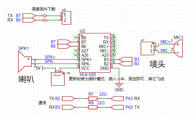

Voice module
HLK-V20 schematic diagram
receives data through serial port, default 115200 baud rate.
Note: The label must be of good quality, otherwise it will be very insensitive. A slightly inferior speaker is okay, as long as it makes a sound.
The label must be of good quality!
Choose the right label!
HLK-V20

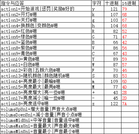

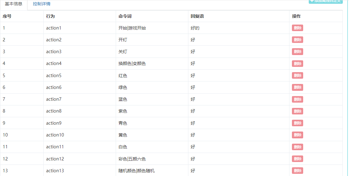

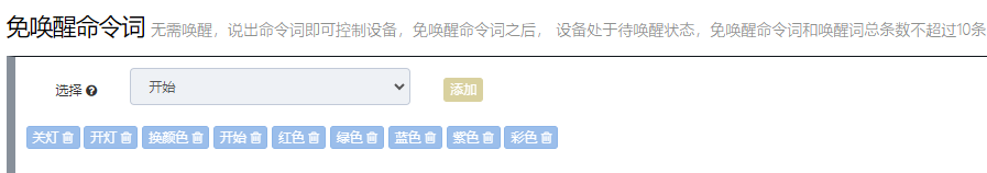

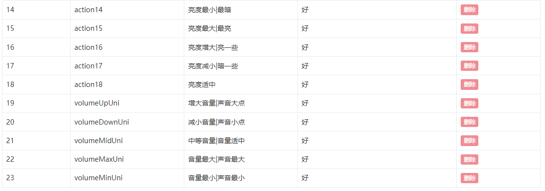

requires customized voice control commands.
My control commands are as follows:
Each module needs to download the customized voice commands first. For specific customization methods, please refer to the Liangshanpai Module Porting Manual.
My customization details are in the attachment; you can download and use them directly.

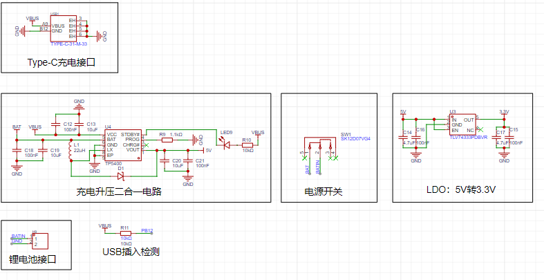

Power Supply
Design:
1- Charging via Type-C

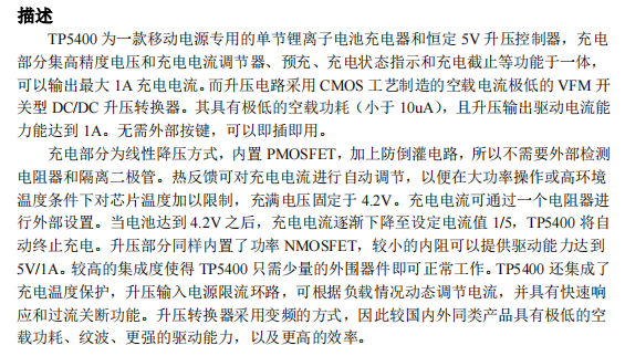

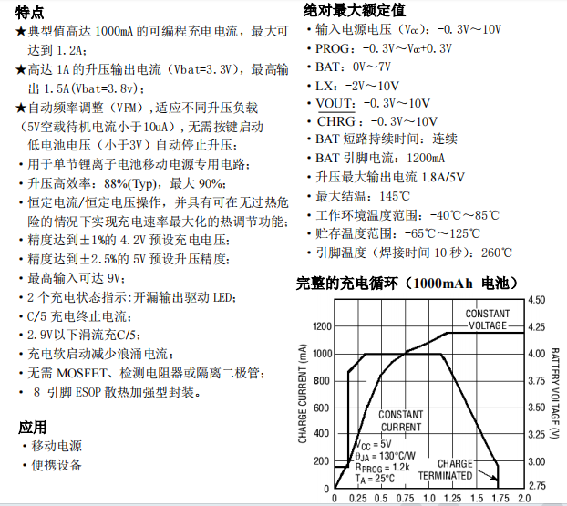

; 2- Charging and boosting to 5V via TP5400. Why boost? Because the WS2812 power supply must be above 3.6V.
3- The LDO uses a TLV74333 to 3.3V converter because the MCU power supply cannot exceed 3.6V.
4- USB insertion detection: input is present when pin PB12 is high.
5- Lithium battery directly connected via 2.54mm header pins.
6- SW1 switch controls whether the lithium battery is powered.
TP5400

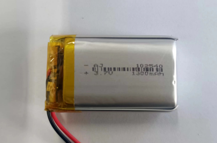

lithium battery specifications
need to be purchased from Taobao, 1300mAh, as follows:

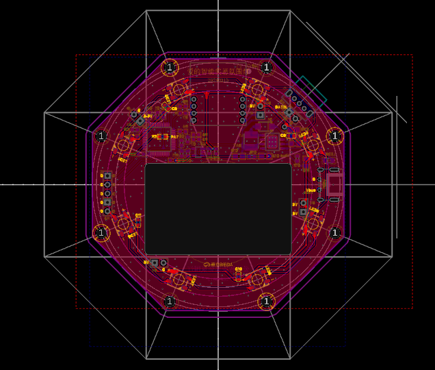

PCB Design:
Designed using LCSC EDA. Double-layer board, 1.6mm, FR-4 board material. The 76x76mm

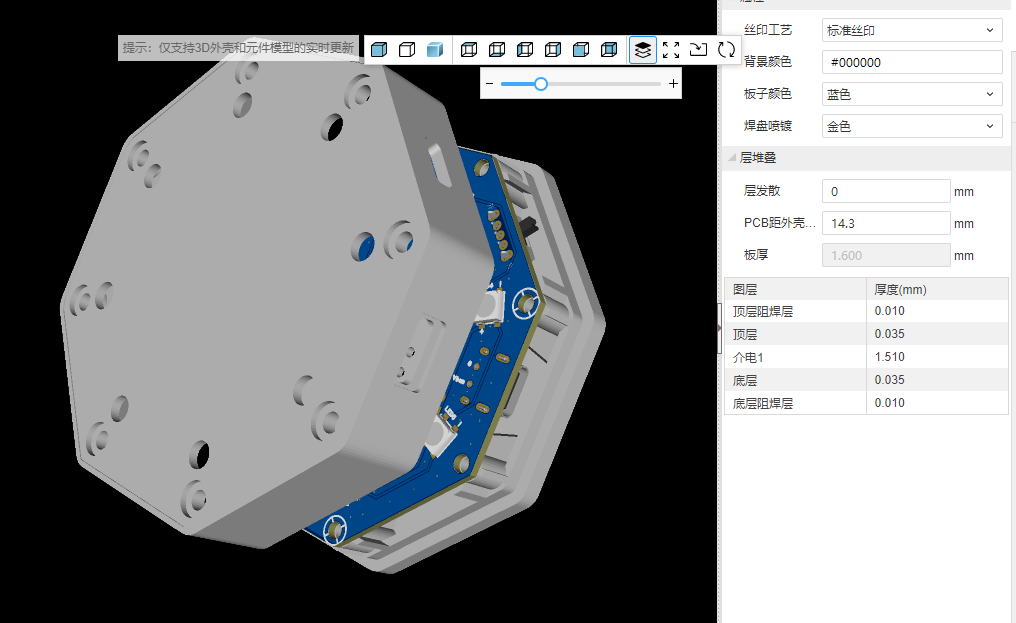

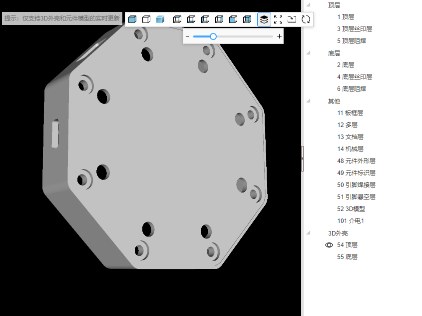

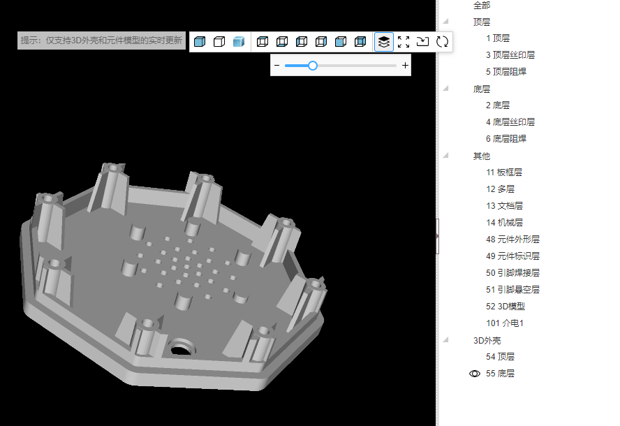

3D shell design
was done using LCSC EDA.
Bottom cover:
Top cover:

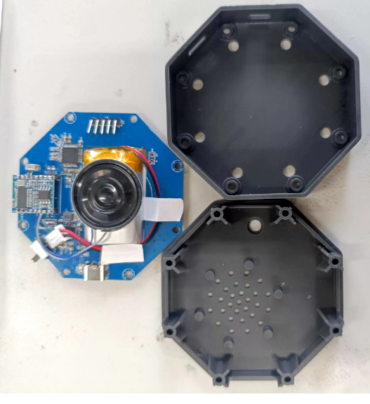

Actual product image .

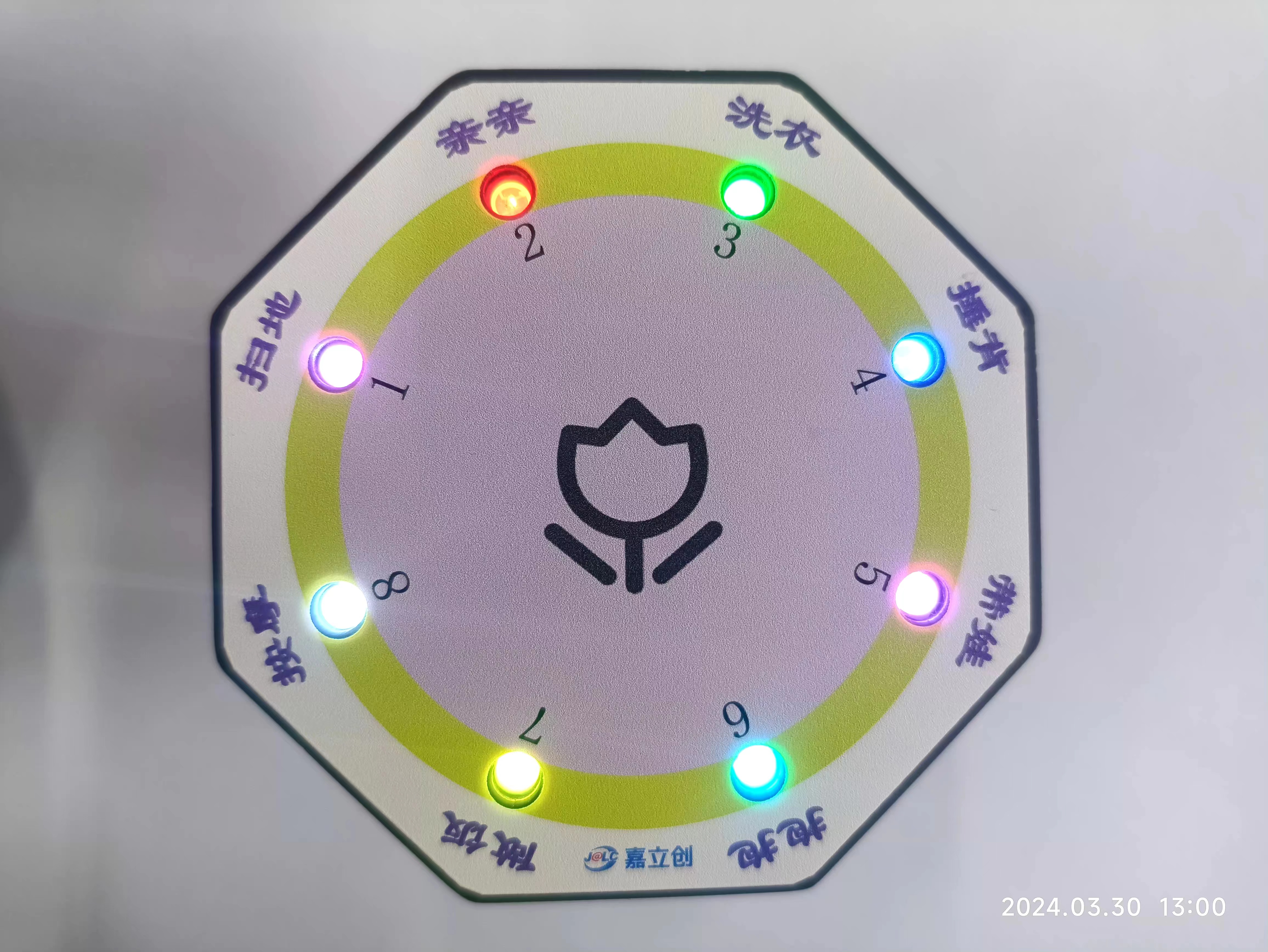

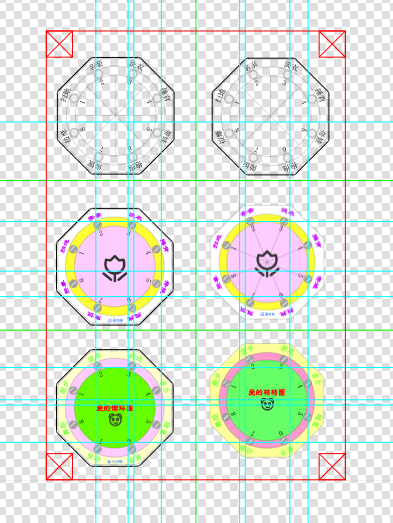

Panel design
was also done using LCSC EDA . Actual
product shown below:

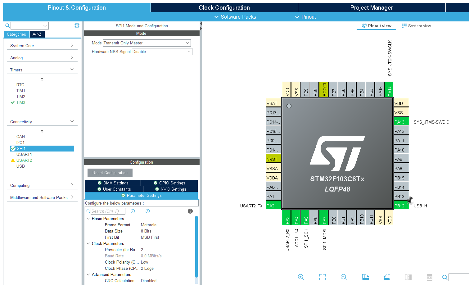

used a combination of CubeMX and Keil5, developed using C language.
CubeMX configuration is as follows:
