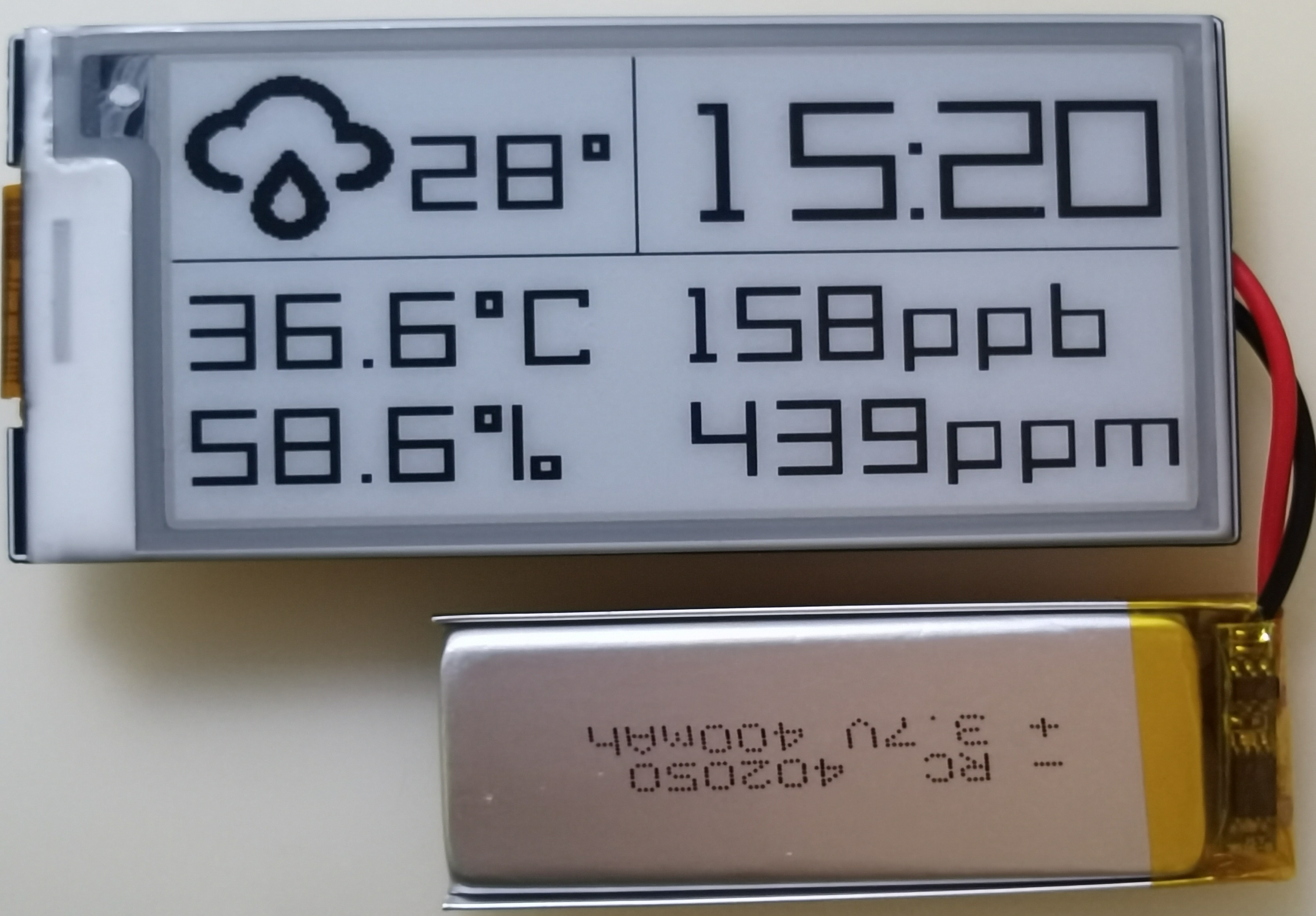

1. Project Function Introduction:
This competition required the creation of a temperature and humidity (SHT40 sensor) detector. The official version uses a digital tube display. I thought I could add an e-ink screen to create a low-power detector. Since I was using an e-ink screen, I decided to replace the MCU with an ESP32 and add an SGP30 air quality sensor. This was the main idea behind the project.

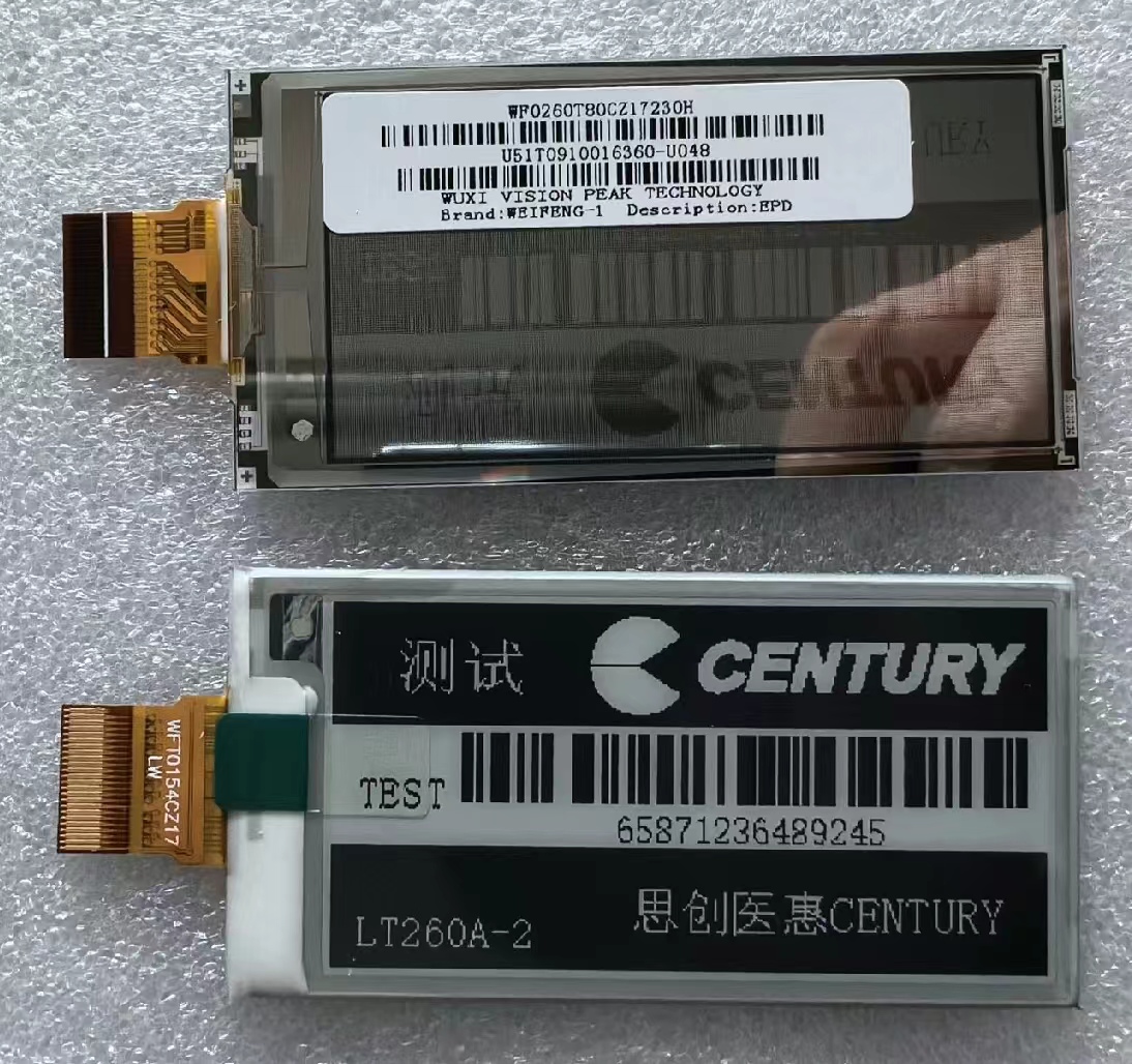

I purchased a 2.66-inch black and white e-ink screen on Xianyu (a second-hand marketplace). The seller said it was compatible with the GDEW026T0D from Jiaxian, so driver issues shouldn't be a problem.

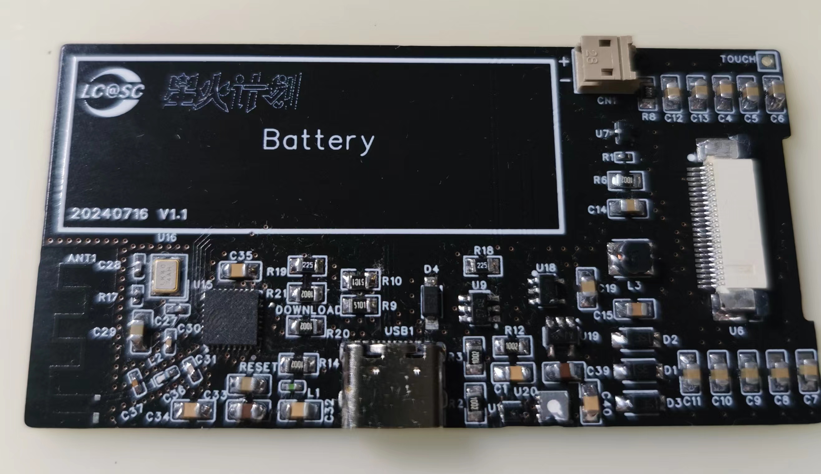

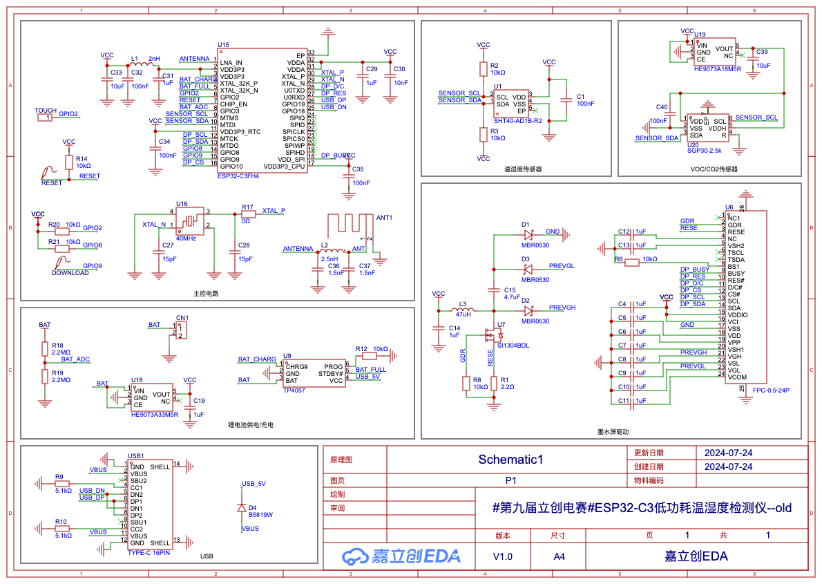

The first version used the ESP32-C3; although it has more peripheral circuitry, the chip is cheap enough. Below is the circuit diagram and PCB of the first version.
After soldering, the board couldn't recognize the chip. A careful check ruled out poor soldering and a faulty USB signal line. Due to a lack of tools, I couldn't check if the crystal oscillator and chip were working properly, so I had to abandon this solution.

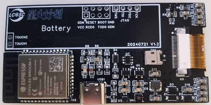

The second version is the final product. This version directly replaced the ESP32-C3 chip with an ESP32-S3 module to improve the success rate. After soldering the board, the chip was easily recognized, and the sensor could be read. OK, next is writing the program.

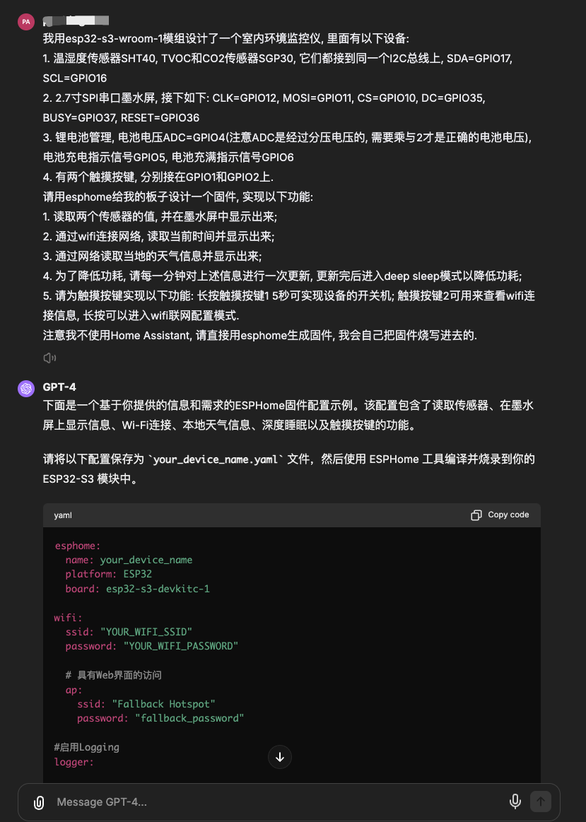

Of course, being extremely lazy, I didn't even want to write the ESPHome configuration file from scratch, so I had LLM write one for me. Below is the first version of the program written by GPT-4o (the complete program is in the attachment "temp-detector-gpt4o.yaml"):
GPT-4o's program basically implements the functions I described, except it can't provide the e-ink screen driver, which is understandable since I didn't provide it with more detailed information about the e-ink screen. Aside from not needing an e-ink screen, there are no other major problems, but there are quite a few minor ones, such as the `board` configuration causing compilation errors.
These minor problems are easy to fix; I modified the version based on GPT-4o. The final program is in the attachment "temp-detector.yaml," and "temp-detector.bin" is the compiled firmware. Note that you need to modify the Wi-Fi configuration to the corresponding Wi-Fi name and password.

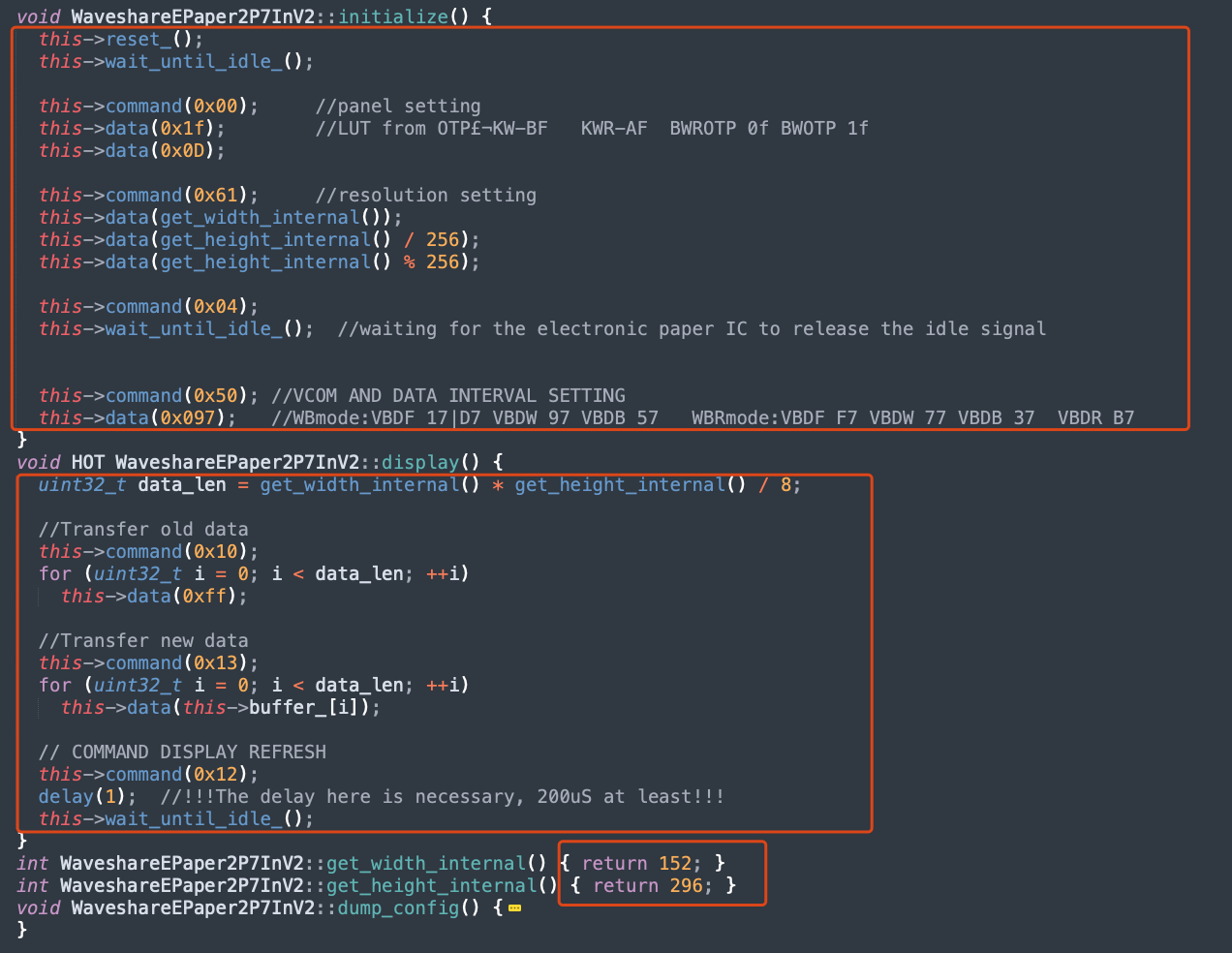

Initially, I wanted to use the Waveshare driver included in ESPHome, but none of the drivers for different screen sizes worked for my e-ink screen. After a day of troubleshooting, I finally got it working using the official GDEW026T0D driver from GAC Display.
Of course, the official GAC Display driver can't be directly used in ESPHome; it's not optimally compatible. Therefore, a porting process is necessary. There are two approaches: one is to directly modify the Waveshare driver within ESPHome, which is highly intrusive and not recommended; the other is to create a component of ESPHome from the GAC Display driver.
To quickly implement the functionality, I modified the Waveshare driver first and then created a component later. The specific repair method is as follows:

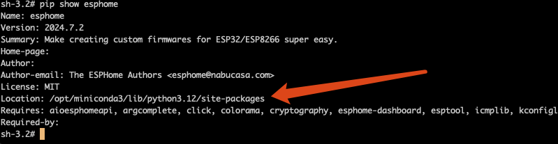

Use the command `pip show esphome` to find the ESPHome installation path. My installation path is /opt/miniconda3/lib/python3.12/site-packages.
Then, open the file /opt/miniconda3/lib/python3.12/site-packages/esphome/components/waveshare_epaper/waveshare_epaper.cpp in this path and modify it. I'm modifying the 2.70inv2 driver, which corresponds to the class WaveshareEPaper2P7InV2. Four functions need to be modified: first, modify get_width_internal and get_height_internal to the screen resolution; then modify the initialize function; and finally, modify the display function.
The modified waveshare_epaper.cpp file is attached.

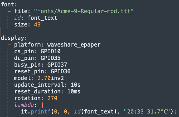

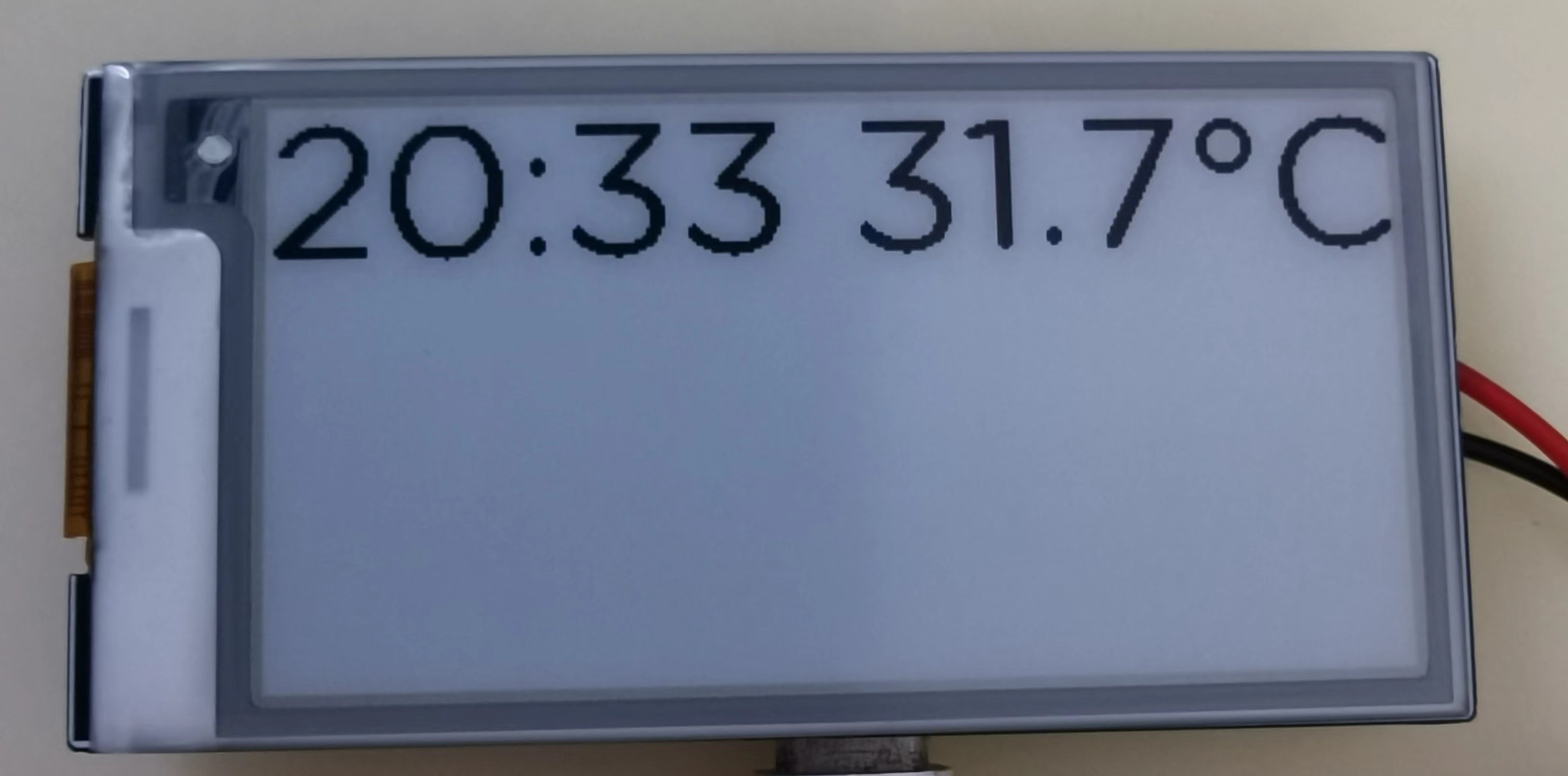

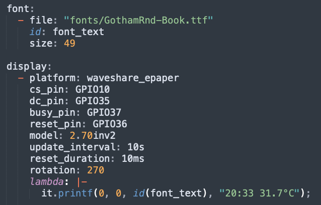

For the interface design of the e-ink screen, the first step is to find a suitable font. The following code uses the GothamRnd-Book.ttf font to display the text "20:33 31.7°C" at coordinates (0,0). The display effect is unsatisfactory; the text edges are not smooth, and the graininess is quite strong. The main reason is the low grayscale, and it is also related to the low DPI of the e-ink screen.

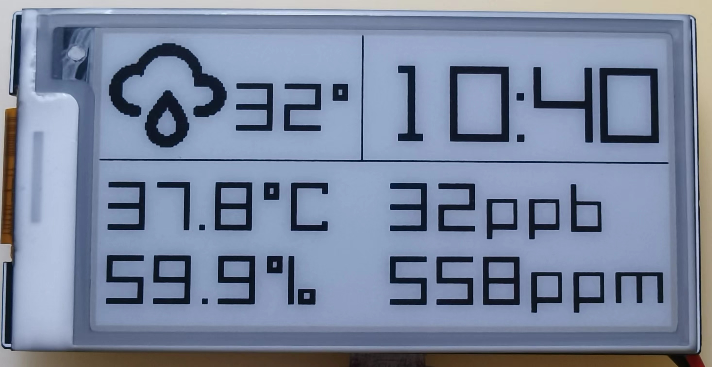

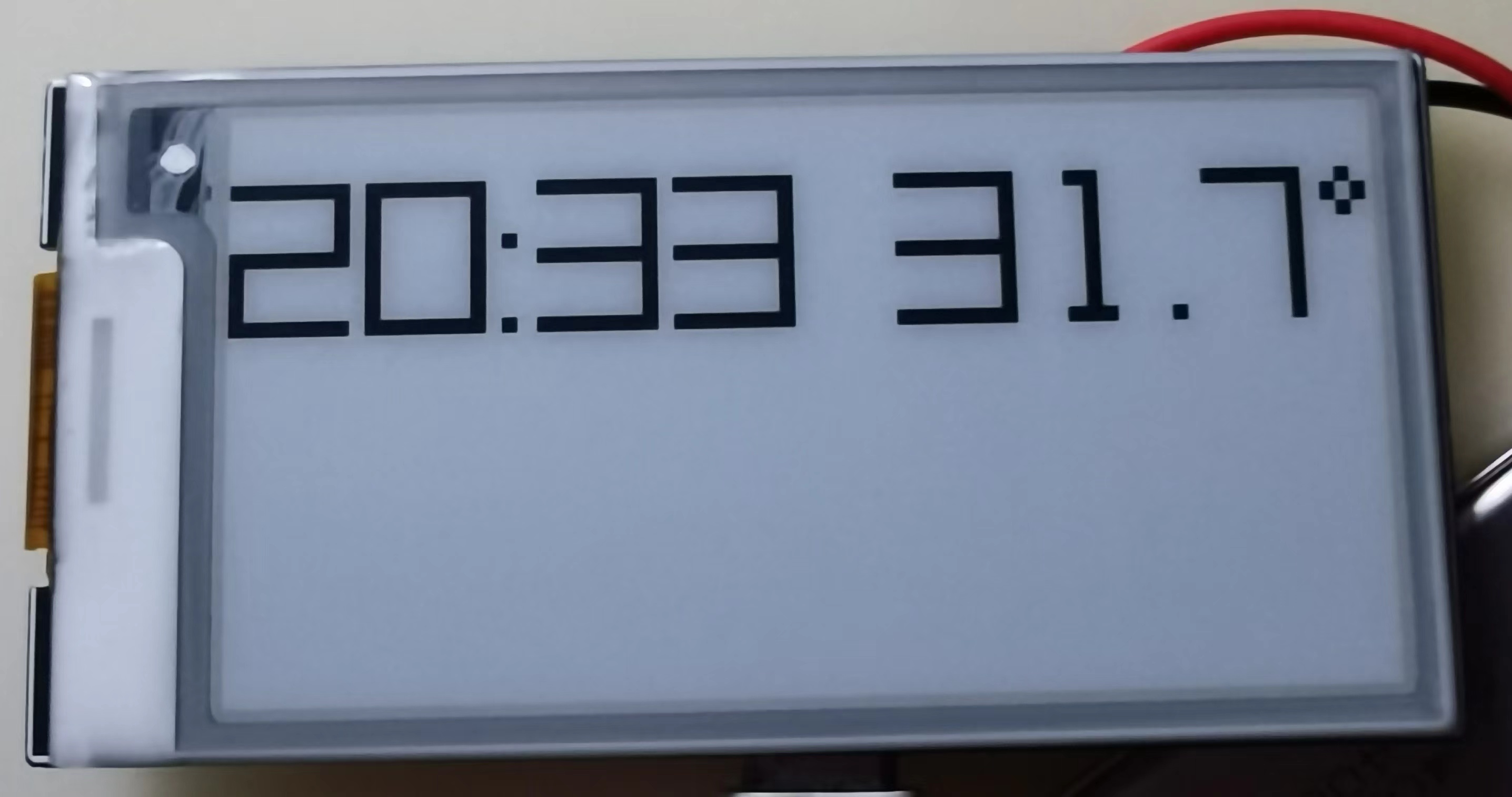

So what kind of font is suitable for display on an e-ink screen? Obviously, fonts without bevels and with straight lines should display very well. So I spent a morning looking at about 1,000 pixel-style fonts, and after testing about ten fonts, I chose the Acme-9-Regular font. The display effect is as follows:
The text display effect is much smoother and cleaner.
Note: I made an adjustment to the original Acme-9-Regular font, please see the appendix for details.

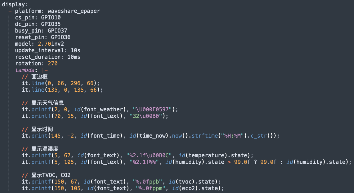

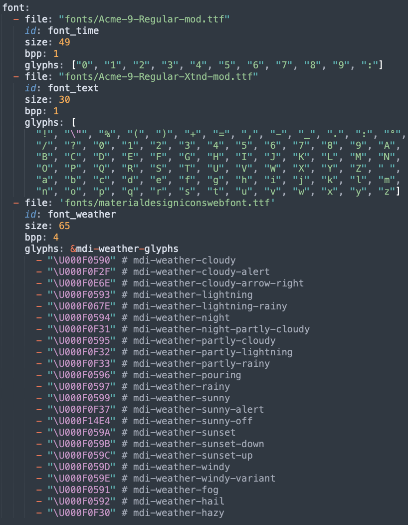

After selecting the font, the interface design became easier. I divided the screen into three areas: the upper left corner for weather information (this part is currently hardcoded and will be integrated with the weather interface later), the upper right corner for the time, and the bottom for the temperature, humidity, TVOC, and CO2 values. The code and effect are as follows:
The glyphs in the font configuration specifies the characters to be used, which can reduce the firmware size. The font files used are attached.

6. Competition Logo Verification

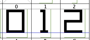

1) Modification of Acme 9 Regular.ttf :

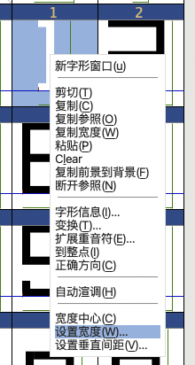

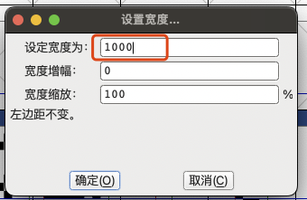

This font only needs one modification, which is to change the number 1 to a fixed width. The left side of the image below shows the data 1 before modification. Its width is smaller than the other numbers. This causes the displayed time information to shrink to the left when it includes the number 1, because the number 1 is smaller than the others. If the width of the number 1 is the same as the other numbers, this problem doesn't exist. The right side of the image below shows the number 1 after modification.
The modification method is to right-click the number 1 and select "Set Width":
In the pop-up window, enter 1000 and click OK:

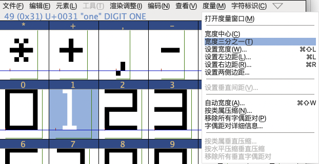

After setting the width, the number 1 is too far to the left, so you need to adjust the left margin.
Select the number 1, then select the menu "Measure" and then "Width One-Third":
Set the number 1 as follows:

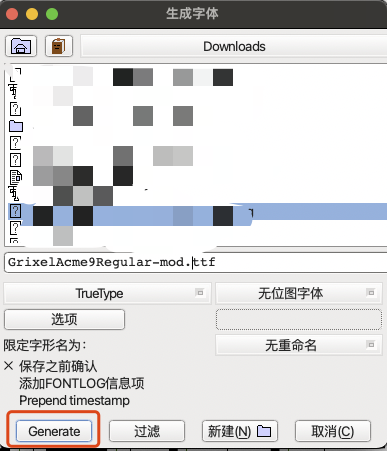

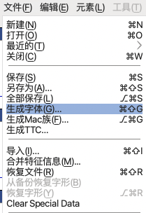

Export the font settings. Click the "File" menu, select "Generate Font":
Enter the file name, click "Generate," ignore the warning window that pops up, and click as shown in the screenshot below to successfully export the font file.
