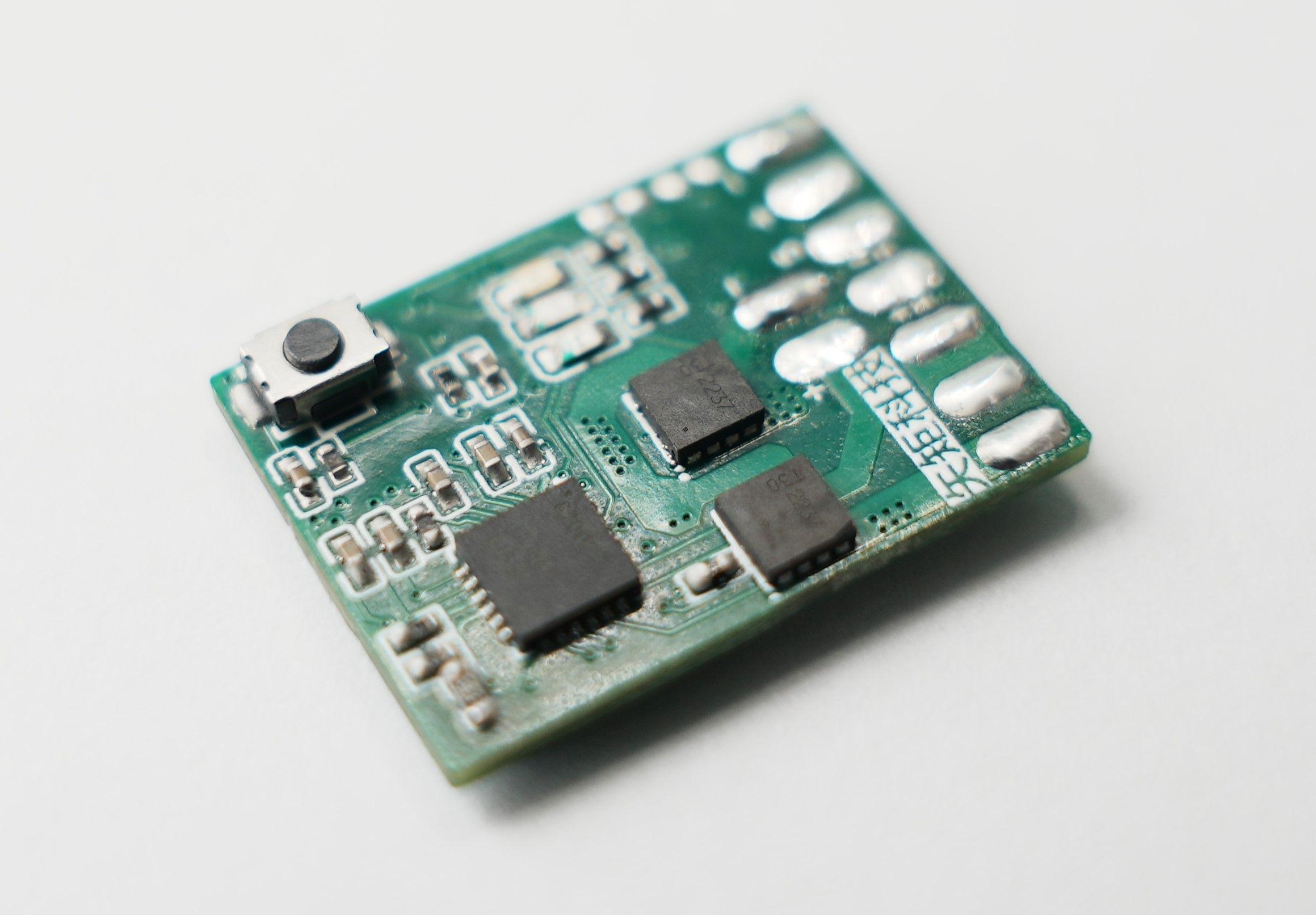

Mini high linearity brushed ESC for RC model applications
Introduction Link: https://www.bilibili.com/video/BV1wf421f7qL/?vd_source=0932b066ad5079c0e33d7684bbc536be
1. Product Introduction:
A brushed ESC for RC model applications. Key features include: compact size, high power, and high linearity at low speeds.
2. Application Scenarios:
2-3S power supply RC car brushed motor drive, or other brushed motors that meet 2-3S voltage requirements and, with heat dissipation, can achieve a continuous current of 10A and a peak current of up to 30A.
3. Product Overview:
This project mainly designs brushed motors for RC models, especially small-scale cars and drift cars where ESC size is critical. Unlike the integrated H-bridge drive used in ordinary brushed ESCs, this project benefits from a discrete high-performance H-bridge gate-level drive and compact MOS packaging design. The driver board achieves a certain continuous power output capability with high low-speed linearity and stable output while maintaining a small size. It also features built-in low-voltage battery protection, driver board temperature monitoring, and start-up point adjustment.
4. Product Parameters:
Size: 16mm x 22mm x 8mm, meeting the space requirements of small-scale mosquito car models
. Main Controller: STM32G030F6P6, 64MHz.
Power Supply: 2-3S polymer lithium battery.
BEC: 5V 3A BEC power supply capability
. Drive Capability: 4A continuously without heat dissipation, 10A continuously with heat dissipation, peak 30A.
Programming Interface: SWD.
Production Cost: Approximately 10-15 RMB.
PCB Parameters: 16X22mm, four-layer board, components on both sides.
Functional Modes: Forward/Reverse/Brake, two operating modes: normal mode and single-pedal mode.

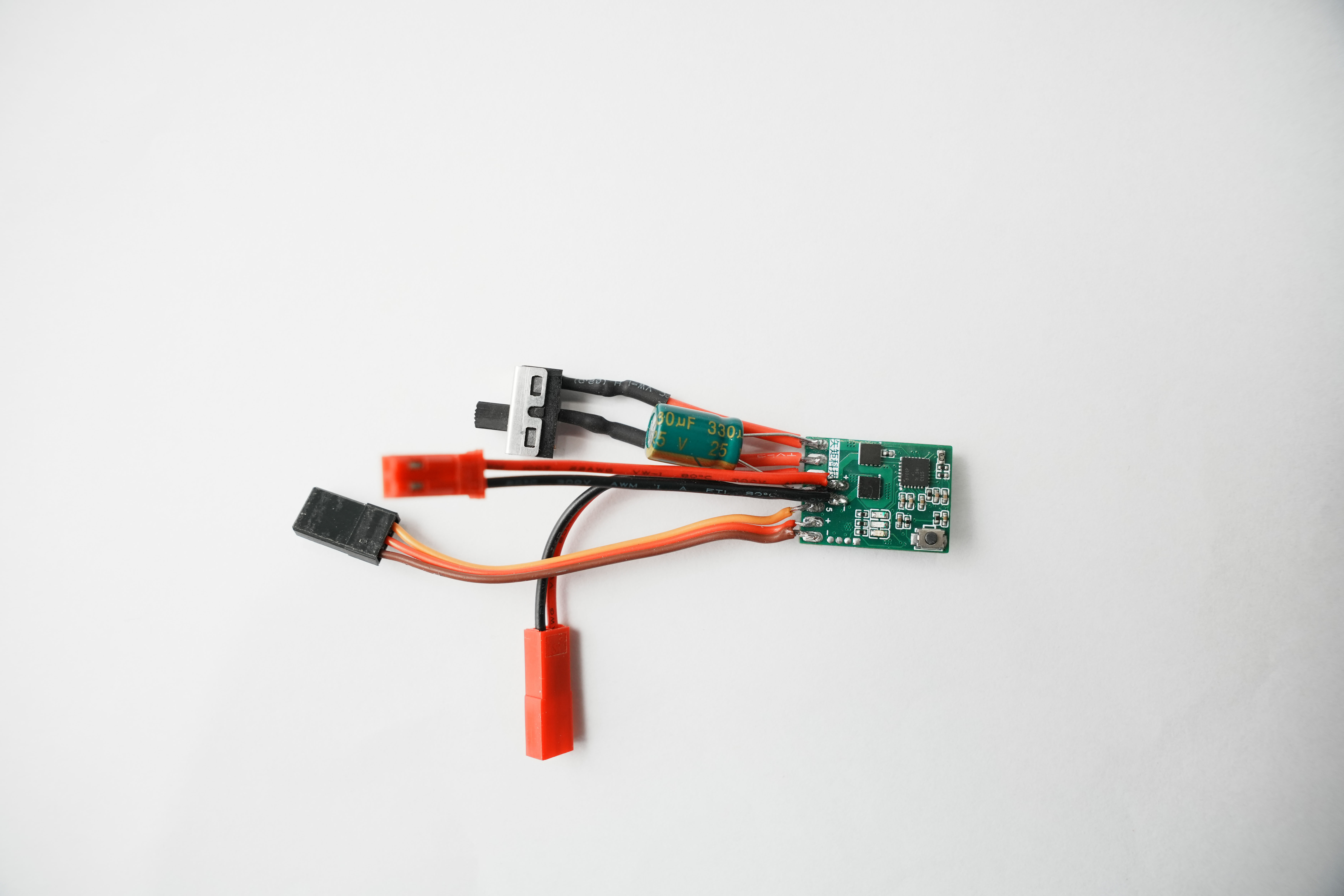

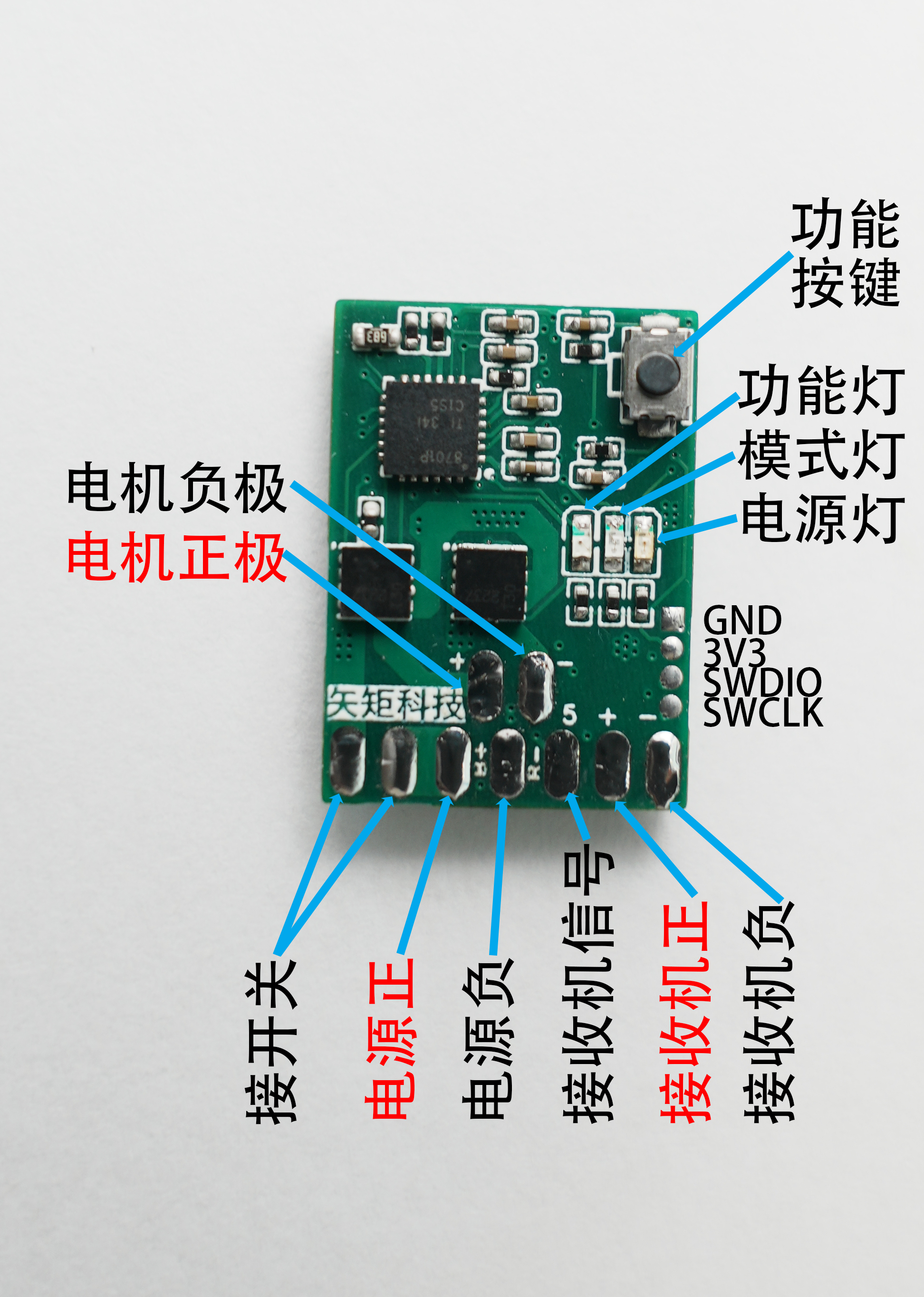

In addition to the finished PCB, you will need to prepare corresponding connectors (JST male/female connectors shown in the diagram), a receiver 3P connector, a 33uf 25V electrolytic capacitor, and a switch (SS12D10 straight-leg switch shown in the diagram) according to the battery and motor connectors.
Solder the wires as shown in the diagram below. For the electrolytic capacitor (note the difference between positive and negative pins), solder the negative pin to the negative power supply pin and the positive pin to the left-side switch pin.
The finished product should look like the image below .
The function buttons have the following functions:
A short press switches between two operating modes, and the function light flashes once;
a short press sets the battery to 2 seconds, and the function light flashes twice;
a short press sets the battery to 3 seconds, and the function light flashes three times;
a short press followed by four flashes of the function light, then a power outage and restart restores all default settings;
a long press for 2-4 seconds and release sets the throttle start point, and the function light flashes five times;
a long press for more than 5 seconds until the function light starts to illuminate, then release and the function light flashes six times, setting the throttle midpoint.
All function settings are saved after a power outage and only need to be set once.

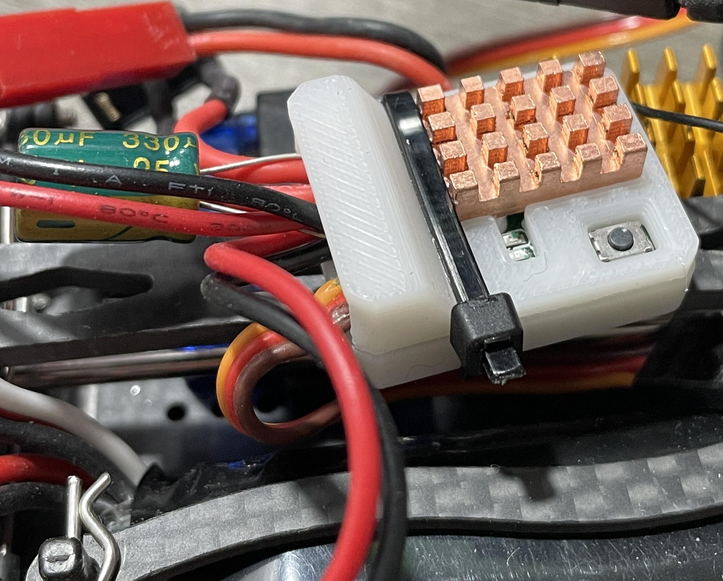

(8) For motors used in small scale 1/24 or 1/28 mosquito car cars, there is no problem in using them directly without adding heat dissipation; For high-power motors with a continuous current of more than 4A, a heat sink needs to be added to the MOSFET. It is recommended to use a 10x14mm long and wide heat sink to attach to the MOSFET. You can use the 3D printed parts in the attachment to install it as shown in the figure below. After adding the heat sink, it can output 10A continuously.
Firmware V1.0.rar
For heat dissipation, this casing can be printed. (zip file)

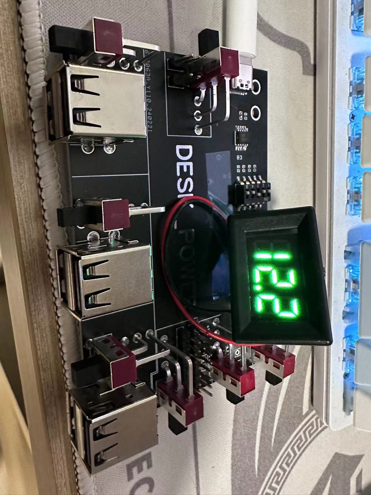

PD desktop power supply with random voltage output (for children's entertainment)
Each port on the board outputs a voltage randomly, ranging from 0 to 15V. The probability of not burning out the USB port is as high as one in four! Surely no one would keep switching between phones until the very last one before it burns out!
Each port on the board outputs a random voltage, ranging from 0-15V, and the probability of not burning out the USB port is as high as one in four! Surely no one would try to replace it with every last phone before it burns out, right? This is a special April Fool's Day offer!
 For entertainment purposes only!
