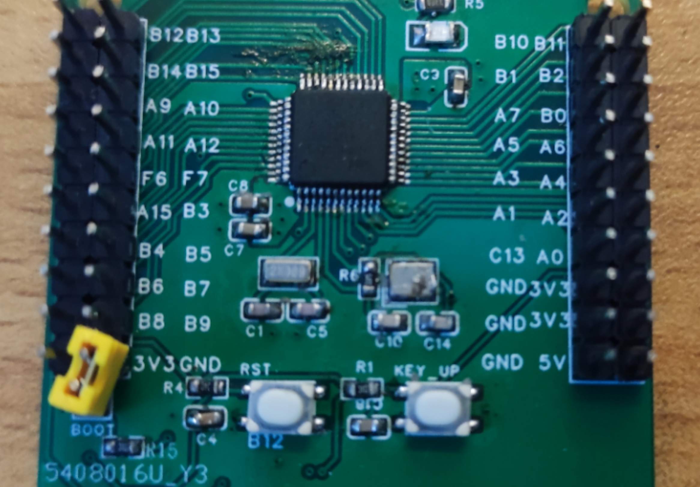

GD32E230 core board
The GD32E230 core board
has DAPLINK download ports (PA13 and PA14). Note: If these two pins are already used in the project, subsequent simulation downloads will fail; serial downloads will be required.
The board is relatively simple and will not be described in detail. It has been tested and works normally.
