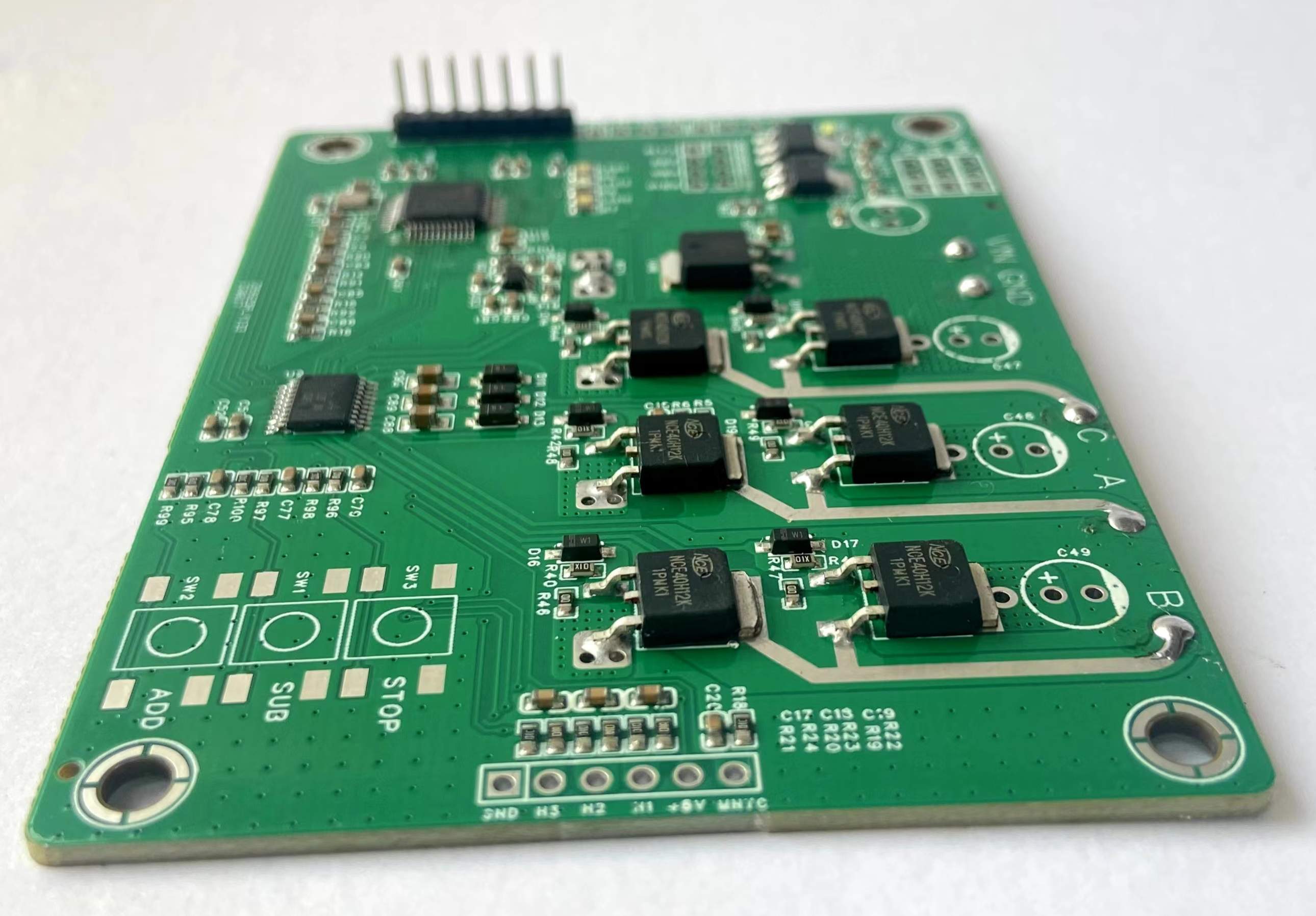

Benjamin ESC FOC-VESC410
Benjamin VESC410 Brushless Motor Controller
※Disclaimer※
1. This project is for the Benjamin VESC410 firmware; the hardware is DIY, and defects may exist in the hardware or firmware. Users assume all risks.
2. Users bear all losses, including property damage and personal injury, incurred during the use of this project.
3. This project may not be used for any form of commercial activity without permission, including but not limited to selling project materials or manufacturing and selling circuit boards. For commercial cooperation, please contact me.
※Copyright Notice※
1. The software and host computer for this project are provided by Benjamin Vedder's VESC® Project.
2. The schematic diagram of this project references the VESC410 schematic diagram. The PCBA was DIY-built by me, and the schematic and PCB were drawn using JLCPCB EDA.
※Project Features※

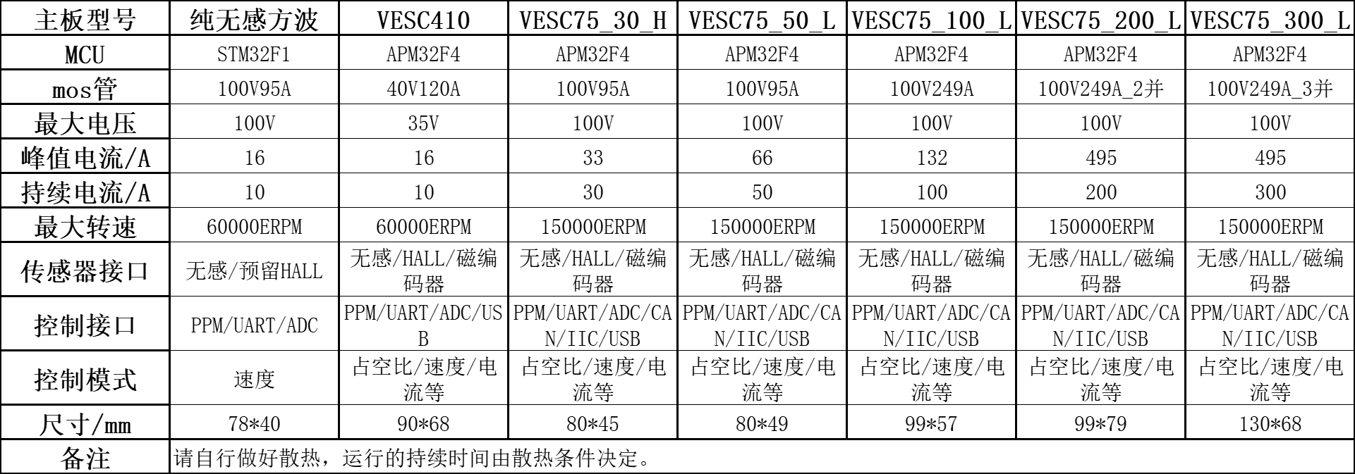

1. MOS: 40V 120A
2. Maximum Input Voltage: 35V
3. Continuous Current: 10A, Peak Current: 16A
4. Maximum Speed: 60000 ERPM
5. Control Interface: Sensorless/HALL/Magnetic Encoder
6. Control Mode: Duty Cycle/Speed/Current
7. Circuit Board Size: 90*68mm
8. Dual Resistor Sampling
※Open Source Resources※
Gerber files, coordinate files, BOM, firmware, 2D and 3D silkscreen drawings, and host computer software are provided.
Download from QQ group 105896054 or the Benjamin official website.
