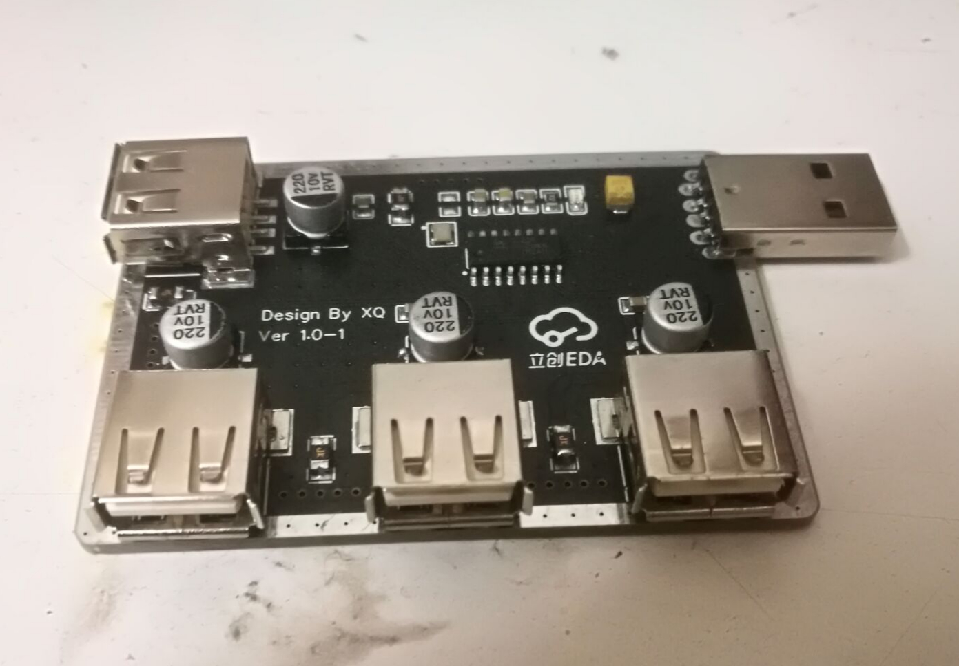

[Successful test] USB-HUB docking station based on SL2.1A
  1. 1 USB-A input, 4 USB-A outputs (don’t ask why you don’t use Micro or Type-C, you just don’t want to use them)
  2. Each output has a 6V2A resettable fuse (not included in the input/IC part)
  3. The input/output is equipped with capacitor filtering (there are a lot of capacitors, which are useless if not used)
  4. R2 determines internal or external crystal oscillator
log
I haven’t written the previous log, so I’ll ignore it for now. I received the PCB today and completed the welding. After powering on, I can install the driver. I will conduct a speed test when I have time.QQ screenshot 20200508140655.pngQQ picture 20200508140016.jpg
2020-5-9
Conducted speed testQQ picture 20200509143821.pngQQ picture 20200509135136.pngQQ picture 20200509142937.png
