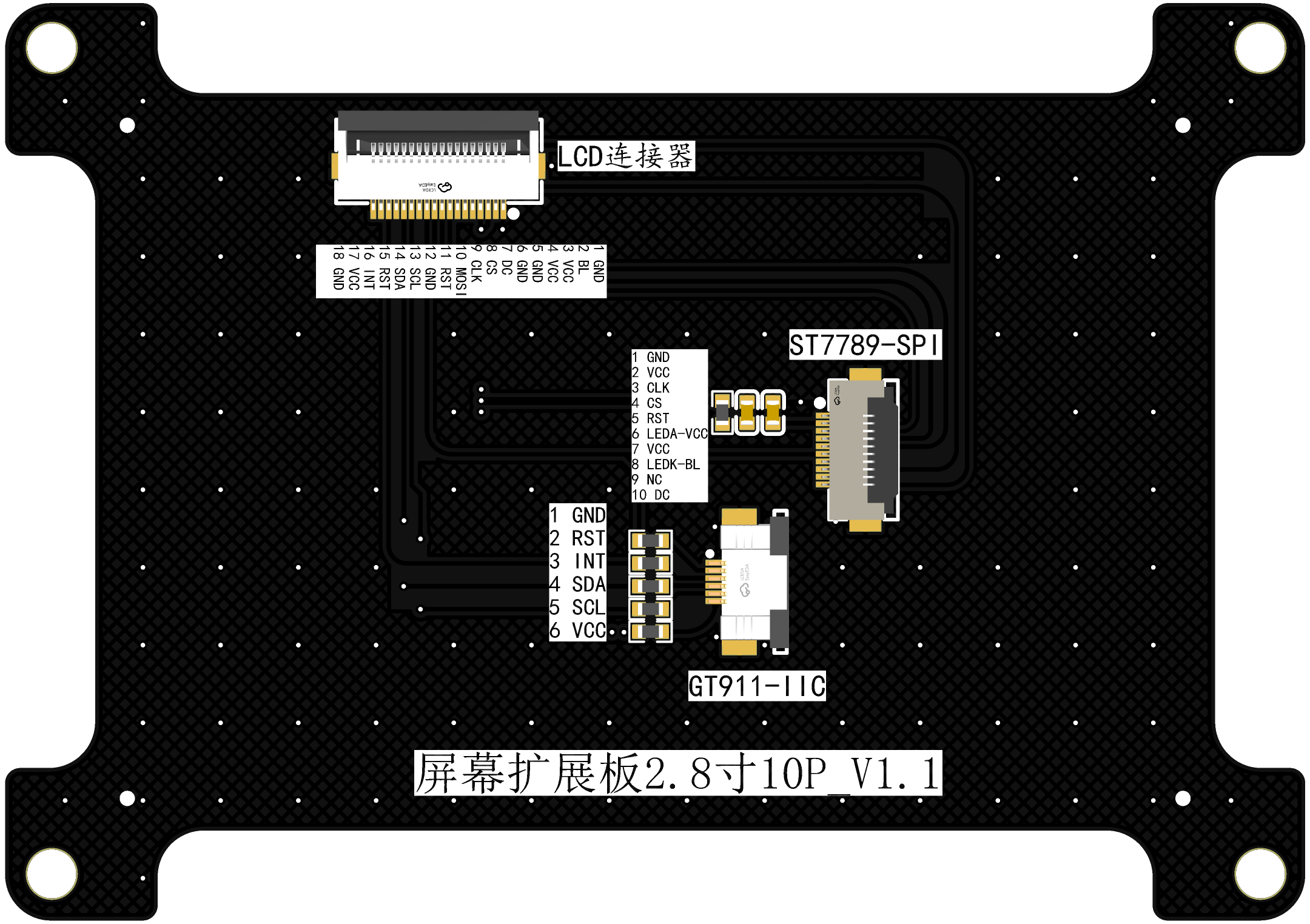

Version Name: 01-RTC Screen Expansion Board V1.1
Update Time: 2023/11/16
Update Content:
The position of the FPC has been slightly adjusted for easier connection.
Zero-resistance wires have been added to important lines for easier maintenance and debugging.
Silkscreen printing has been optimized.

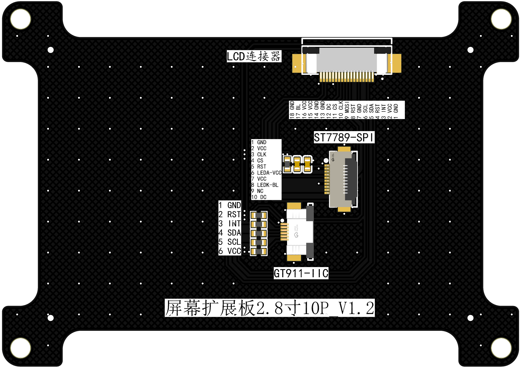

Version Name: Screen Expansion Board 2.8-inch 10P_V1.1, Screen Expansion Board 2.8-inch 10P_V1.2
Update Time: January 26, 2024
Update:
Optimized version naming;
Added version - Screen Expansion Board 2.8-inch 10P_V1.2.

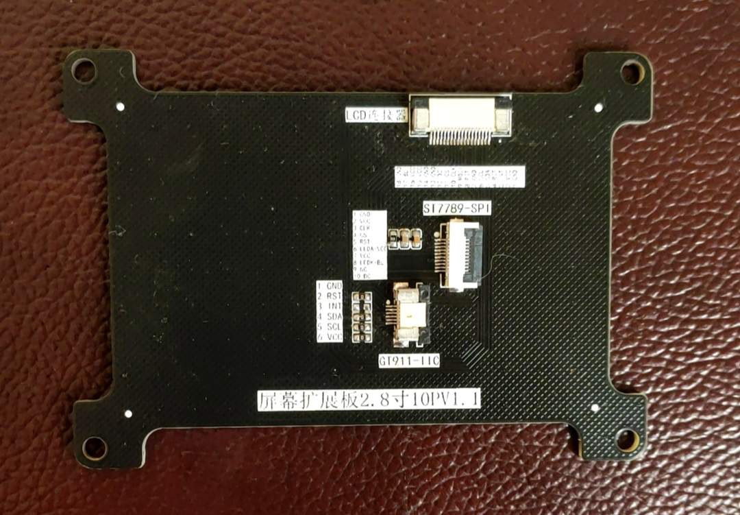

Version V1.1 is placed on top of the 01-RTC motherboard, and version V1.2 is placed on the bottom of the 01-RTC motherboard.
Please pay attention to the wiring sequence when connecting, and pay attention to the top and bottom connections of the FPC connector. I myself reversed it several times!

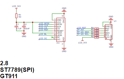

1. Connector:
For compatibility, this connector is the same as the 1.69-inch touchscreen interface on the 01-RTC motherboard. On the screen expansion board, this interface serves as the connector for the touchscreen lead on the screen expansion board.
2. Screen and Touch Interface:
The screen uses an SPI interface, and the touch uses an IIC interface.
