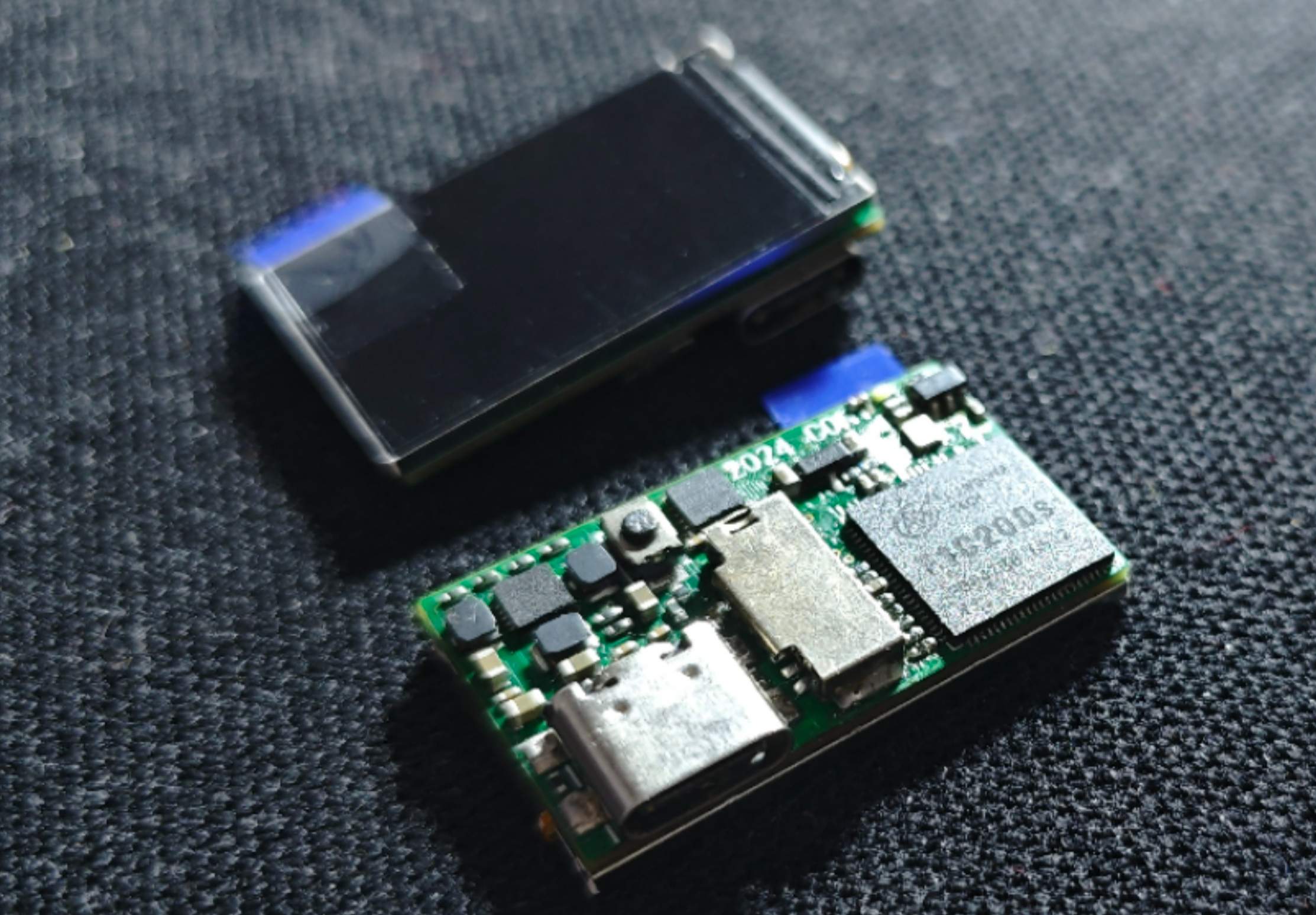

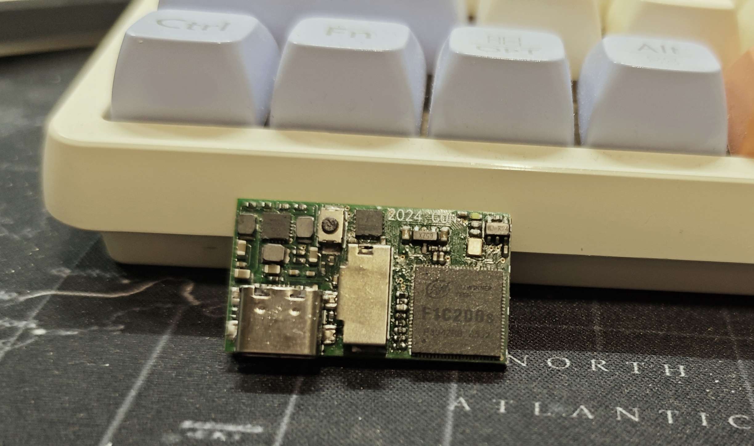

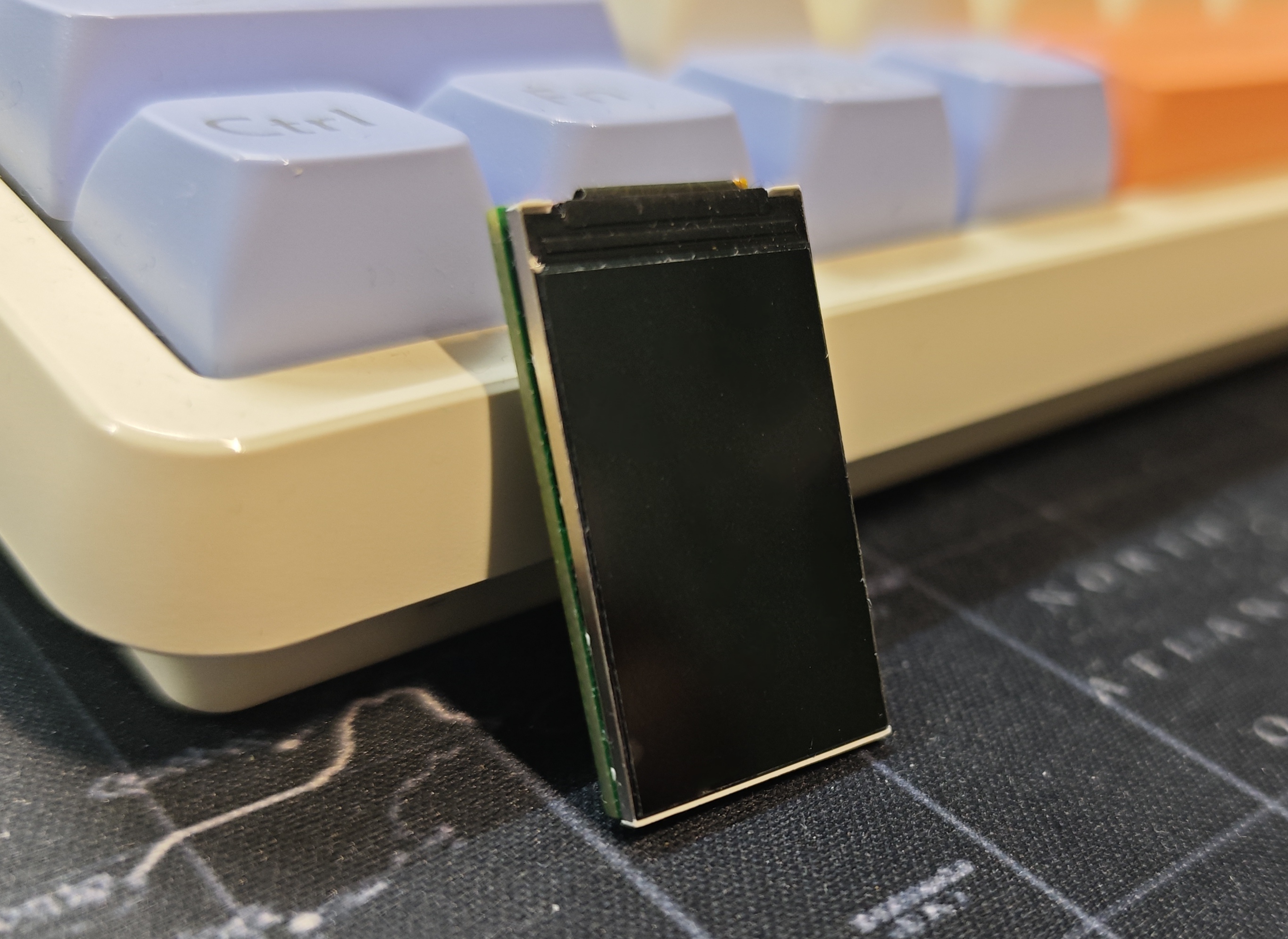

This finger-sized terminal, based on the F1C200S, can be controlled via serial port and features a 1.14-inch screen and a programmable 0402 LED.
Soldering precautions:
Due to the small size of the power chip and serial port chip, it is recommended to solder the pads first before soldering the chips;
use large capacitors near the power supply interface (I personally use 22uf);
the CH343P is very close to a capacitor, so solder carefully to prevent short circuits;
the RC package is small (0402), so soldering requires care.
