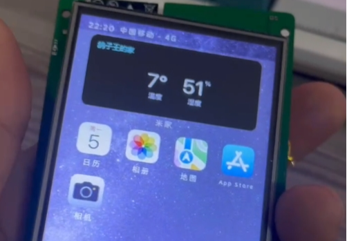

The main interface is built using LVGL, which facilitates later function expansion and maintenance.
It can make and receive calls
and send and receive text messages.

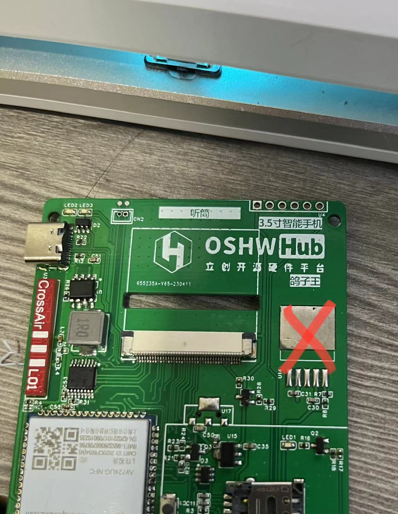

PCB design is completed, and the connection is verified using the core board and adapter board. Awaiting PCB prototyping.
PCB prototyping has been completed, and the delivery date is shown as 4/13. PCB is awaiting receipt. Component procurement

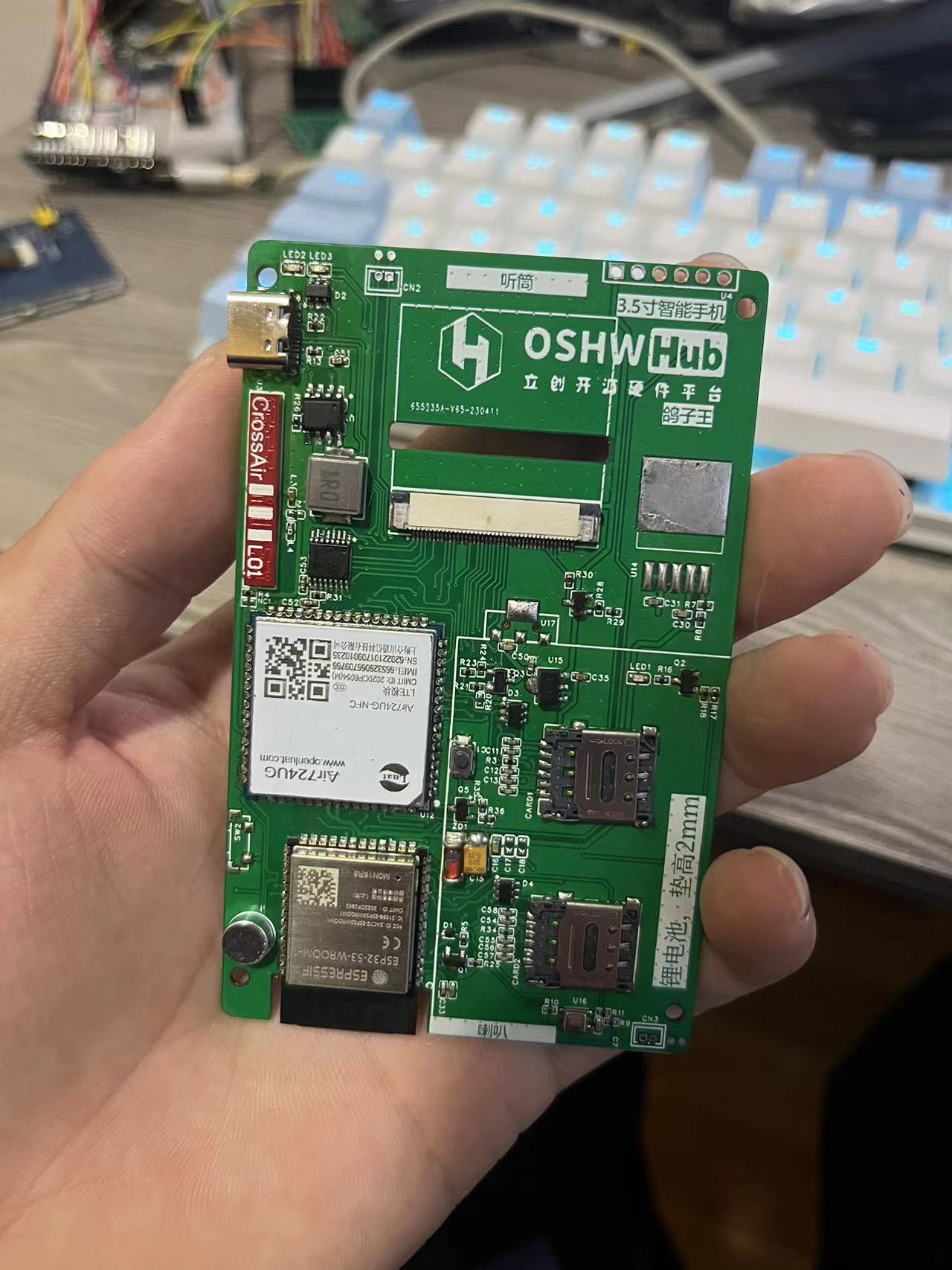

PCB has arrived, and hand soldering of components
is complete . Firmware is complete.
UI design and
4G communication debugging are complete.
All projects are completed and released. The project
continues to check for missing components and supplement procurement.

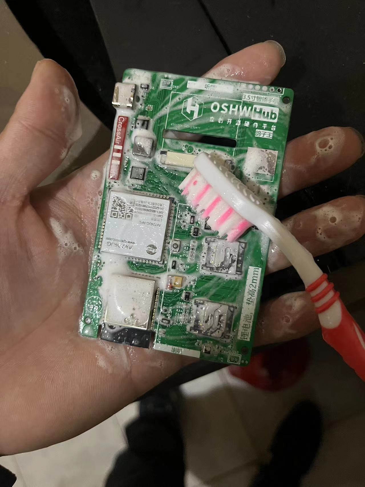

After hand soldering, the PCB is cleaned. Actually, I think using hand soap is better than board cleaning water. After washing and drying, the PCB smells nice.
