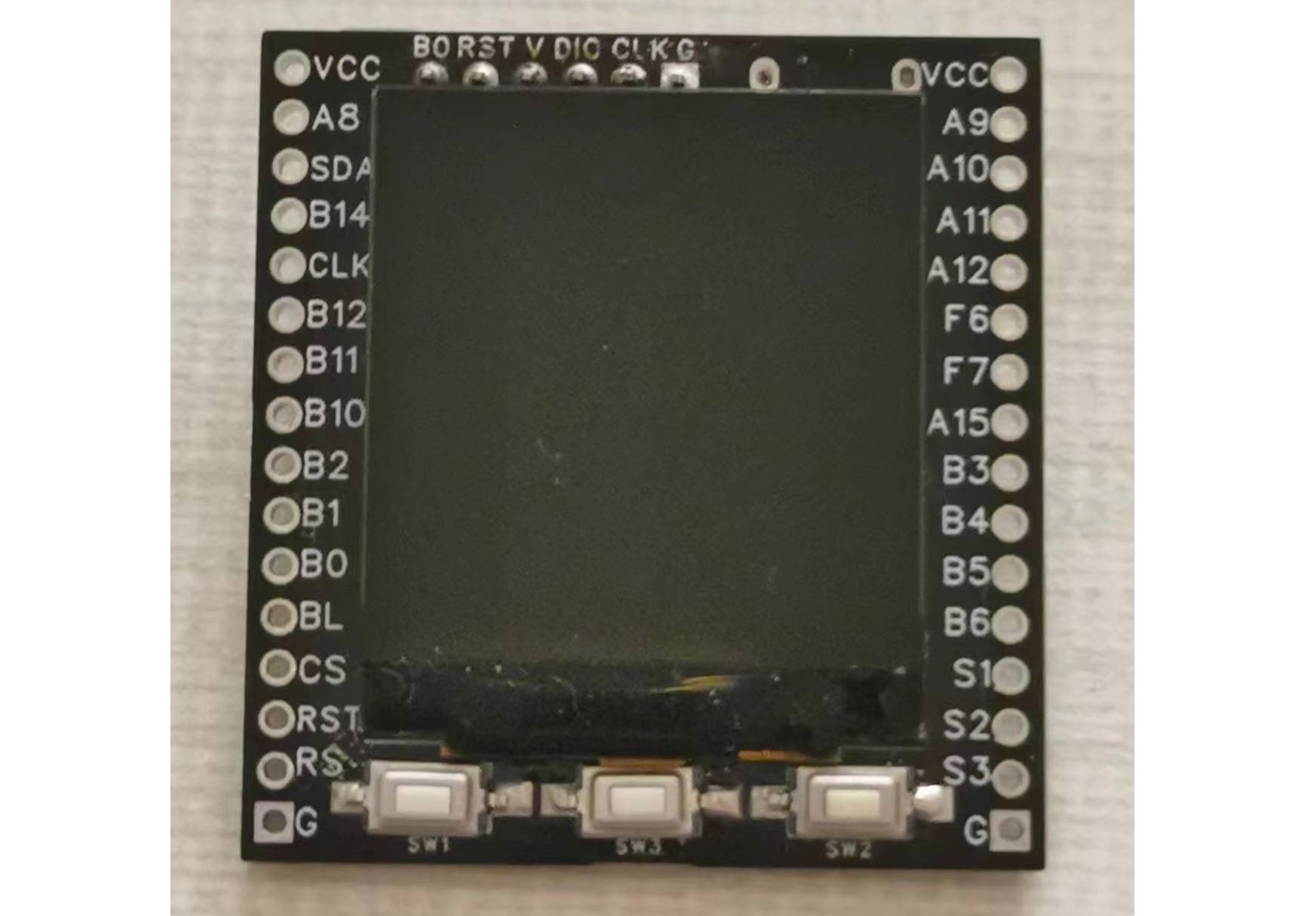

I. Project Description:
    The screen is a 1.44-inch LCD with a narrow bezel and small size, making it suitable for DIY projects. Its main advantage is its low price, costing only 5 yuan per screen. The downside is that this screen is soldered and cannot be easily disassembled, but this saves on the cost and space of component sockets. The screen driver chip is the NV3023A, a relatively uncommon model, but sample code is provided here for easy driver implementation and porting.
    As an STM32F030C8T6 core board, it also features full I/O pinout and provides a FLASH chip location (model W25QXX). Sample code is also provided in the project folder, though not added to the project project itself. The code is already ported and includes a FATFS file system.
