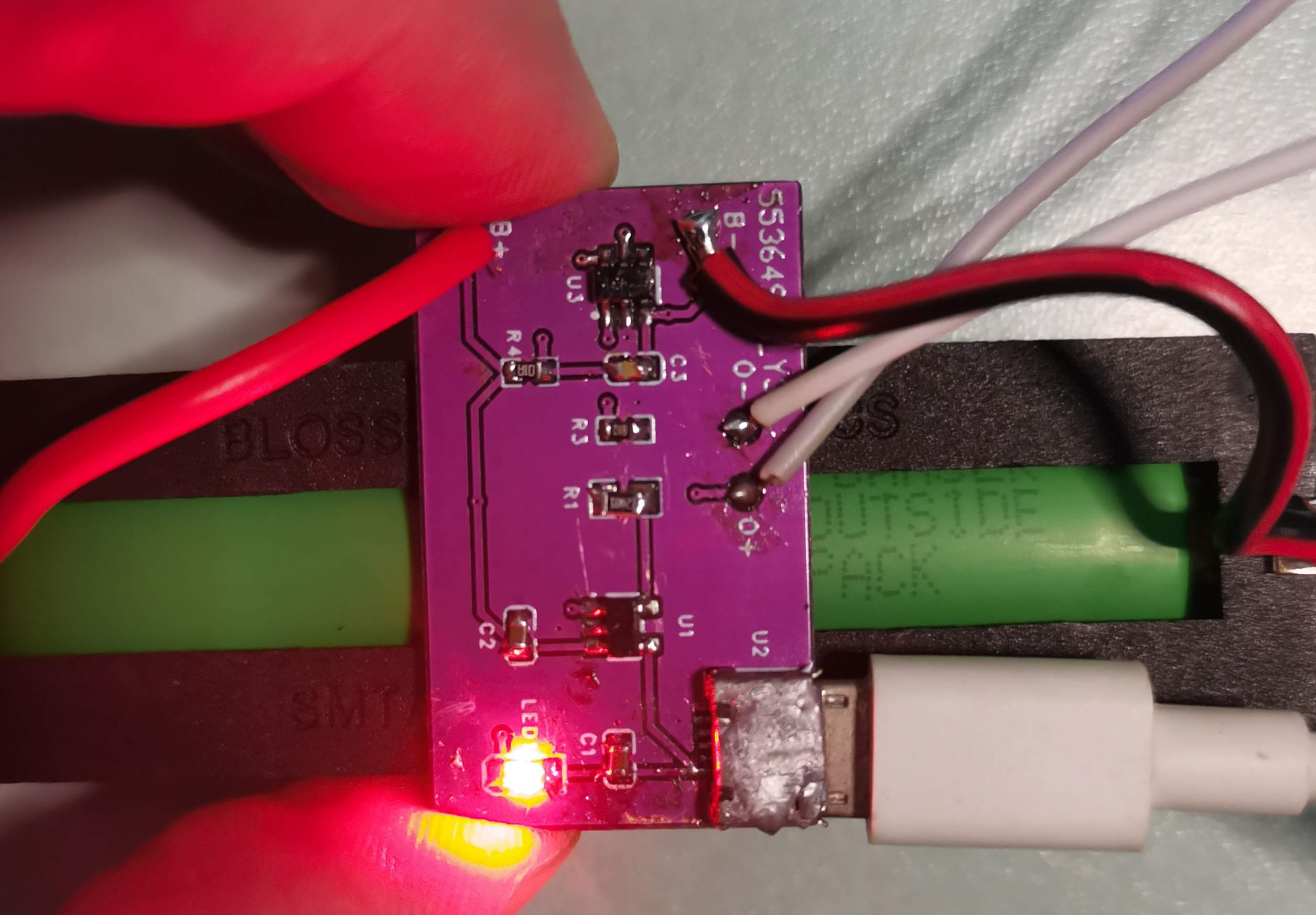

Charge and discharge protection board (4054+DW06D)
Typical application circuit of DW06D.
This design mainly refers to these two circuits. For details, please refer to the corresponding datasheet.
The welder is not very good. The attached picture shows that
everything is normal during the proofing test. It can output while charging;
the light turns on when charging, and turns off when fully charged.
B+ B- is the positive and negative terminals of the battery
OUT+ OUT- is the positive and negative terminals of the output
