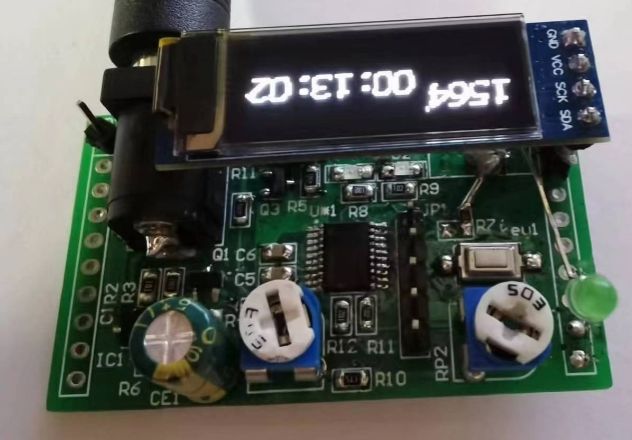

First, regarding the power supply, the adapter for the aquarium light I bought previously was a 21V output, so a step-down circuit was needed. I made a simple step-down circuit using a TL431 and SS8050, which should work with most common 5-25V adapters used in homes.
Secondly, as a PWM dimming board, the PWM control circuit is essential
. I added two potentiometers, a tactile switch, and two LEDs for control and interaction. Each pin of the chip is also connected to a header for connecting external modules, such as the OLED module shown in the initial screenshot.
Note: 1. The two GND pins at the DC input connector on the PCB need to be connected with jumpers. Some of my DC005 chips have these two pins connected to GND, while others do not.
2. Attached is a simple PWM timed dimming program source code.
