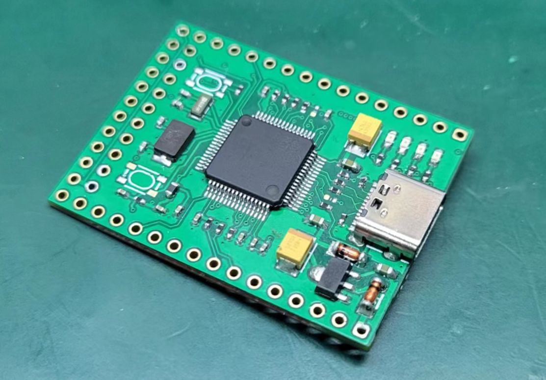

Design the Pyboard v1.0 board to your liking for ease of use.

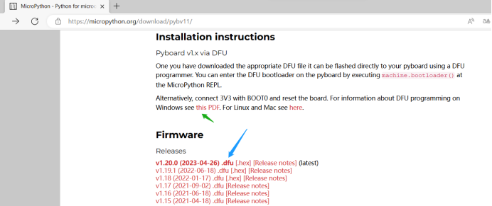

  . First, go here: https://micropython.org/download/pybv11/
to download the .dfu firmware . For the DFU firmware
   , you need to short BOOT0 to 3.3V!

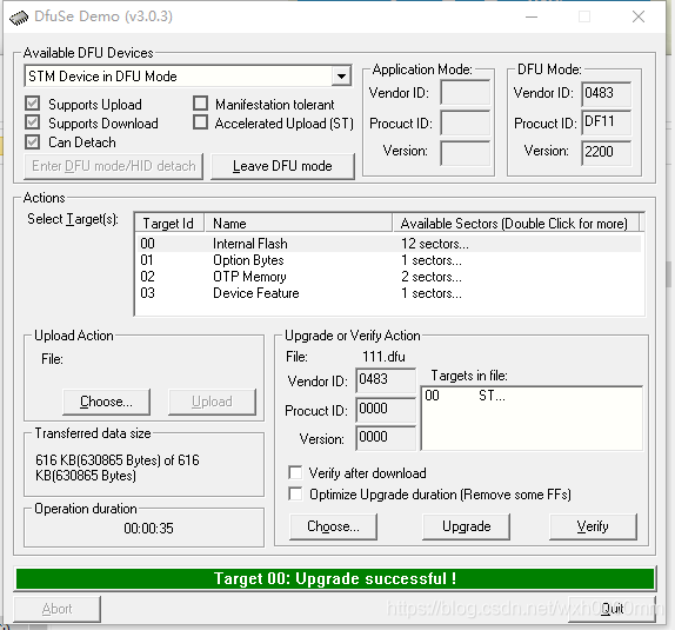

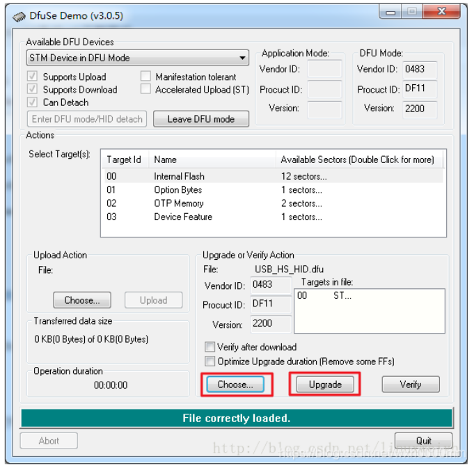

  Open the DfuSeDemo software (attached), click the Choose button, locate the downloaded .dfu firmware, and then click the Upgrade button. See the image below:
