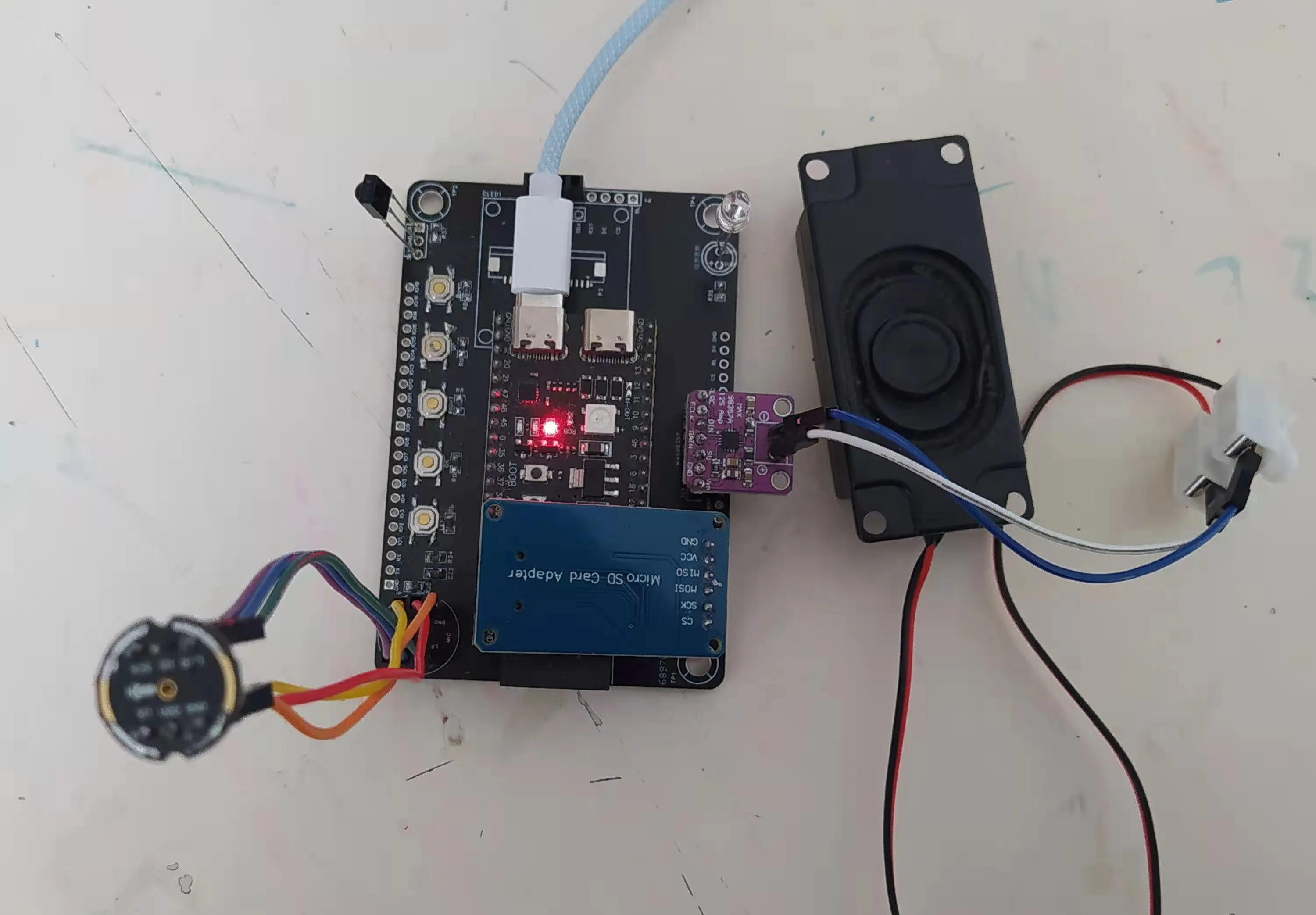

This is a main control board similar to Tmall Genie, implemented using the ESP32S3. Currently, it's built using a modular assembly method. The main control board uses an ESP32S3 development board inserted into the verification board. Voice, amplifier, and SD card also use readily available modules, mainly saving time on hardware verification and directly verifying the software implementation. After stable verification, we plan to integrate them onto a single board later. The main functions implemented so far are as follows: 1. Human-computer dialogue based on a large language model. Press and hold the OK button, then speak. Releasing the button converts the speech to text, then requests a request from the backend to relay it to a third-party large language model. The returned text content is sent to the device, which then converts the text back to speech and plays it through the amplifier. Currently, it's integrated with Baidu Wenxin Yiyan for verification. Compared to GPT, Wenxin Yiyan is significantly inferior, but GPT has limited use in China and presents many problems. However, more other models, such as Microsoft Azure, will be integrated later. The integration model is configured in the backend, and model switching is transparent to the device. 2. Smart switch. The smart switch is the origin of my design for this board. Currently, it works with two other 8266 main control relay boards (one 86-in-one board and one micro single-control board, which will be open-sourced simultaneously) to achieve voice and infrared remote control of light on/off. During the initial configuration phase, an internet connection is required to configure the device. After the device is configured, all commands will be cached on the main control board, and then it can control other devices offline. 3. A touch screen will be added later to achieve more functions. 4. The ultimate goal is to achieve complete backend programming of the device using a server-side language like Java.
Soldering:
1. Two ESP32S3 development boards are configured on the board to support insertion on both the top and bottom of the board. Only one board needs to be inserted on one side, and the pins of both are the same.
2. The resistor values ​​configured for the 5 buttons must be soldered according to the values ​​in the schematic diagram. Otherwise, the analog signals read by the program will have problems, and the buttons may malfunction or become disordered.

1. First, connect the board to the computer using a USB cable. Flash the attached jmicro_v3.0.1_all.bin to address 0x0. If you have an IDF environment, you can execute the following command:
`esptool.py -p COM19 -b 460800 write_flash 0x0 jmicro_v3_all.bin`
. Alternatively, you can use the official firmware flashing tool.
2. After flashing the firmware, connect to the serial port to view the boot log. Currently, this firmware has complete log output, so there is some performance loss. Upon initial startup,
it will automatically enter Wi-Fi pairing mode. Check the Wi-Fi list on your phone or computer to see if the ESP32_CFG Wi-Fi is listed. If not, manually and quickly press
the Left button on the board three times. Wait a moment and check again; you should now see the board's open hotspot, as shown in the image below.
3. After connecting to this Wi-Fi, open http://192.168.4.2 in your browser.
On the page shown below, enter your home Wi-Fi username and password, click submit, and after seeing "success," the board will automatically restart and connect to Wi-Fi. If the Wi-Fi input is incorrect, the board
will fail to connect to Wi-Fi. In this case, you can manually press the Left button on the board three times quickly to reconnect to the hotspot opened by the board until successful.
