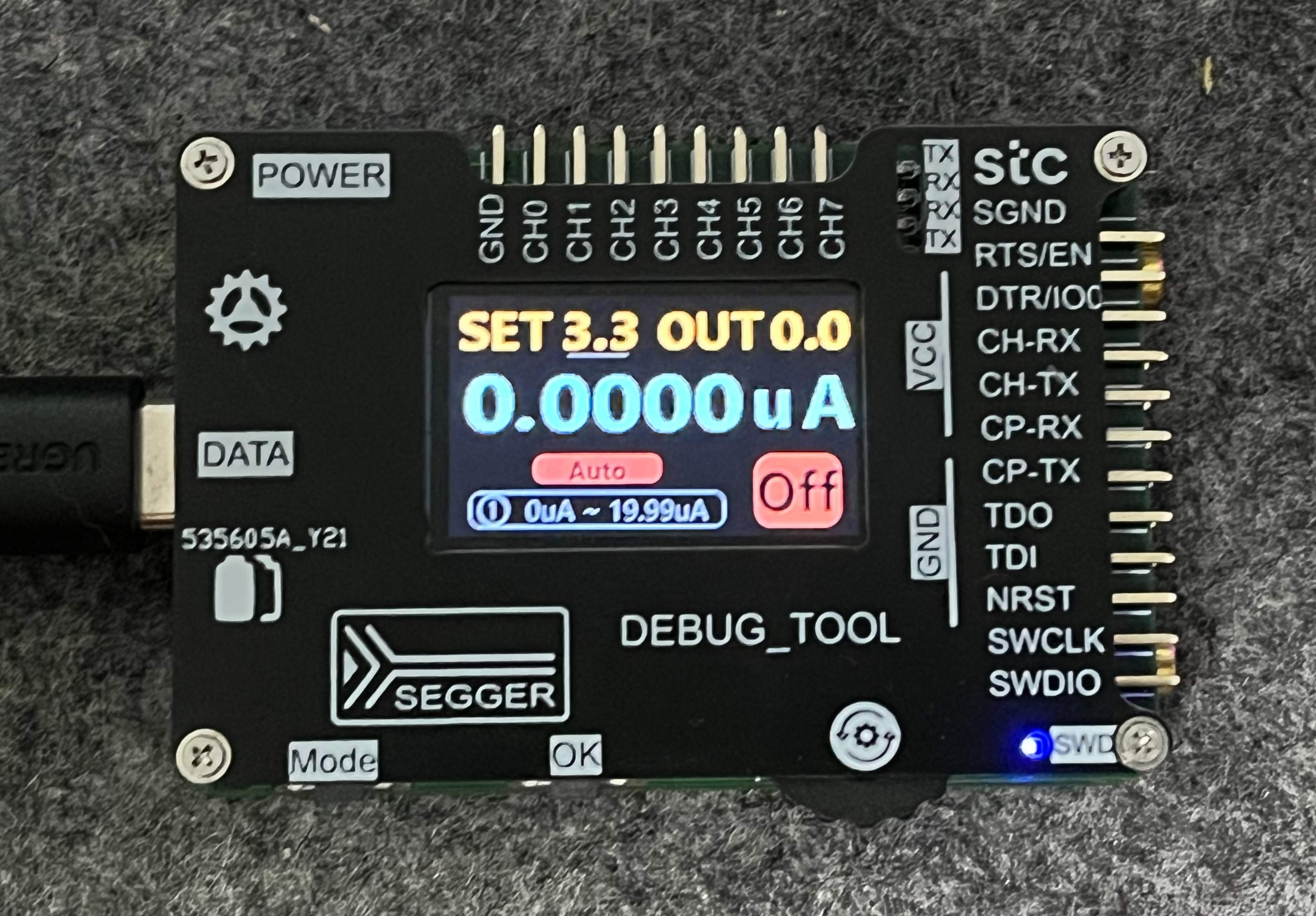

Precautions:
1. The digital board V1.0 integrates J-Link OB, and V2.0 integrates J-Link V9. Neither will lose firmware, but J-Link OB is slower. J-Link V9 cannot currently be programmed on the Nordic platform. Other platforms still need to be tested. It is supported by mainstream microcontroller platforms.
2. When the power supply is set to output below 5V, the maximum current should be kept below 1.5A for a long time, and can reach 1.9A instantaneously. When switched to 5V, it is a direct USB output, and the current limit is the output power limit.
