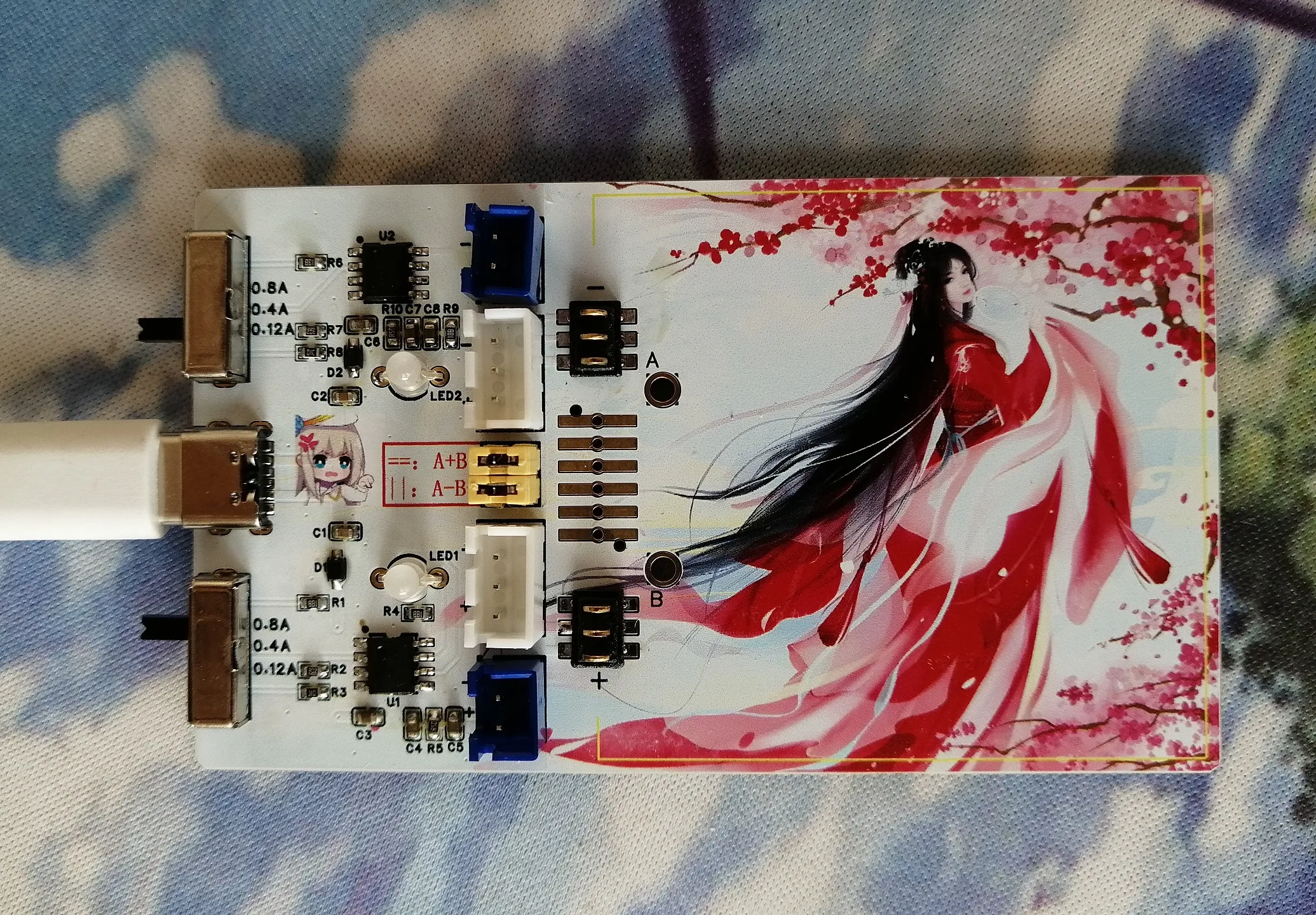

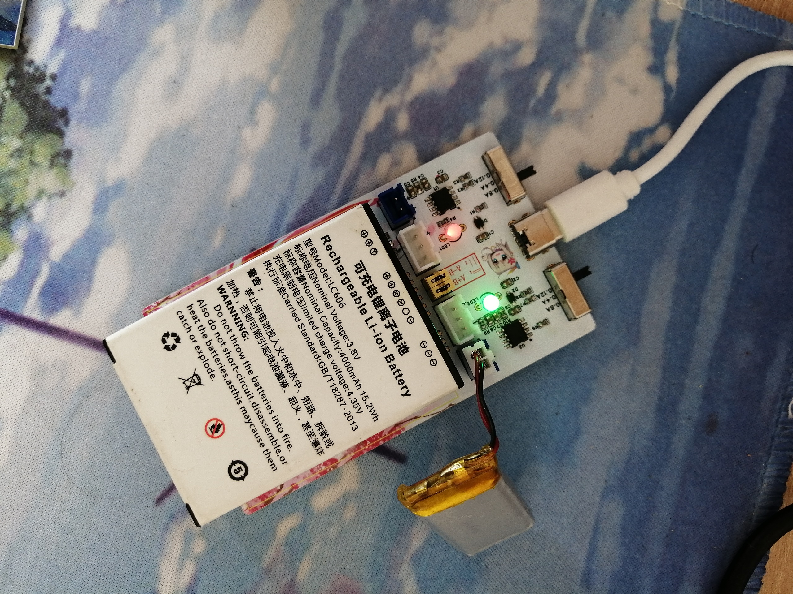

Lithium battery charging board
It uses the CN3153 charging chip and features comprehensive charging protection. A toggle switch allows for three levels of charging current adjustment. Multiple battery interfaces are provided, including a universal interface with switchable positive and negative terminals, which can charge various non-standard batteries via a spring-loaded contact.

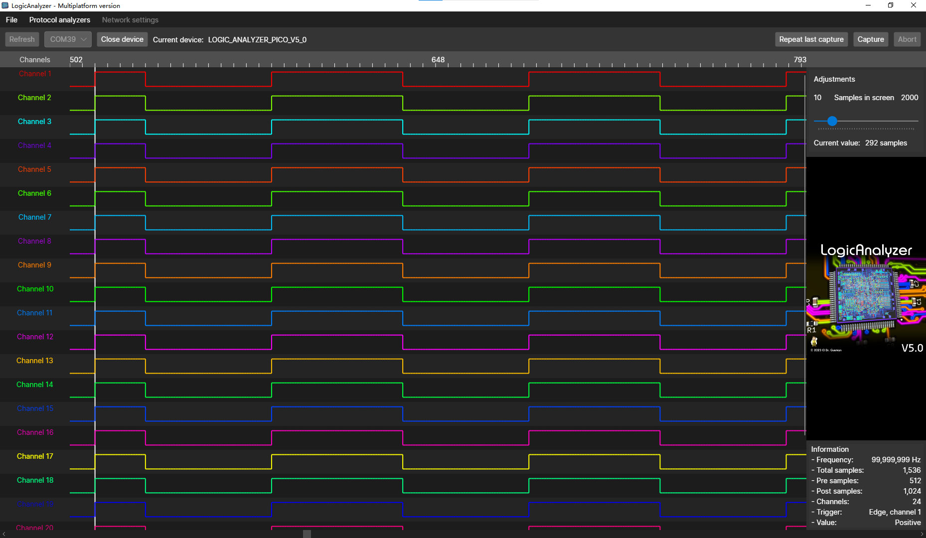

Actual testing
on December 23, 2023, involved
generating a 100kHz PWM waveform using an FPGA. The firmware Firmware-LogicAnalyzer-5.0.0.0-PICO.uf2 + logicanalyzer host computer appeared to have no major issues, and the synchronization of the 24 test signals was relatively consistent.
reg [15:0] period_counter ; // Period counter frequency 100khz period 10us count value: 10us/20ns=50
parameter pwm_duty = 16'd25;//50 * 50/100;
//***************** main code *****************//
assign pwm_pin = (period_counter >= pwm_duty) ? 1'b1 : 4'b0;
// Period counter period_counter2 returns to 0 when it reaches 50 after 10us period
always @(posedge sys_clk or negedge sys_rst_n) begin
if (!sys_rst_n) begin
period_counter <= 16'd0;
end
else if (period_counter >= 16'd50) begin
end
else begin
period_counter <= period_counter + 1'b1;
end

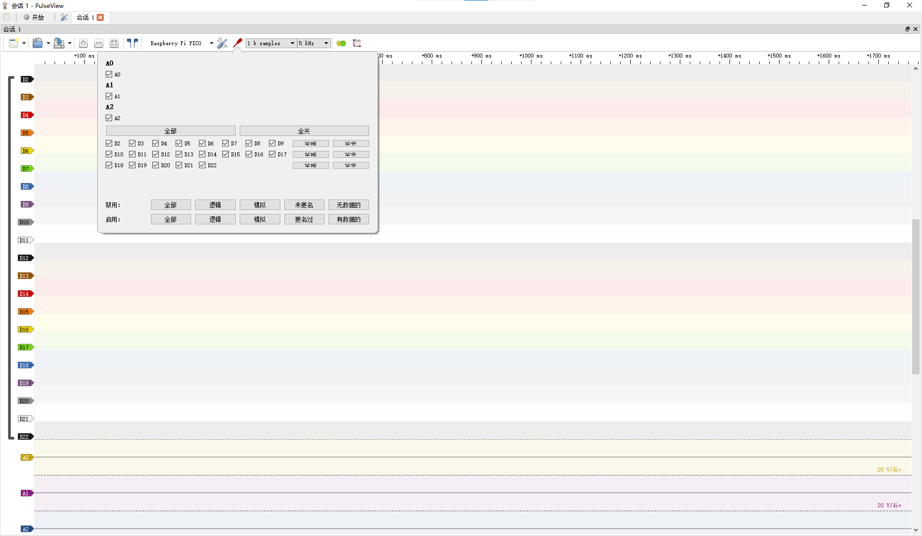

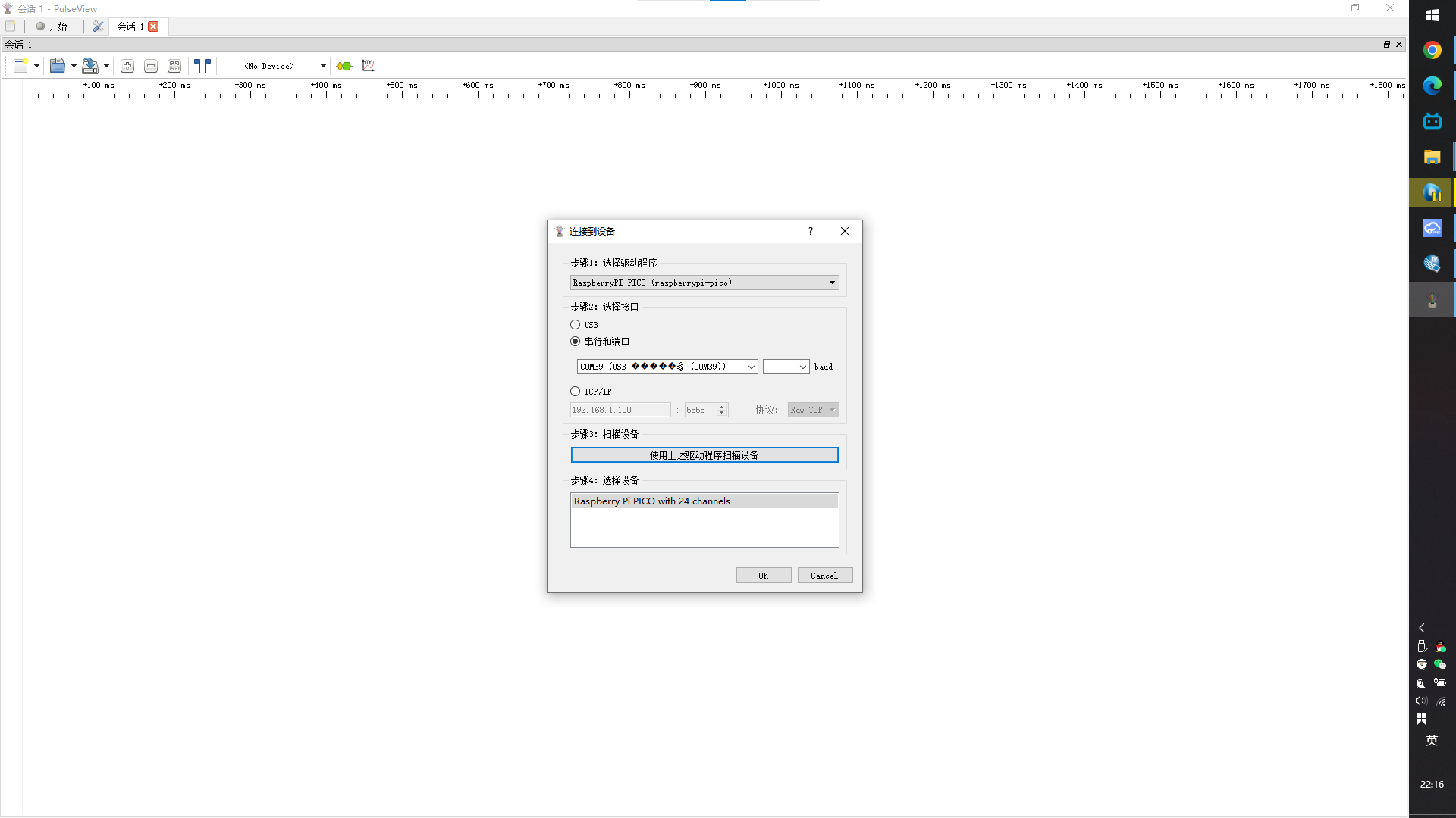

end December 25, 2023: Based on this video and post,
the test used firmware pico_sdk_sigrok.uf2 and supported the PulseView host computer. Channels 22, 23, and 24 can be used as analog channels. The test achieved a very high sampling rate with a 100kHz square wave.
pico_sdk_sigrok.uf2

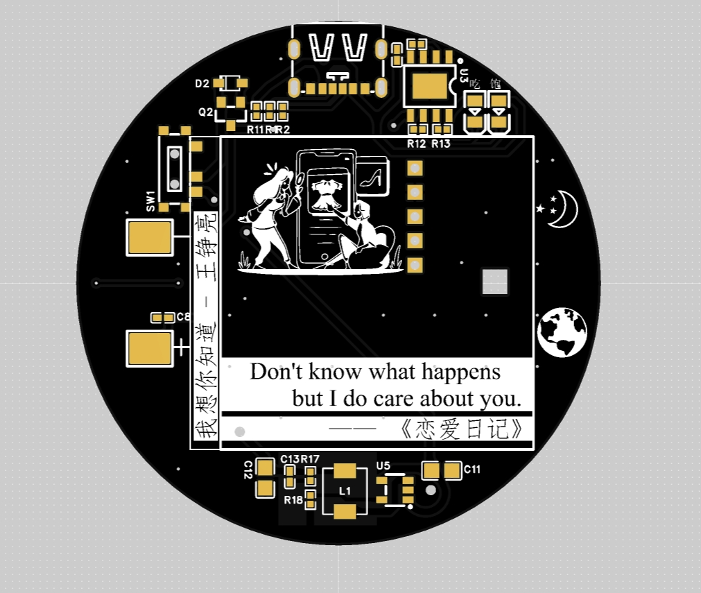

Air001_ws2812B
Love Diary Series - Mini Light Board! Make one for him/her now!
Based on Air001MCU and WS2812B, developed using KeilMDK;
/**********************************************************************Latest optimization 11/28,
*Iterated a bit, corrected colors, modified mode 3, added mode 7 and mode 8, refined brightness adjustment resolution to 0.02
*The meteor tail in mode 4 can have some gradient effects
*Three boards have been added to the Bilibili Workshop [Button-Controllable Little Confession Colored Light Ring] https://www.bilibili.com/video/BV1Xz4y1w7v9/?share_source=copy_web&vd_source=adedc4f4cae1d0c8a23ceb18cc9d9999
*Future code updates will be on Gitee, and the latest code will be updated in the comments section one week later;
**************************************************************************/Suggested material purchases and environment setup (purchase links are in the attached BOM)

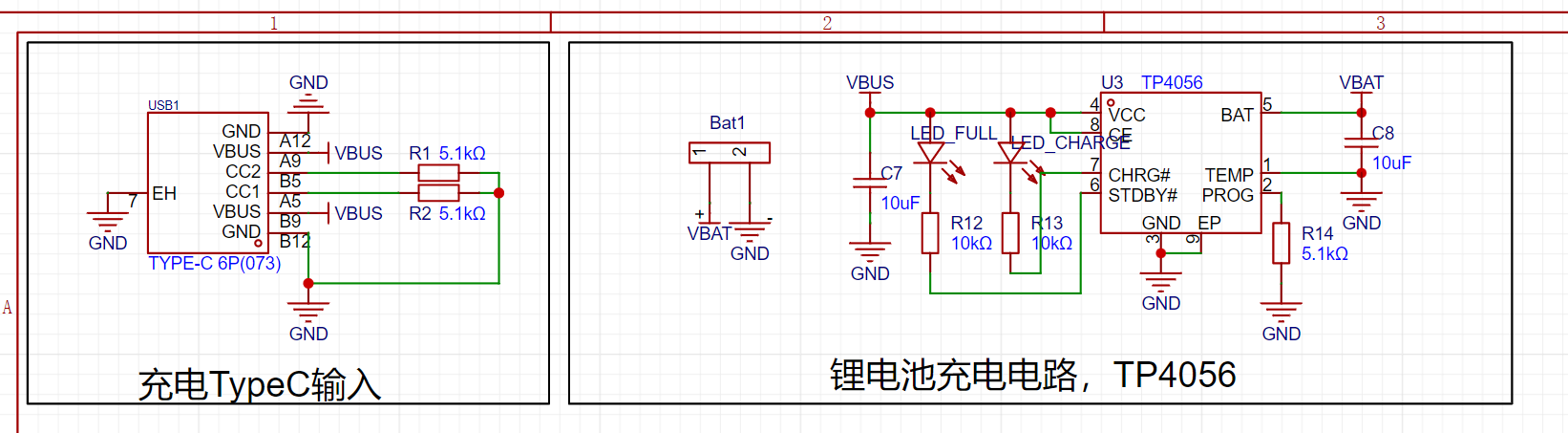

Schematic design description:

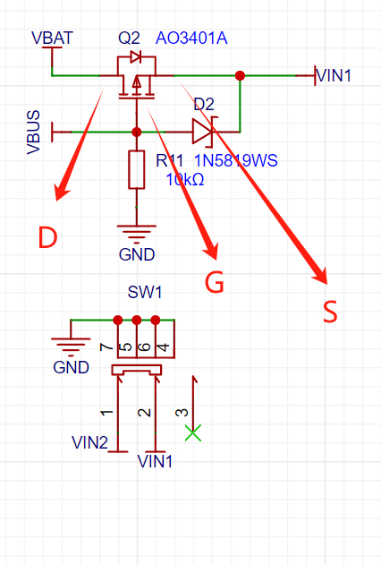

Type-C power supply & TP4056 lithium battery charging (familiar, no explanation needed, just use it).     LED_FULL fully charges and lights up; LED_CHARGE charges and lights up.
Battery power supply and Type-C power supply switching (classic circuit from the summer training camp).
Power supply switching is implemented using PMOS. No Type-C (VBUS = 0), VBAT flows a small voltage to S, then VS > VG, directly SD conducts; powered by lithium battery; with VBUS, the potential at G is higher than S (with Schottky diode), SD does not conduct, VBUS directly supplies VIN1;
the 3.3V voltage regulator circuit based on SY8088AAC
, whether it is 5V or lithium battery voltage input, finally drops to 3.3V output, supplying power to WS2812B and Air001.
WS2812B power supply is fully parallel, the Data pin is connected in series
with the buttons (IO port is configured with pull-up, so the buttons are all grounded for anti-interference).

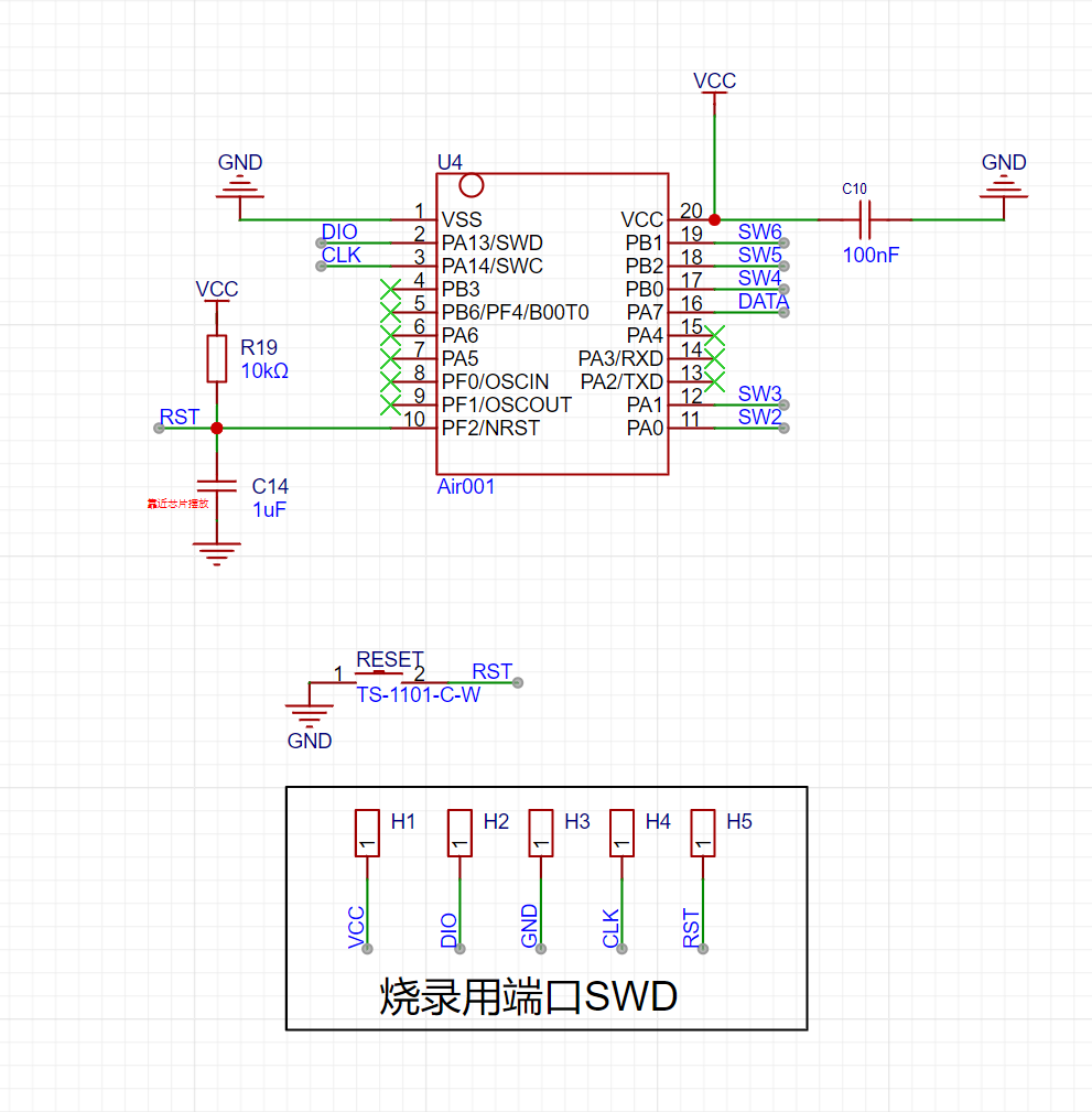

The MCU main schematic
uses SWD programming method
including reset circuit;

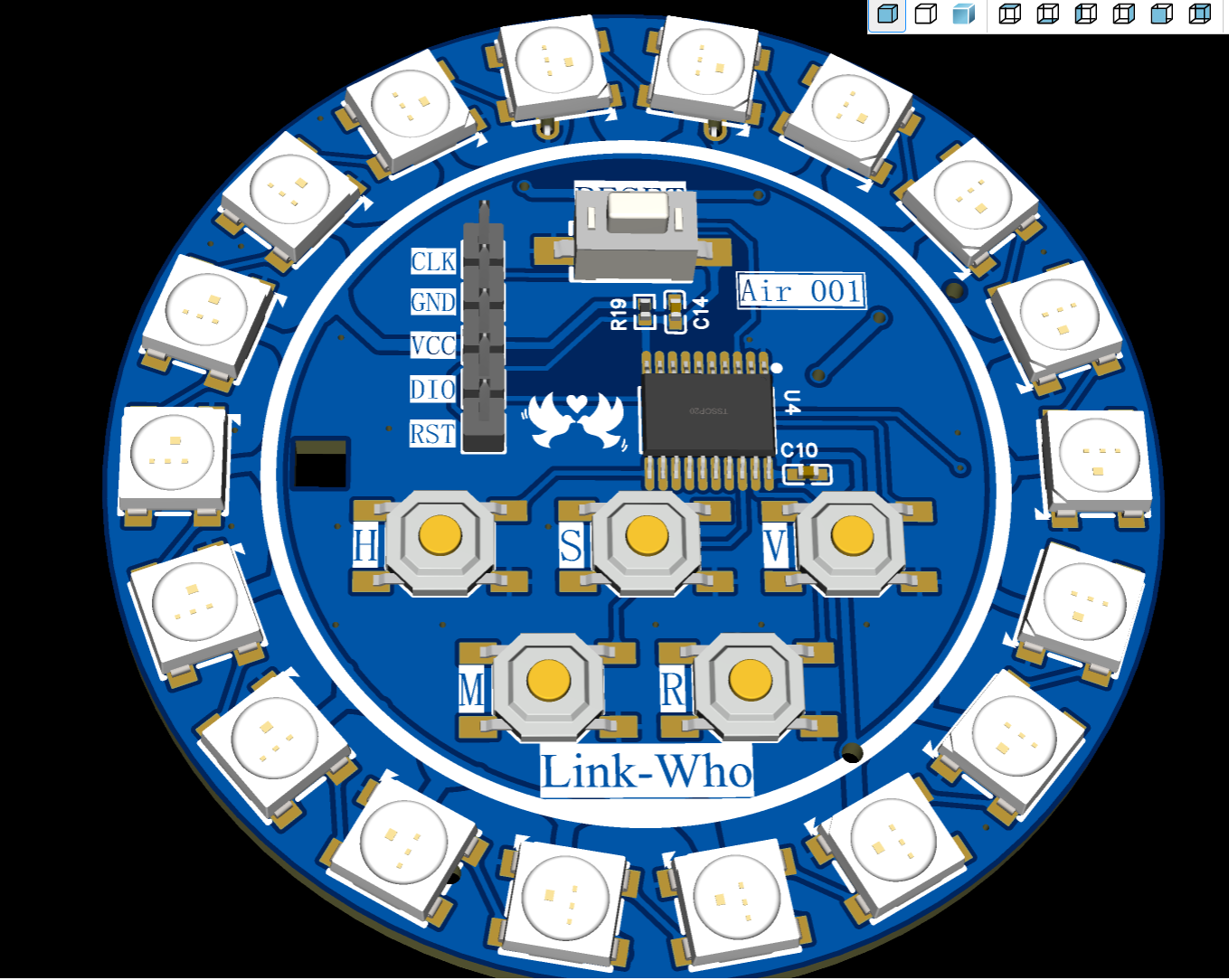

PCB design instructions:
solder Type-C, pay attention to check if the pins are short-circuited, LED5 is generally fine, that GND is interconnected; note that the data pin of LED6 cannot be grounded.
Although I played Wang Daye's song, my favorite is Land Rover!!! (Green)

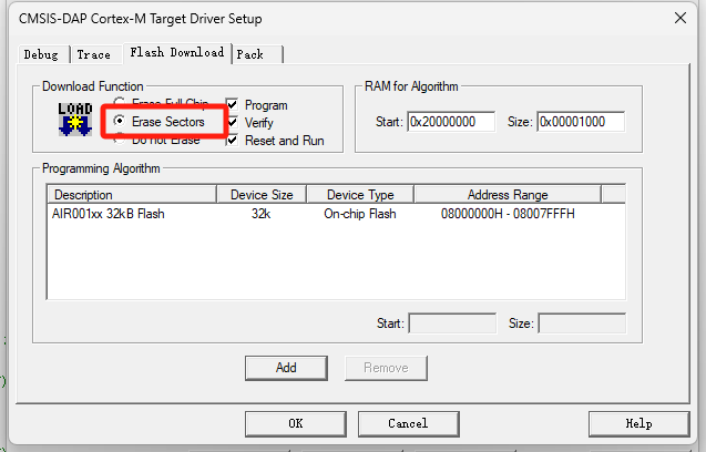

Burning Instructions:
Two burning steps to save flash data. First burning: uncomment `InitializeRGBArray();`.
Second burning: comment out `initializeRGBArray();`. Recompile and burn.

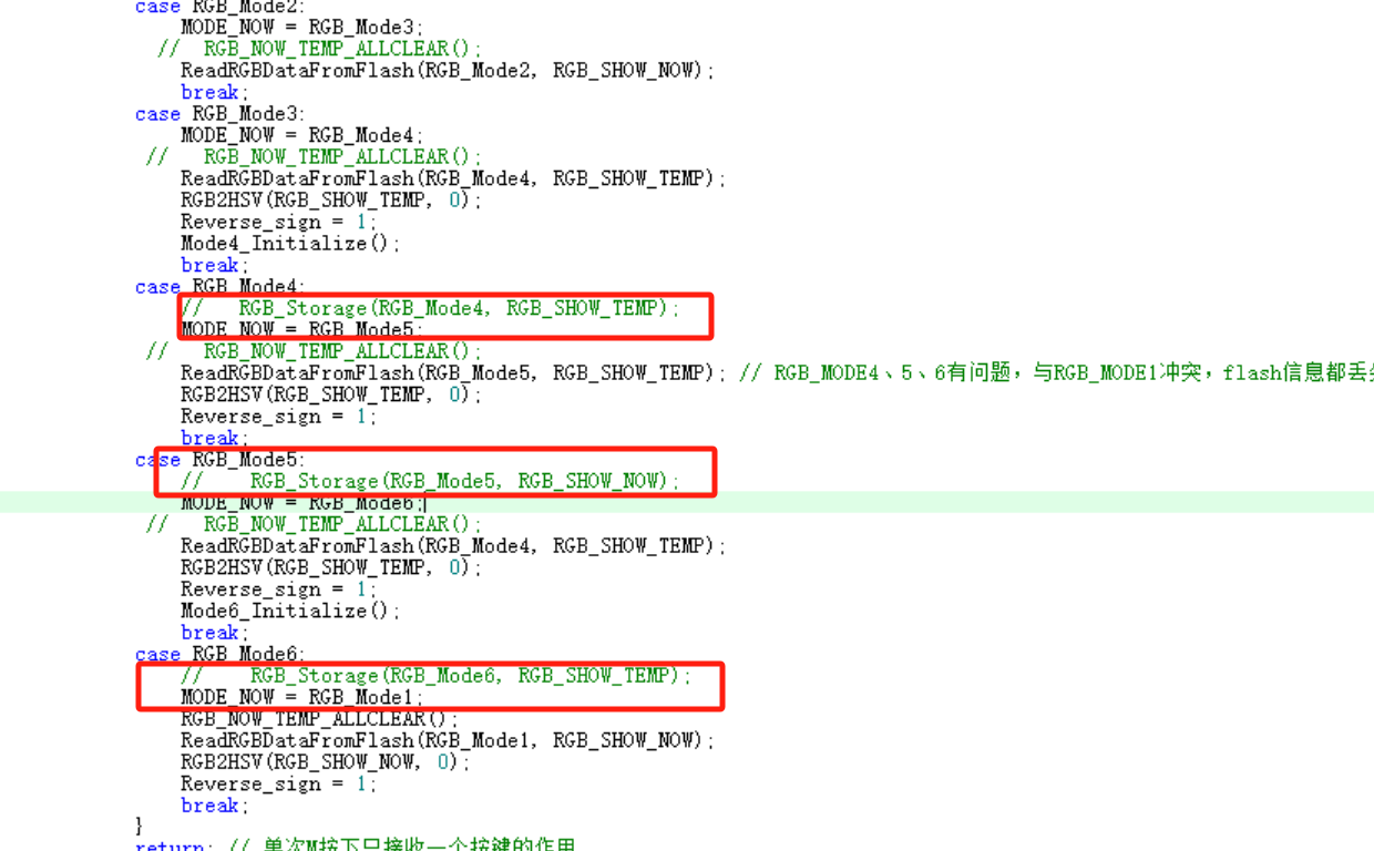

Key Mode Instructions:
Only monochrome display mode can adjust HSV. Multicolor mode is my custom code written in the flash; you can modify it in the `InitializeRGBArray()` function in `flah.c`. H: 0-360 Hue button; S: 0-1 Saturation button (0 represents white light); V: 0-1 Brightness button (1 is the brightest
mode). Switch to M key. Mode 1: Monochrome display, with flash saving function. The adjusted color will be saved after switching to Mode 2. After power off and on, the previously adjusted color will be displayed. I like purple the most. Mode 2: Display mode, sequence: Rainbow ring continuously pushes and disappears -- Each one starts off -- wait, the last one is a random light effect, randomly on, randomly off, random color (the color here is just a preliminary rainbow color I tested in Flash). Mode 3: Rainbow circle rotation; Mode 4: Meteor tail, single color adjustable
; Mode 5: Breathing light rotation, single color adjustable
; Mode 6: 3*3, 9 lights rotating, single color adjustable
. Add/subtract switch: R key reverse.
Note:
I can't think of a good mode idea; Modes 4, 5, and 6 should theoretically be able to save the adjusted data, but every time I open them, they mess up all my saved Flash information, even Mode 1 cannot be saved, so I turned them off;

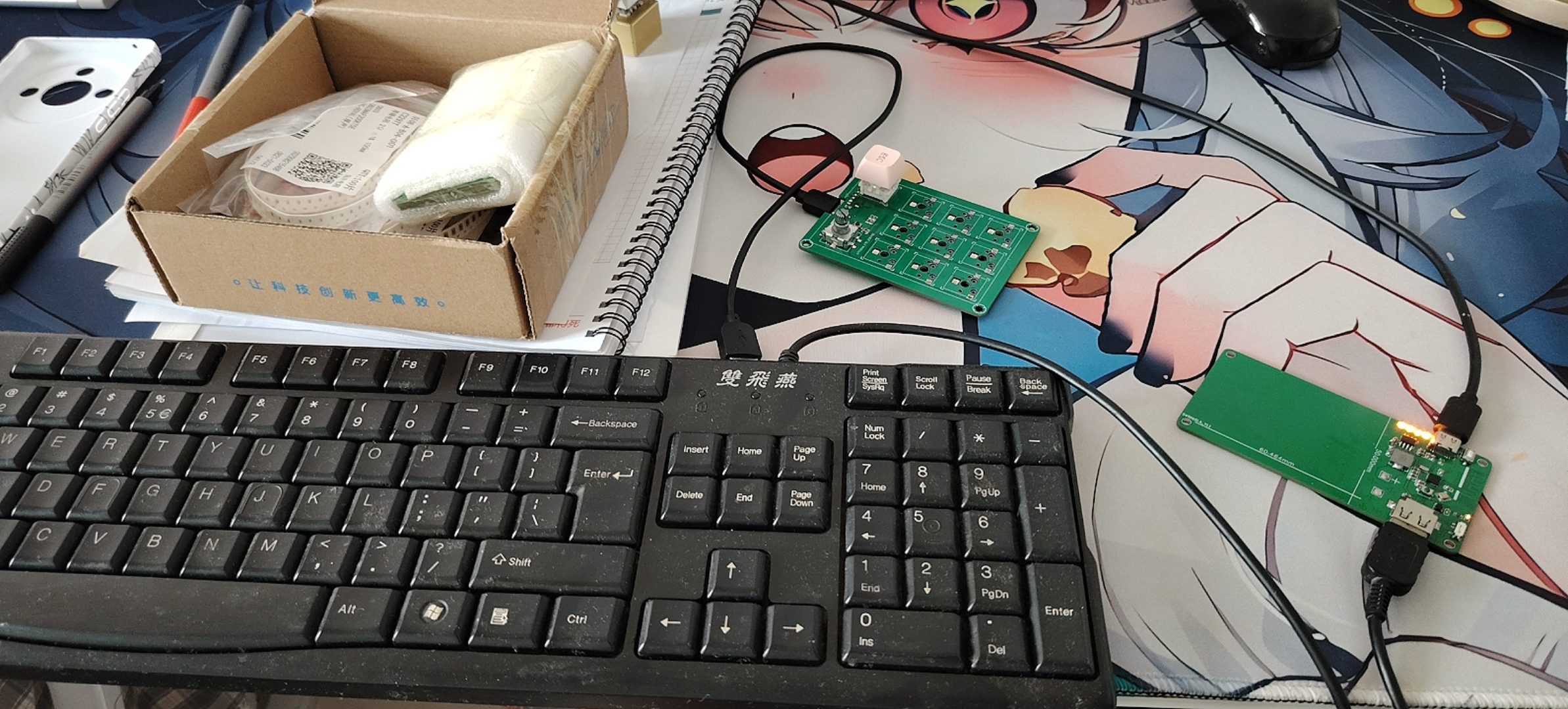

USB to Bluetooth HID

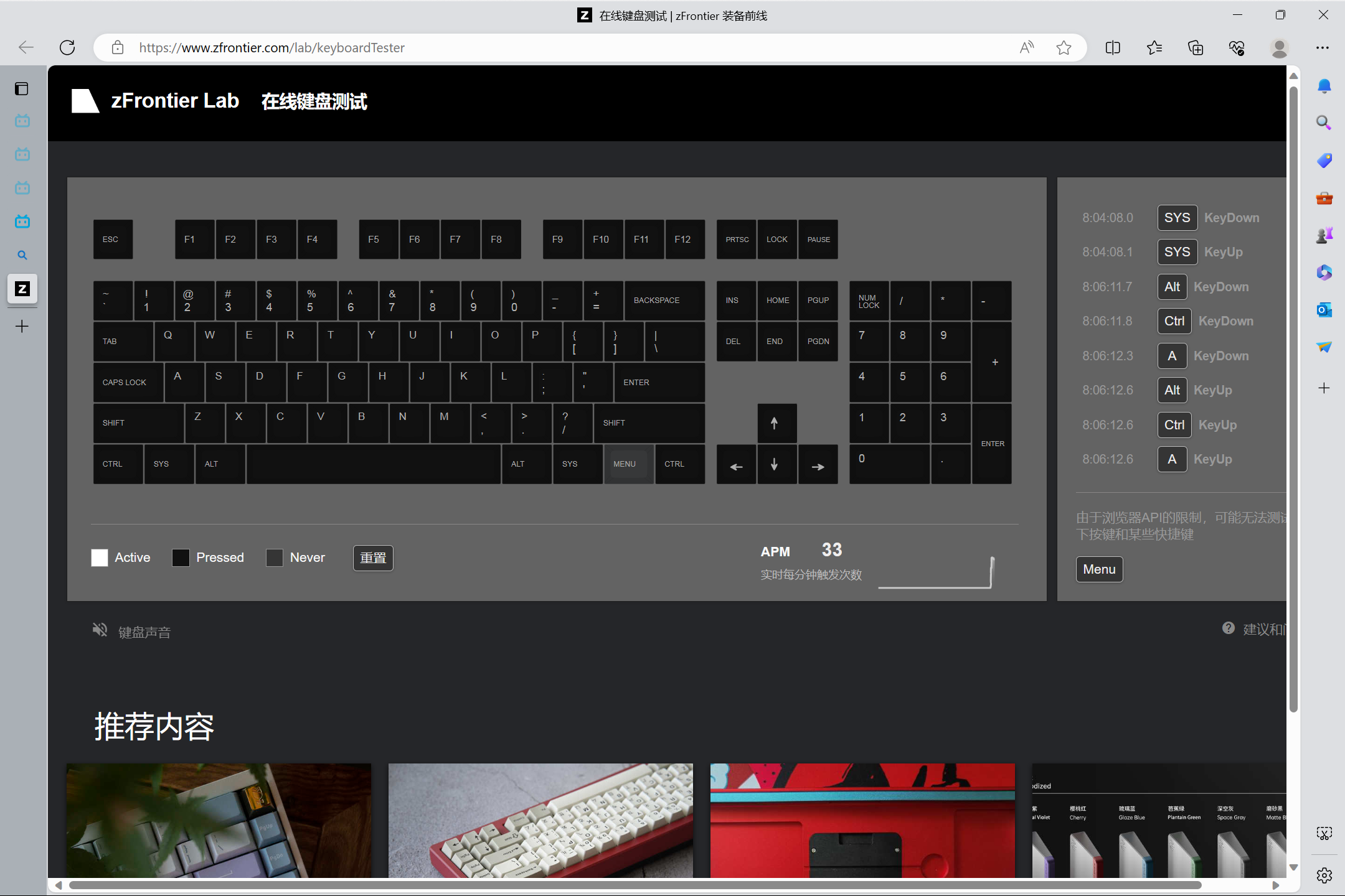

A wired keyboard to Bluetooth module
This is a wired keyboard to Bluetooth keyboard module, using the CH582F Bluetooth chip and IP5306 charging/discharging chip. It supports power display (via four LEDs) .
An old A4Tech keyboard can be used as a reference,
showing that all LEDs can be triggered.
Currently, this module only supports standard keycodes; some keyboard macros are also supported (see attached video).
A single module transmits at approximately 0.04W, measured at around 5V 8MA.
Firmware was flashed via wchtool USB and has been uploaded.

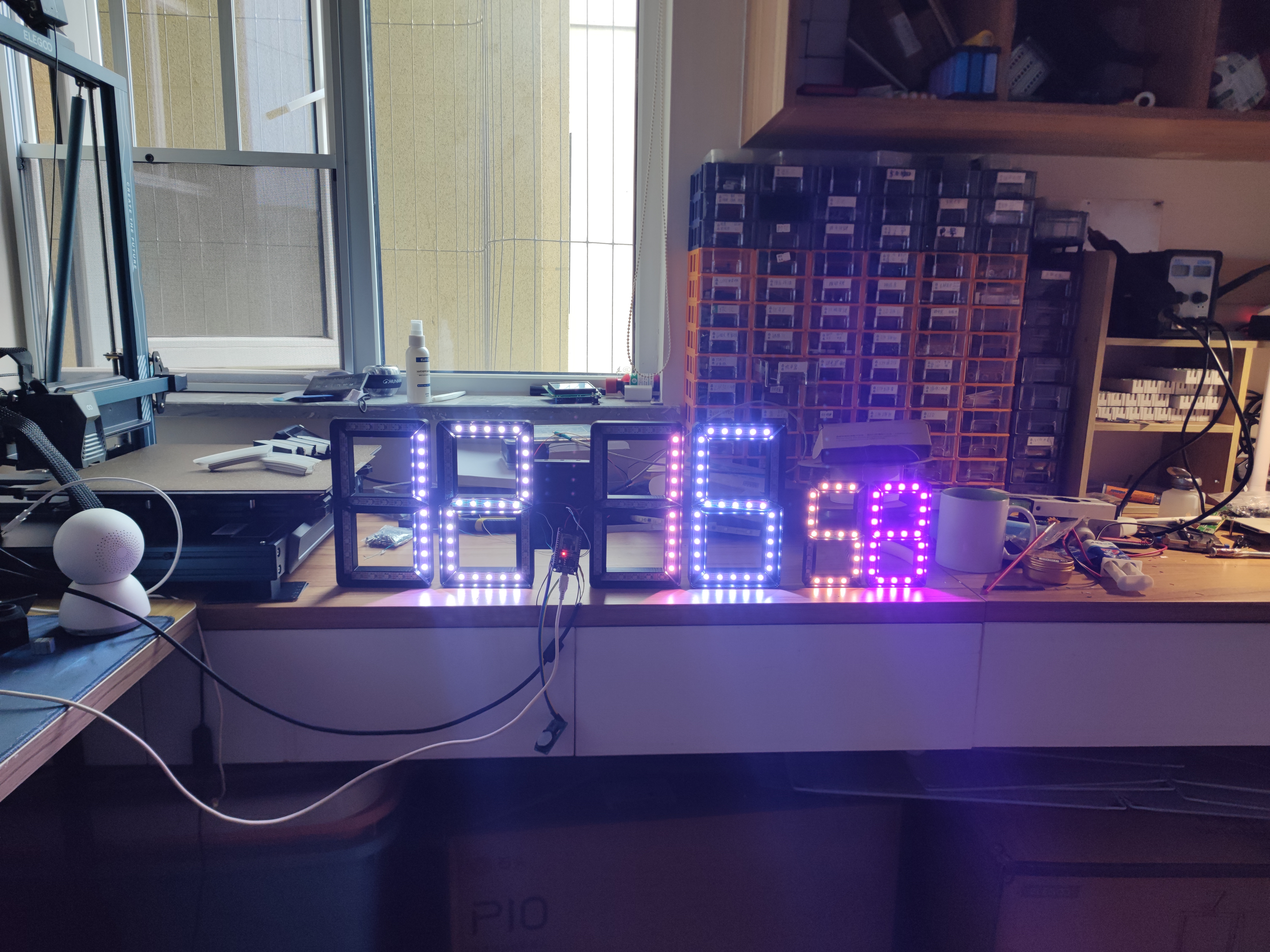

Large digital tube clock

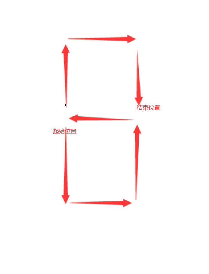

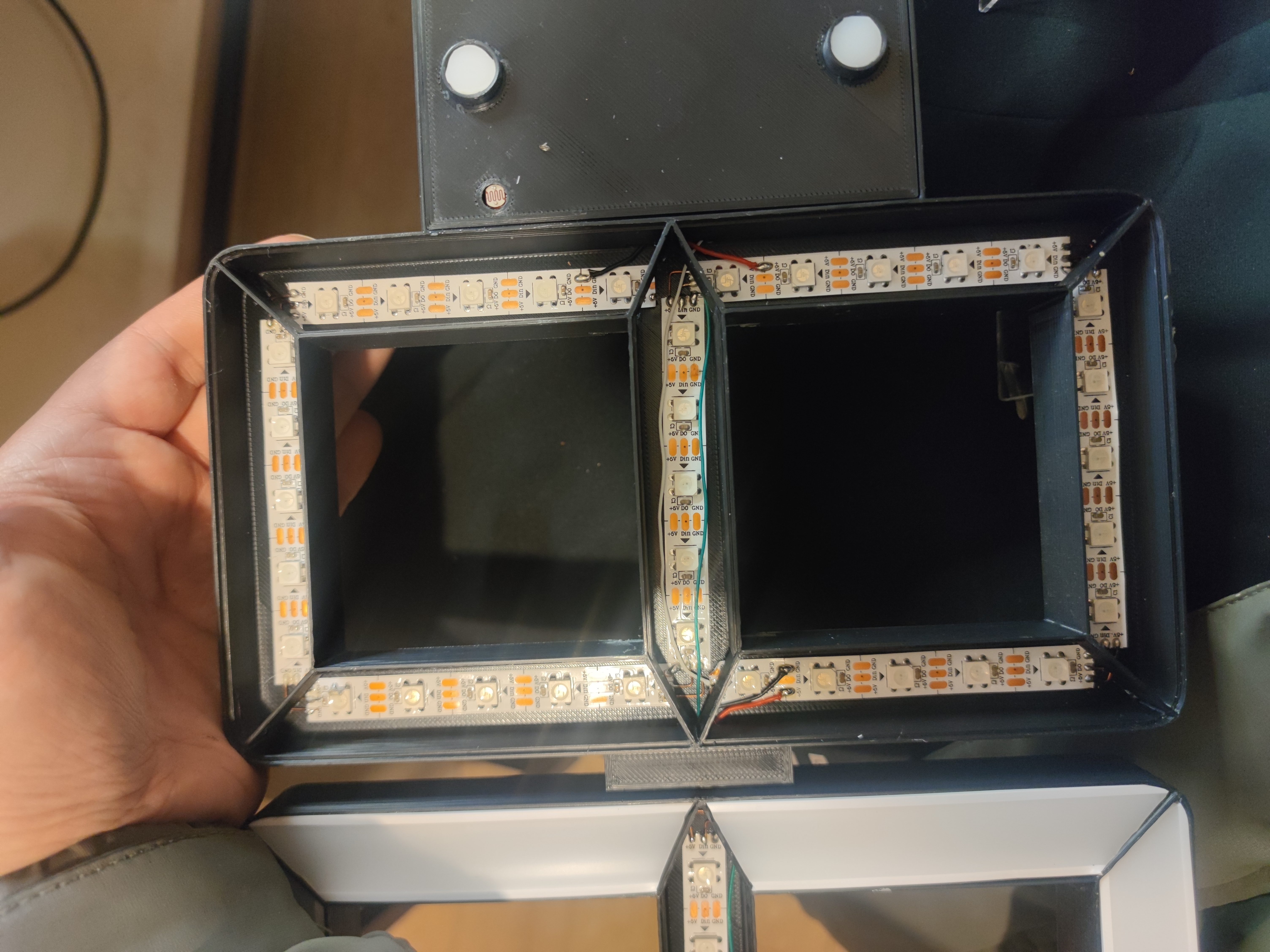

An oversized 3D-printed digital tube clock, illuminated by WS2812 LED strips.
The LED strip arrangement is as follows.
Note the number of LEDs in each slot. If the number is incorrect, you need to modify the code to match the number of your LEDs; otherwise, there will be display issues.
