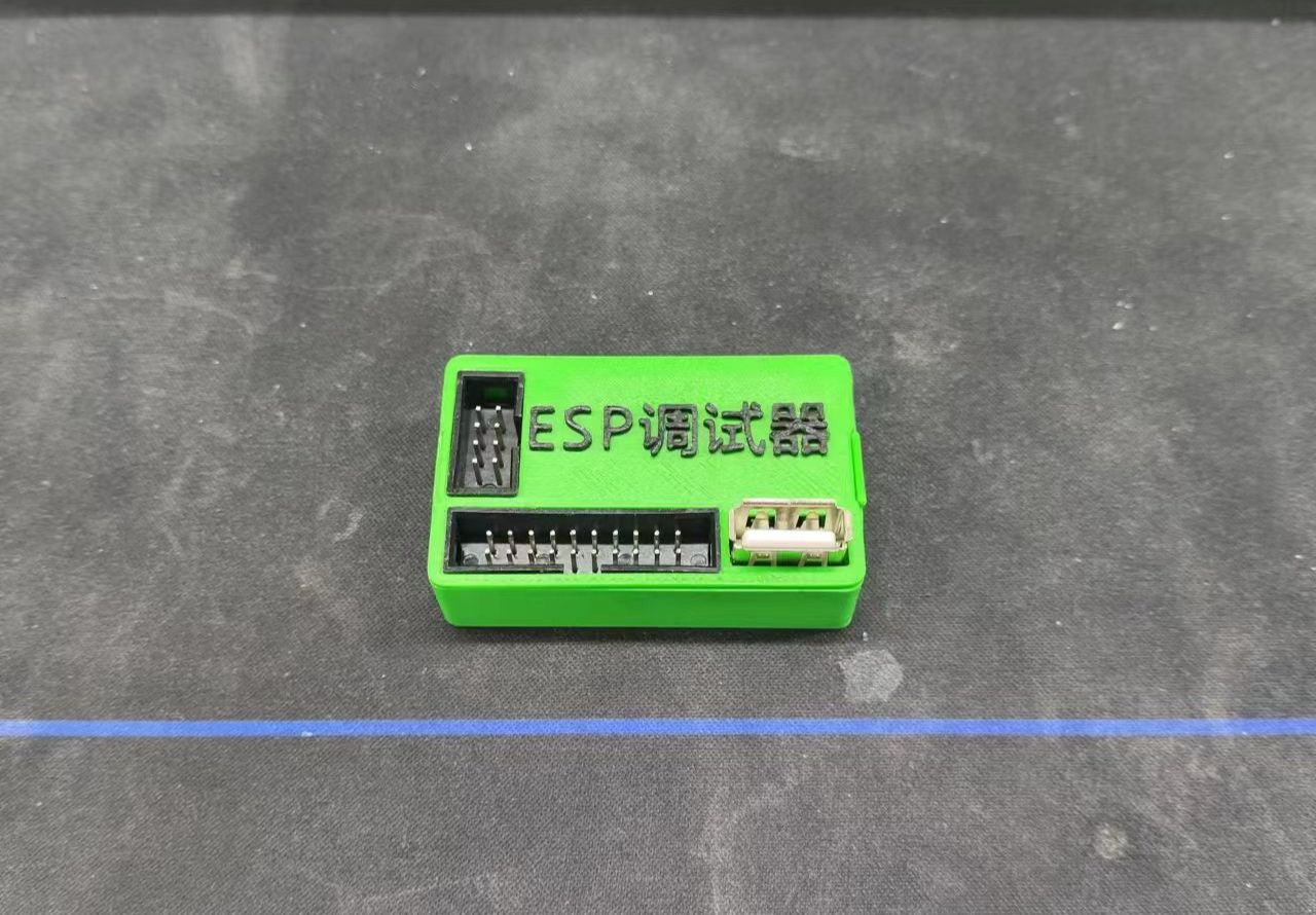

ESP32 debugger
The functionality has been verified by board testing. The USB expansion chip CH334R is used to expand 4 USB signals, and one USB signal and serial port are directly connected to ESP32 S3/C3. An STM32G030F6P6 is added to collect sensor data.
