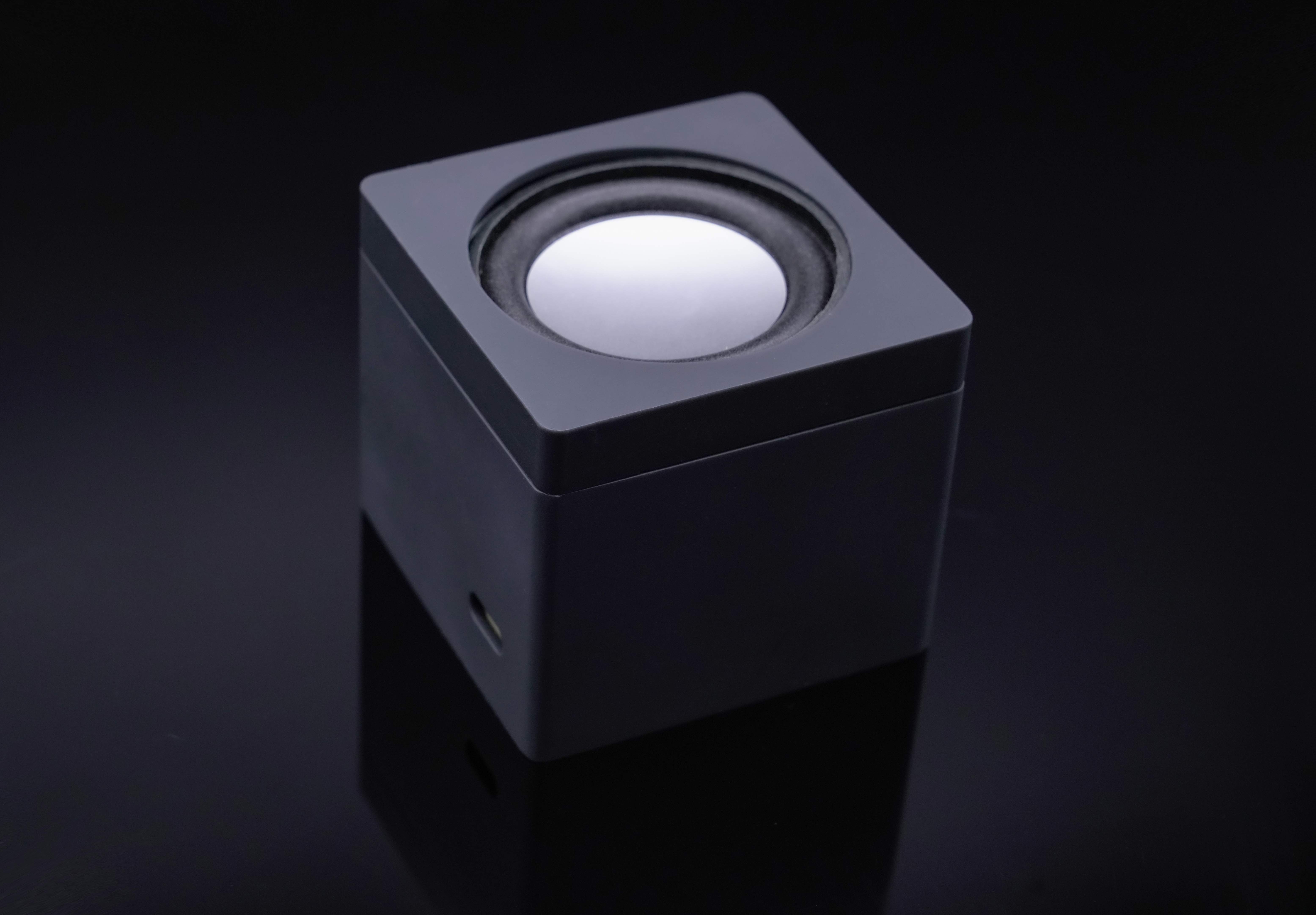

      Who could resist a Bluetooth speaker that can perform voice recognition without relying on the internet? The motivation for this project stemmed from my unreliable home Wi-Fi, which had left my Tmall Genie gathering dust. I happened to learn about the Qiying Tailun CI1302 third-generation voice chip, which boasts an extremely high recognition rate. The voice wake-up phrase and response can be customized, and it even offers an offline voice Bluetooth speaker solution – perfectly meeting my needs! Let's take a look at this solution together; by learning it, you too can design your own Bluetooth speaker!

      The speaker chosen here is a 4Ω 3W speaker, which combines high, mid, and low frequencies and has decent sound quality. The key point is that this speaker is very cheap!
II. Shell Design
      After designing the PCB, you can directly design the shell file in JLCPCB EDA Professional Edition. Shell design becomes very simple here. You only need to combine the board frame to set its shell shape and size, make holes in the corresponding positions, and set screw posts for support. The designed model is shown in the image below:
