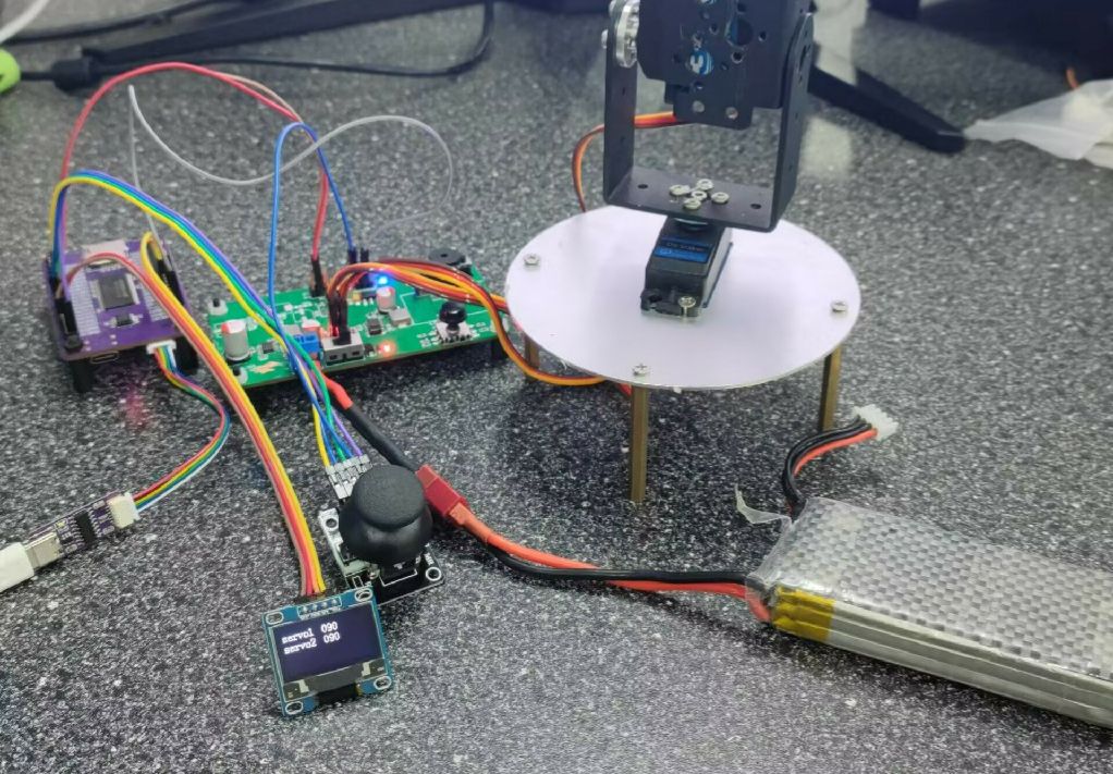

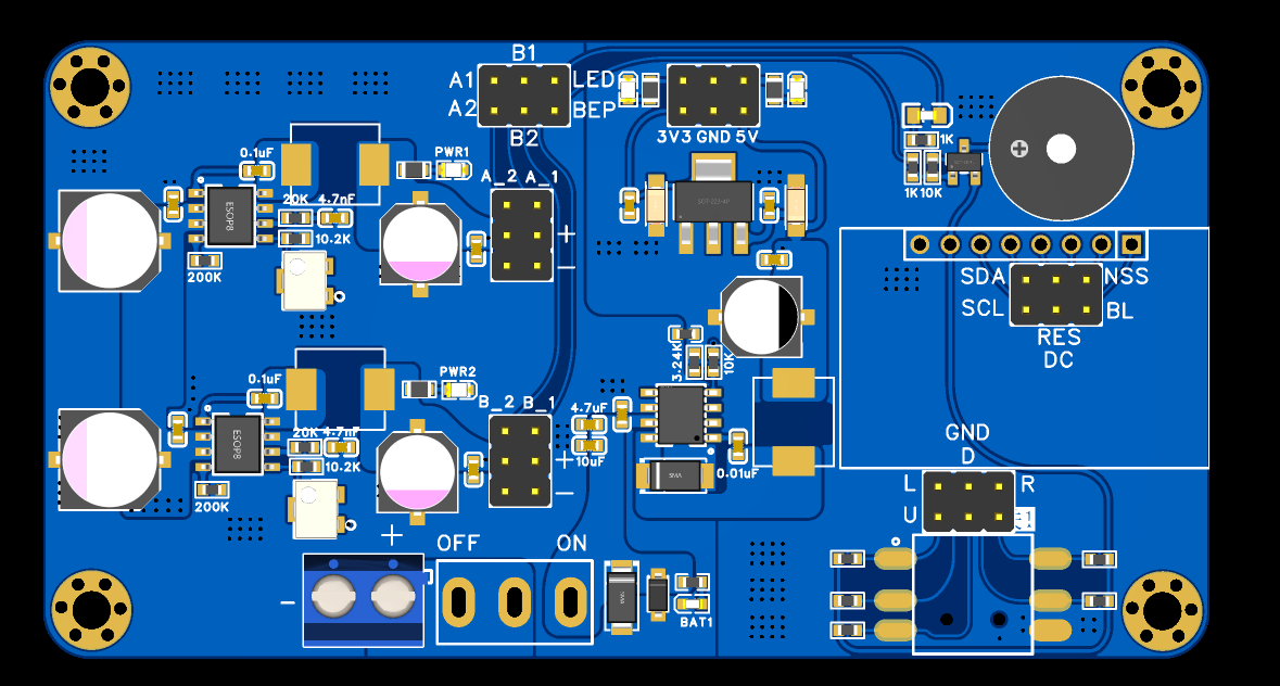

Servo gimbal power board
PCB: Four-channel servo power supply board, also equipped with a five-phase switch, buzzer, LED, 1.14-inch ISP screen interface, external 3.3V, GND, and 5V interfaces, capable of connecting up to a 6S lithium battery. A_1, A_2, B_1, and B_2 are servo connectors; A1, A2, B1, and B2 are PWM signal line interfaces for the four servos, respectively. The onboard 1.14-inch ISP screen module is an SPI serial communication interface.
Physical demonstration: The video shows a dual-axis button remote sensing module connected to the Liangshanpai development board. This servo power supply board controls the servo gimbal's up-and-down rotation and left-and-right movement. A 0.96-inch monochrome screen is also connected, allowing real-time monitoring of the rotation angles of the upper and lower servos. (See physical demonstration video below)
Implementation principle: When the dual-axis button remote sensing module is shaken, it outputs the percentage of X and Y axis offsets. This percentage (0-100%) is converted into a servo motor output angle value (0-180°) (PWM, Pulse Width Modulation). The PWM value is then used to display the rotation angle of the upper and lower servos on the screen.
Key program explanation: 1. Angle conversion: High-level time = 0.5ms + (angle/180°) × 2ms, ServoAngle = (int)(200*(1-((0.5+angle/90.0)/20.0)));
2. Offset Conversion: "Get_Joystick_Percentage_value(0)" retrieves the percentage of the joystick value; "ADC0_value" is the controller ADC compensation value.
