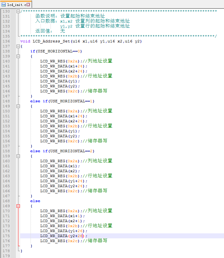

great detail, so I won't go into further detail; they are all available in He's examples. Below are some pitfalls encountered during the production process: As a PCB design novice, I didn't understand how to adjust the spacing between slots, pads, and the board outline, resulting in numerous "X" marks. In the example case, Mr. He used his own component library, which was arranged quite compactly. The dense vias and traces caused various "X" marks, requiring careful adjustment of pad size, via and trace positions. Because I purchased a different screen than Mr. He's, a decorative border appeared on the right and bottom after programming. Later, an expert in the group suggested finding `lcd_init.c`, and I finally corrected the display after modifying and testing the start and end address settings.

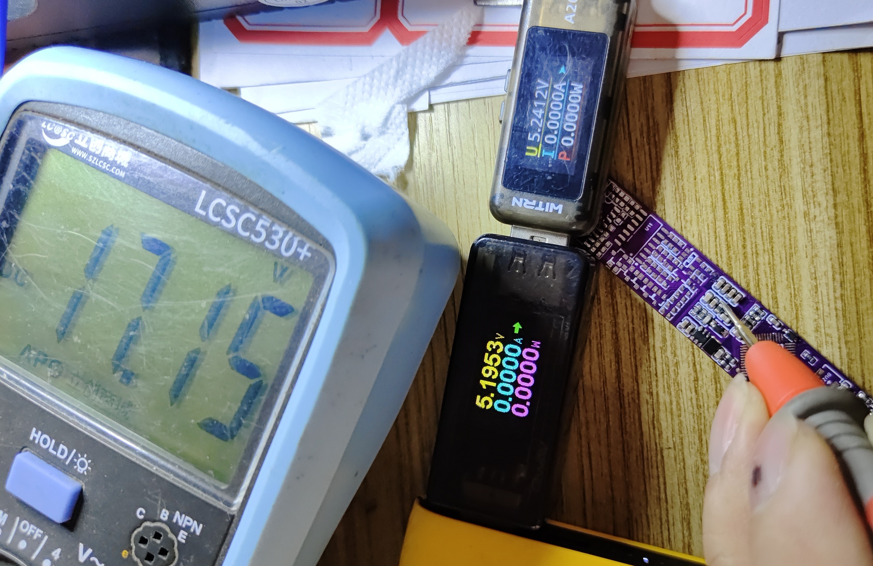

1. Charging test
2. Boost test

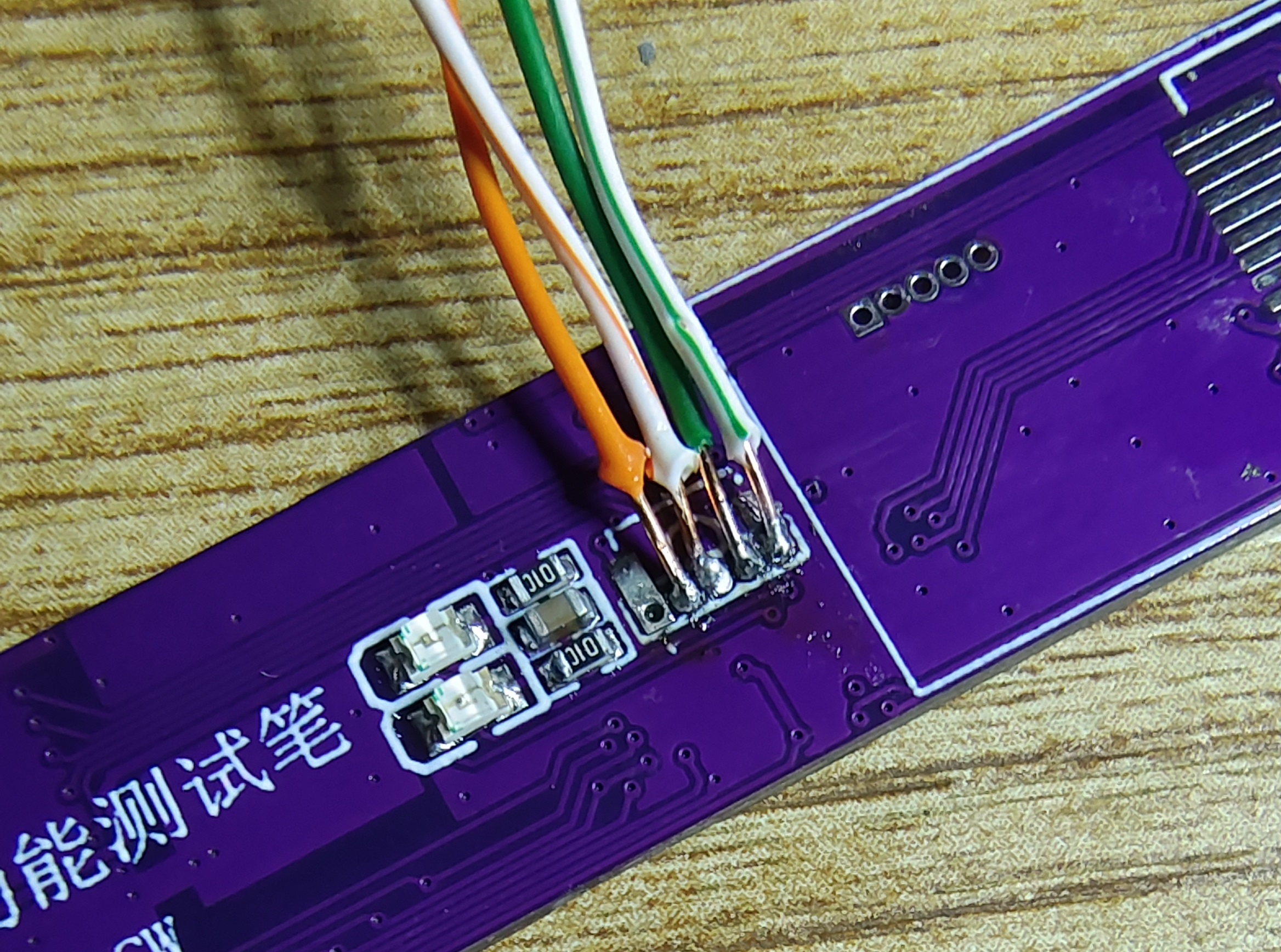

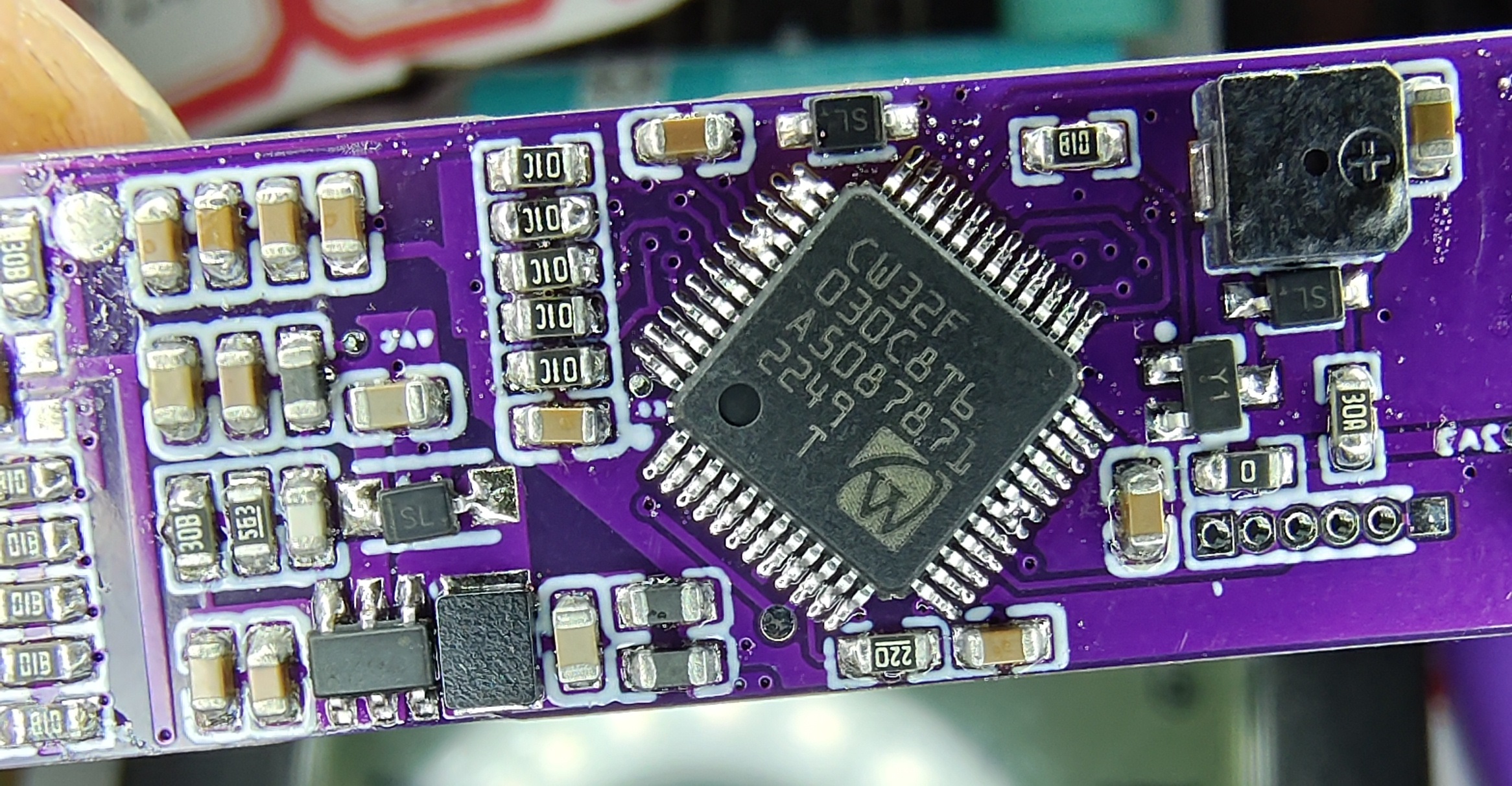

3. Close-up of the CW32 main controller; it was my first time soldering chips with such small spacing, and I only had three bridging spots, which took a long time to fix with the soldering iron
. 4. Soldering copper wires to the programming interface

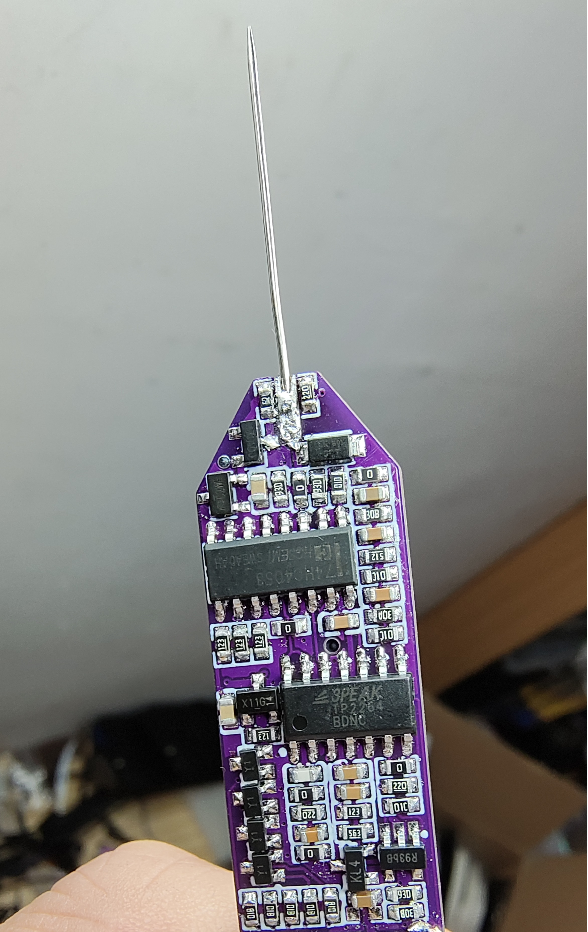

5. "Lightning rod"

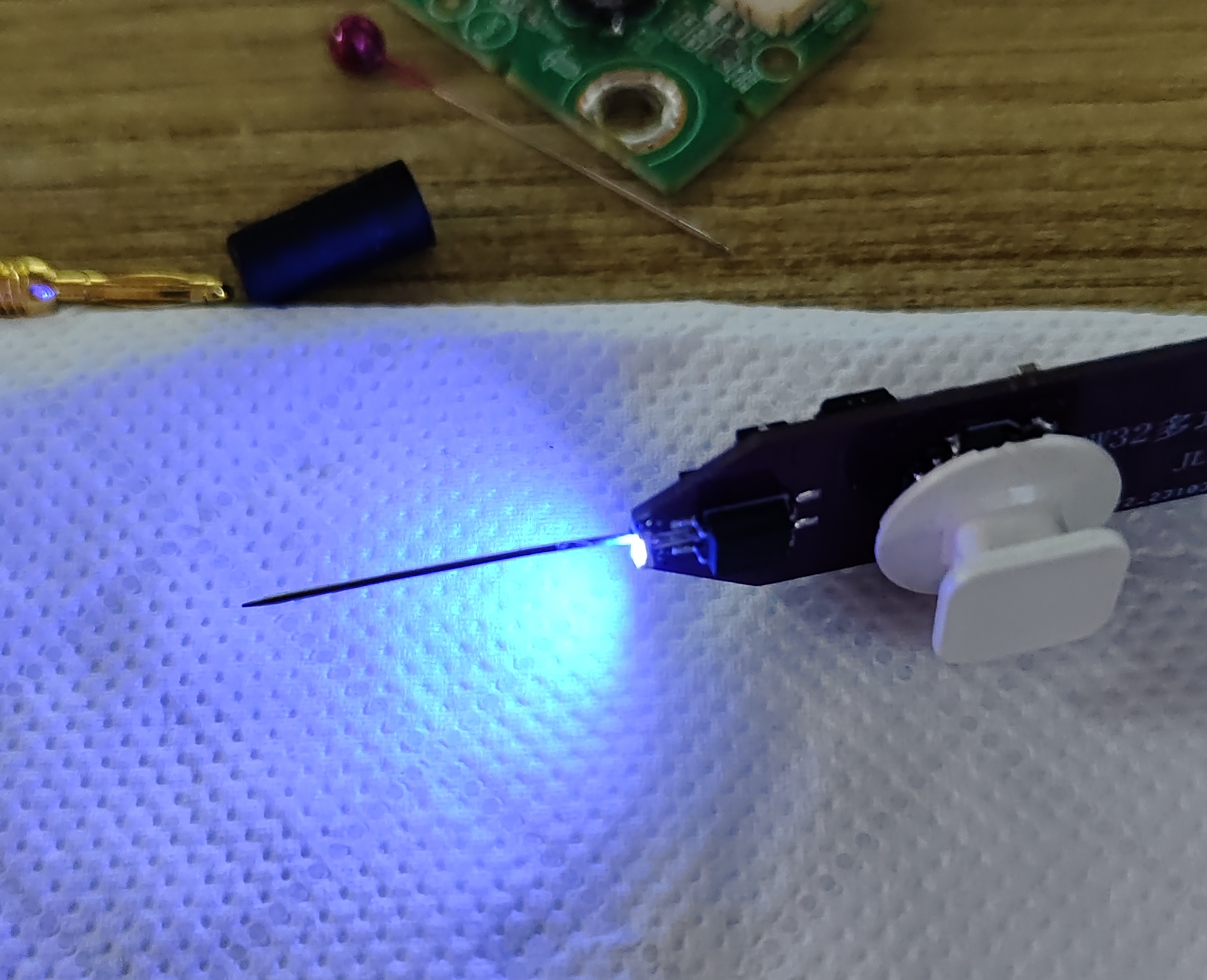

6. While disassembling the 5-way switch, I found a suitable blue light on another monitor button panel and used it as is. It's quite bright and probably rarely used. The power button cap is also blue, so I brought it along. After soldering the switch, I discovered it was oxidized. I scraped the contacts after removing the case, and it worked smoothly. After putting the case back on, I found some keycaps were too soft to press, so I removed them.

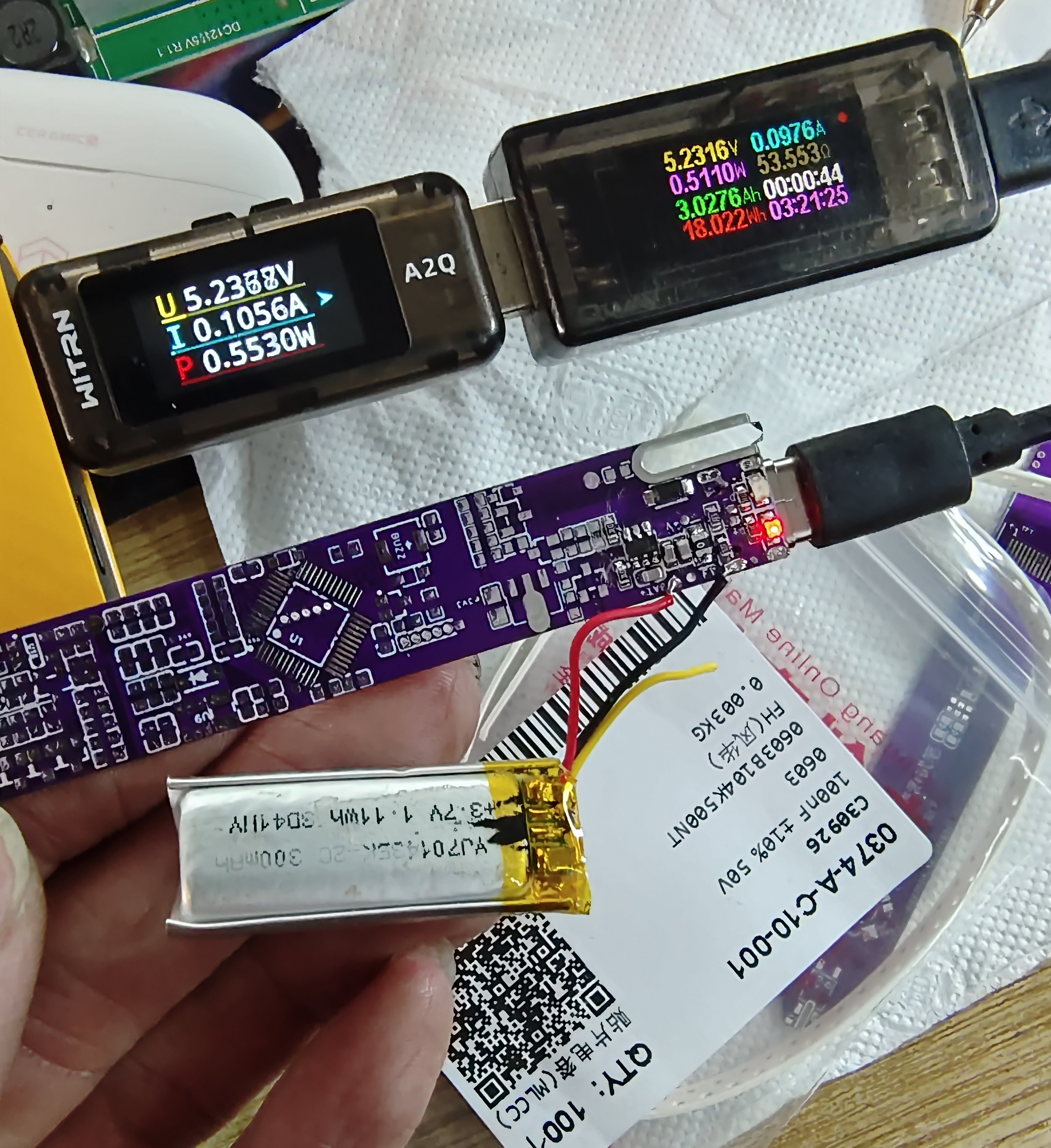

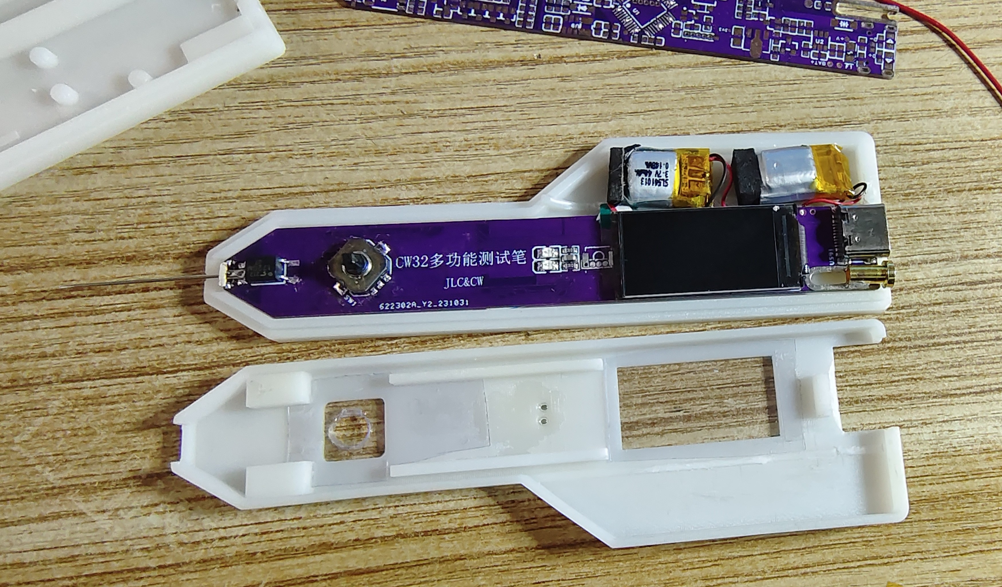

7. After opening the case, I realized the original battery wouldn't fit. I found a few old Bluetooth headset batteries, charged and activated them, and got two with normal voltages and protection boards, which I directly connected. I gave the case a physical battery compartment so that if there are any extras, I can cut them off later if needed.

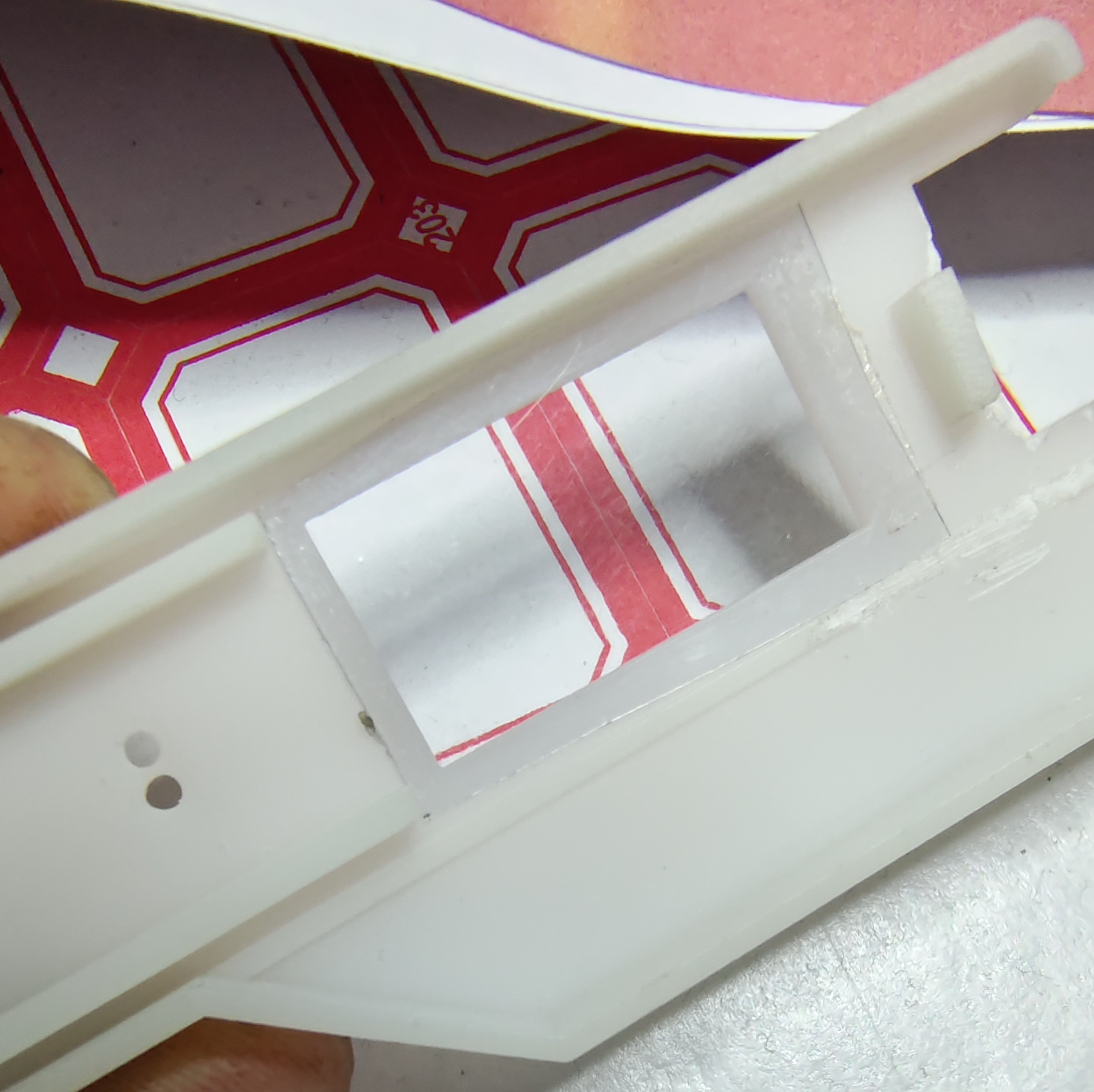

8. I added a layer of film to the screen window of the top case as a protective layer. I enlarged the LED light hole and used UV glue to attach it. The actual effect is good. A black case would be even better.

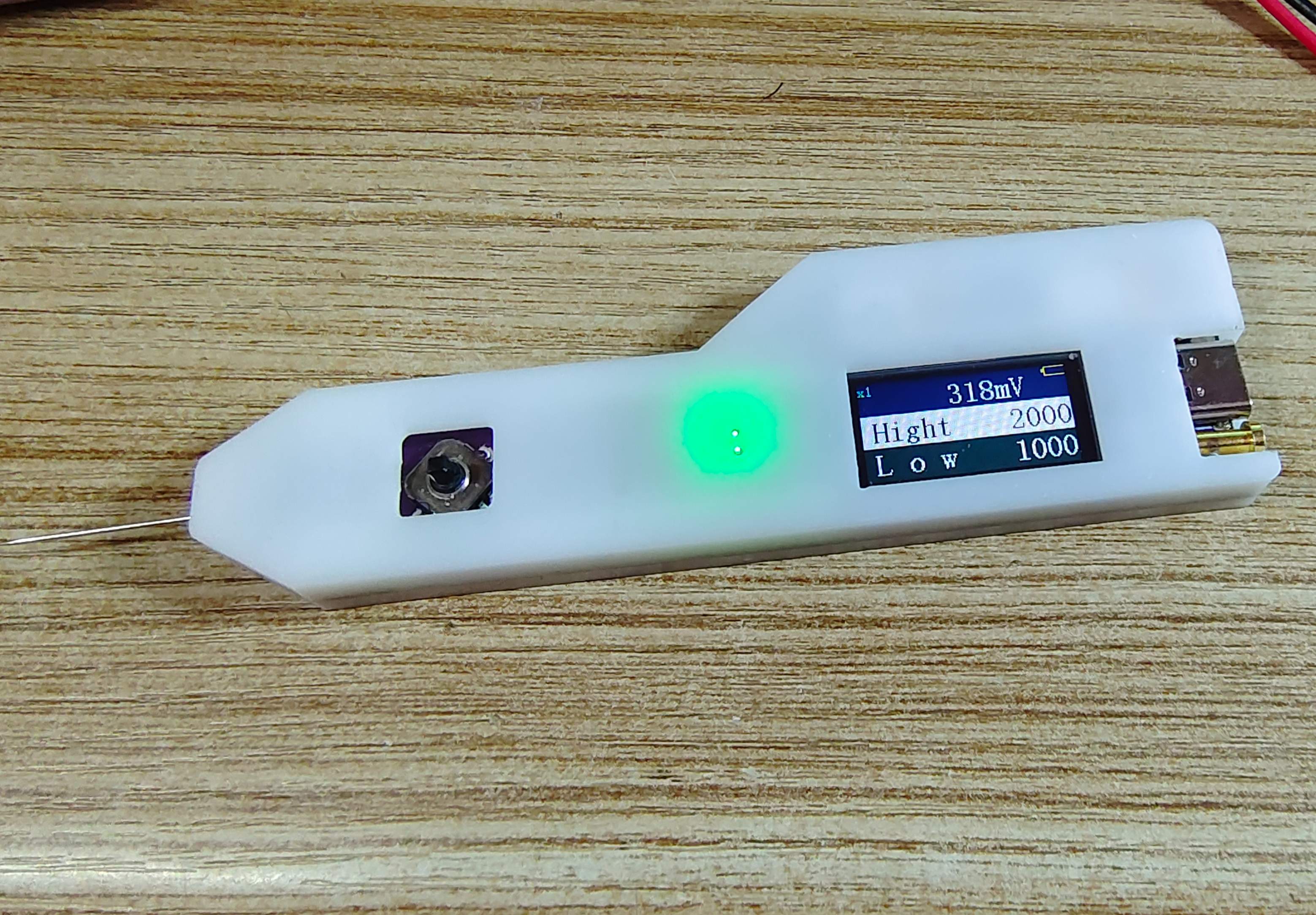

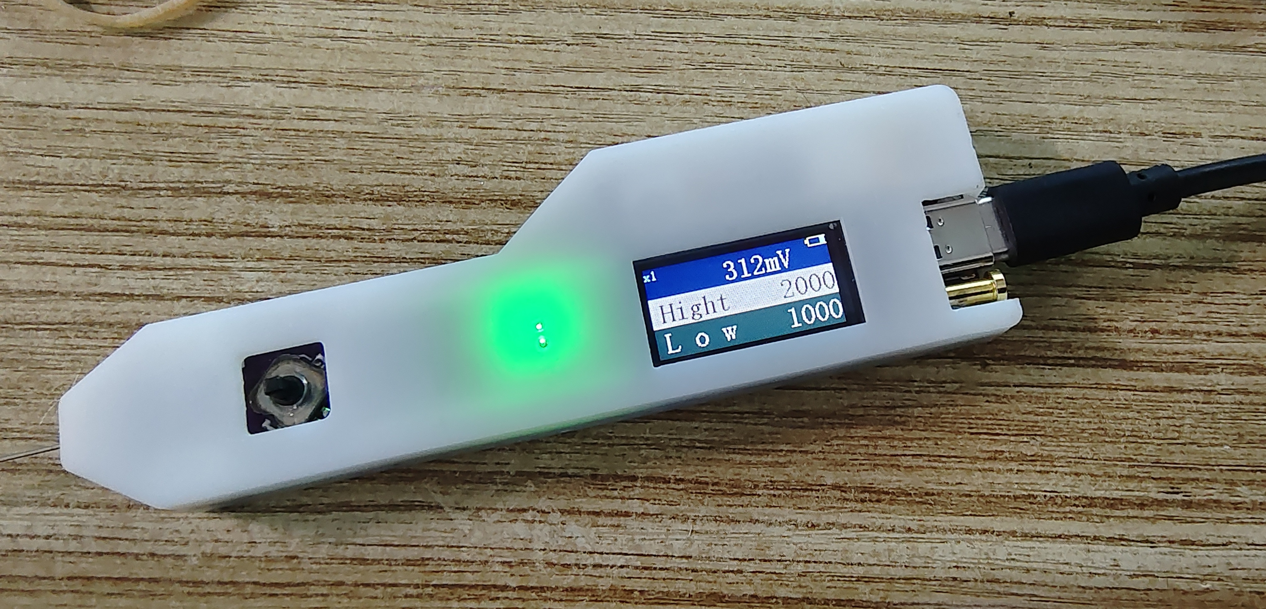

9. Overall appearance: the green light is quite bright. When you get close, you can see the green light from both holes, and the white case has a bright ring around it...
10. Fixed the screen display code.
