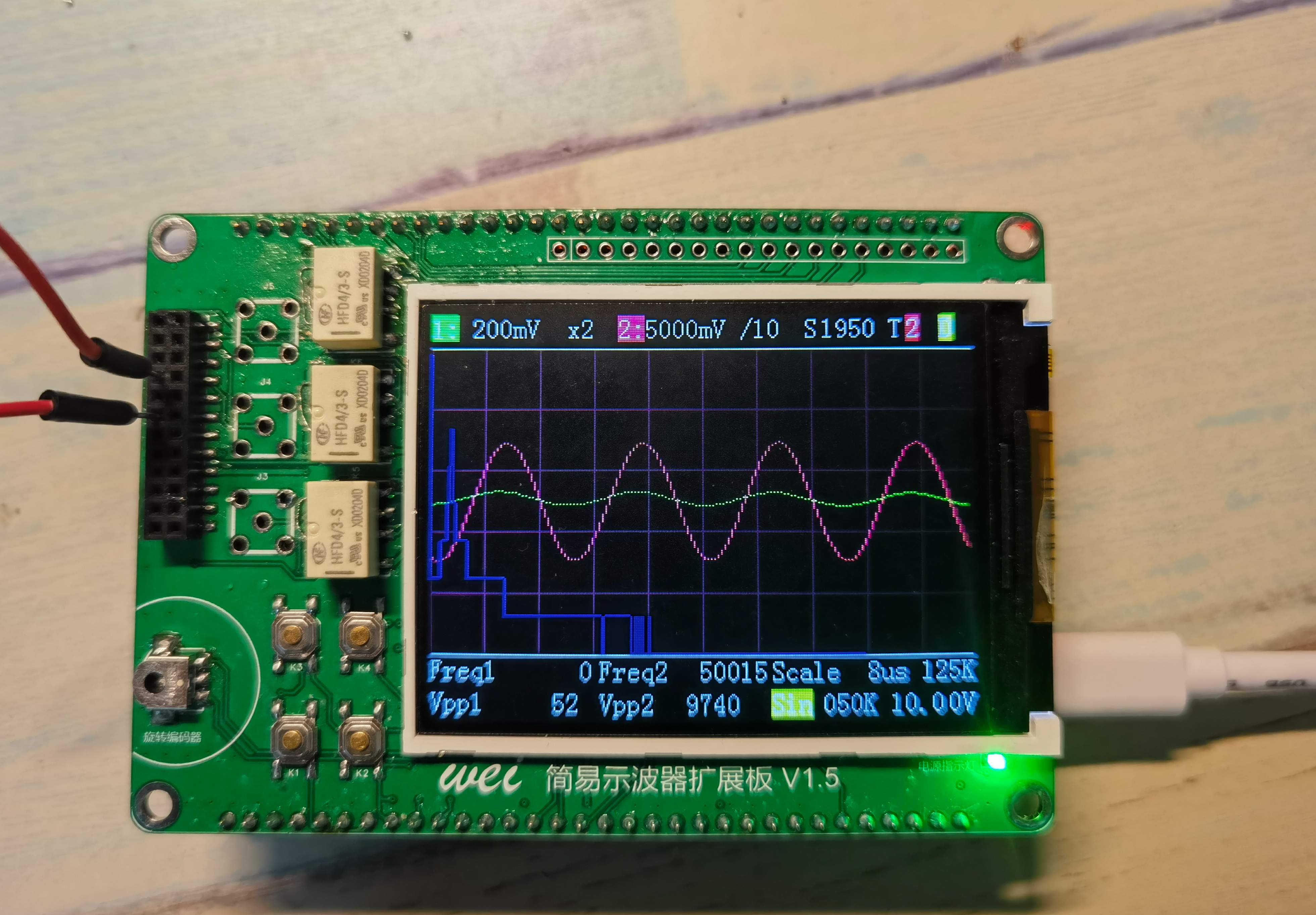

A Simple Digital Oscilloscope Based on STM32H750
The
oscilloscope implementation requirements are:
±10V dual-channel 2M sampling rate or higher, 20k bandwidth
sine wave peak-to-peak measurement error no greater than 5%,
range switching function (switching control method is not limited)
, stable triggering, no obvious slippage
frequency measurement error no greater than 5%
, ±4V 20k output, square wave, triangle wave
, sine wave, and sine wave peak-to-peak error no greater than 15%.
This
project is based on the STM32H750 core board from Hardwood Classroom. For secondary development and design, attention should be paid to the I/O port allocation.

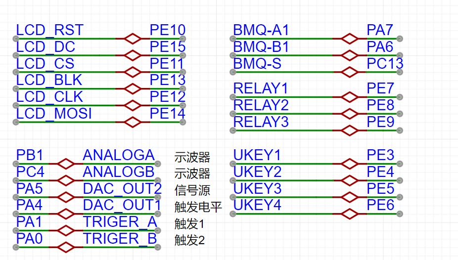

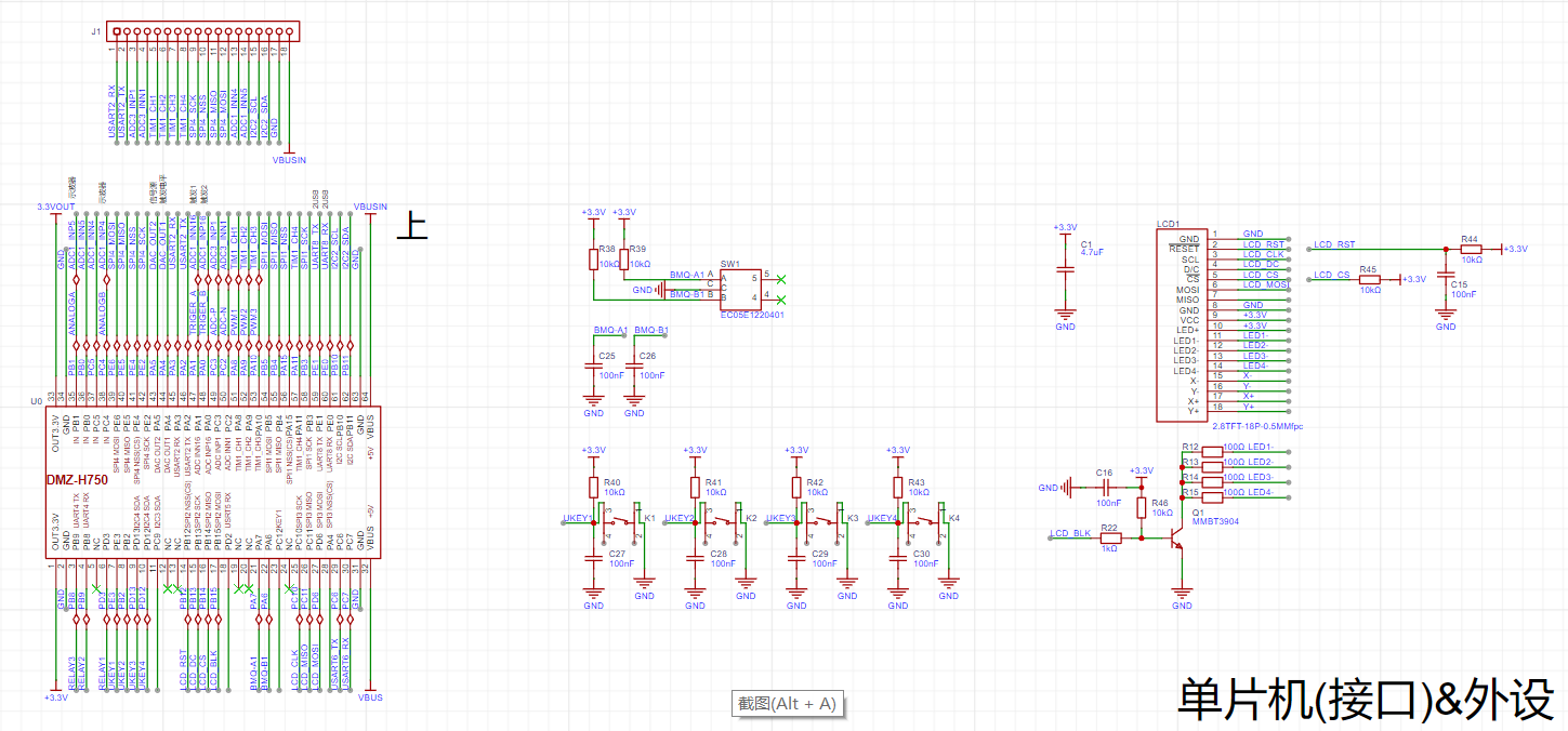

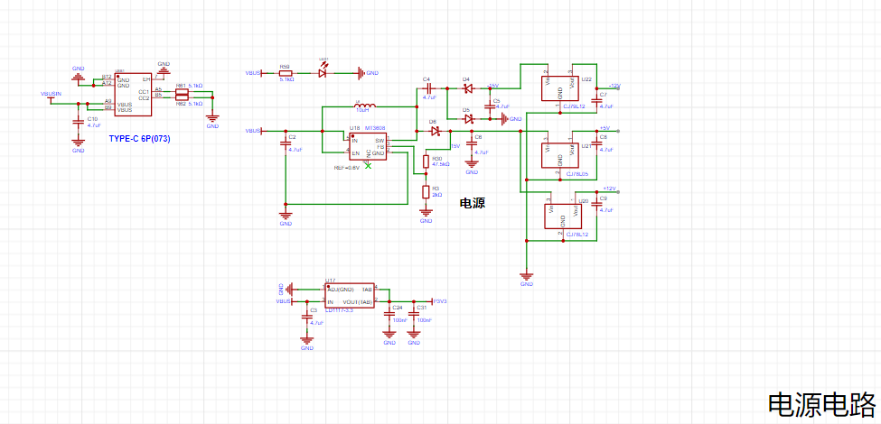

The schematic diagram design should explain
the specific allocation of the microcontroller's I/O ports and peripherals.
The following two figures show the power supply design. This design uses a 6-pin Type-C interface for power supply.
Note: When soldering the power supply section, pay attention to the pin network allocation, especially the selection of the three LDO models, otherwise there is a risk of smoke. Also, the power supply section is isolated from other parts. When soldering the power supply section, be careful not to have cold solder joints; check it first, and continue only after confirming there are no errors.

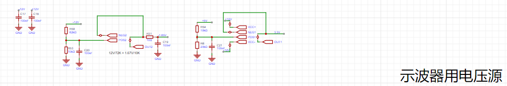

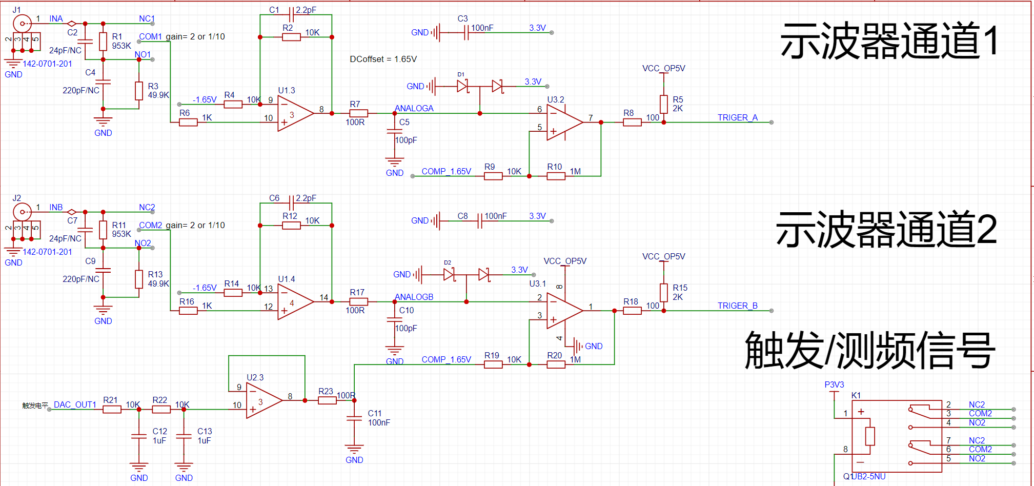

The following is the detailed design of the two input channels of this oscilloscope. For a better understanding of the principles, please refer to the open-source project on Hardwood Classroom. Here, I'll share some issues you might encounter:
1. During the project, most people choose to directly copy the schematic from Hardwood Classroom. This results in numerous op-amps appearing when updating the PCB (a chip only uses one of the four channels). I suggest deleting the original op-amp and placing it separately.

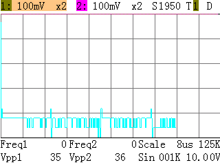

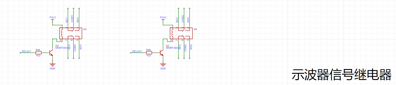

2. I also encountered some issues with the relay section in this project. Early on, I didn't fully understand the functions of each part of the schematic, leading to incorrect pin placement for the NO and NC networks of the three relays. This resulted in the finished product failing to input and output signals correctly (the problem was finally solved by using jumper wires).
3. The finished product may have a VPP value greater than the input voltage by 10V. You can try removing all the NC capacitors from the two oscilloscope channels.
4. Be restrained in using flux during soldering. Use it only when necessary; don't blindly apply a lot of flux to the pads, as this can cause short circuits. After using flux, clean it with a brush, or use board cleaner to clean the board. This makes it cleaner and easier to observe other components.
5. This project has verified that if problems occur, soldering issues account for 90%. Then check your schematic for errors
! I suggest drawing your own schematics, not acting as a CV engineer. Try to understand the principles of each part during the drawing process; this will greatly improve the efficiency of debugging and troubleshooting later.

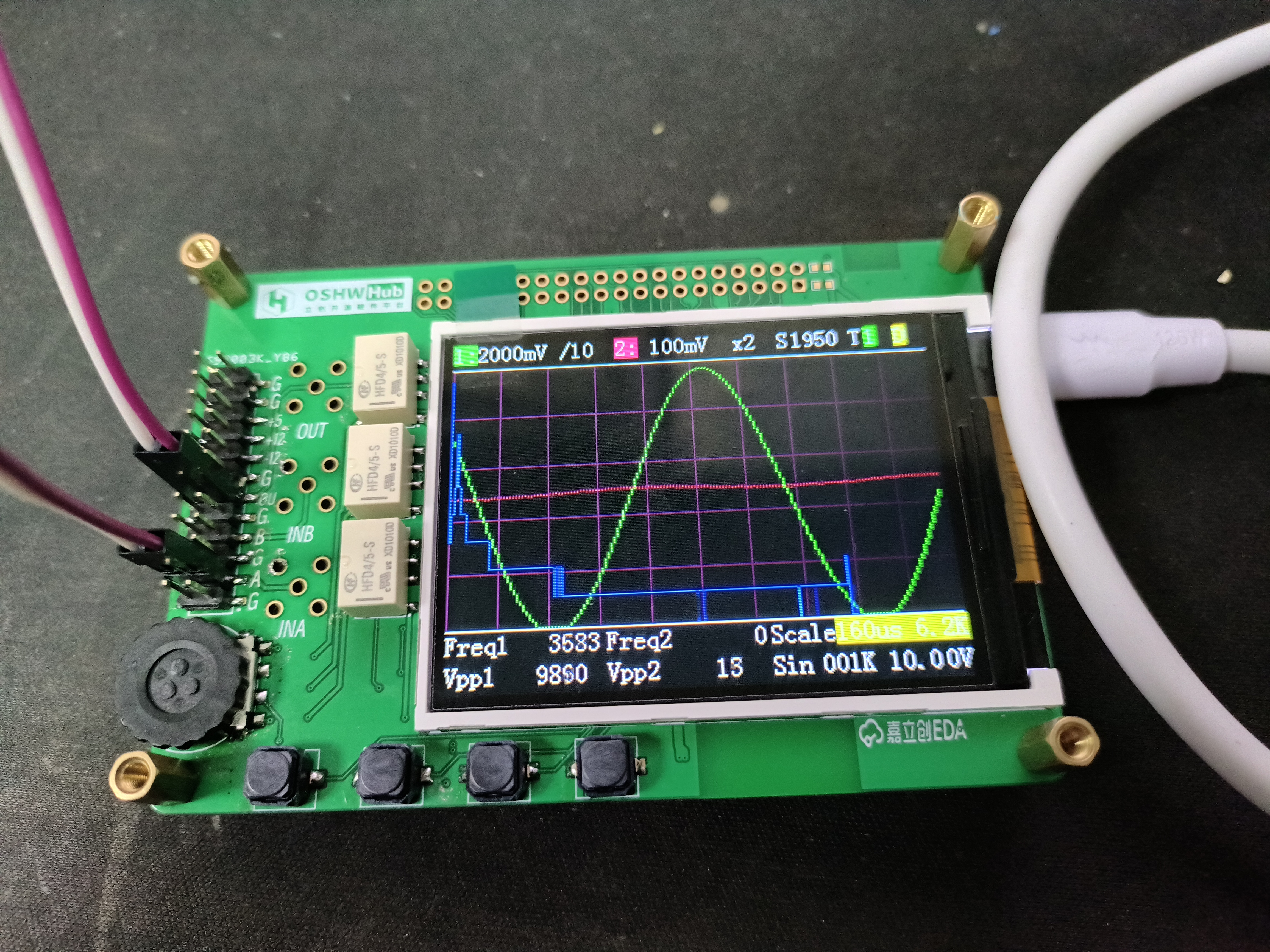

Using the STM32H750 as the main control chip, this system implements the functions of a dual-channel oscilloscope and a single-channel signal generator.
Top view ,
bottom view,
square wave,
sine wave
, triangle wave

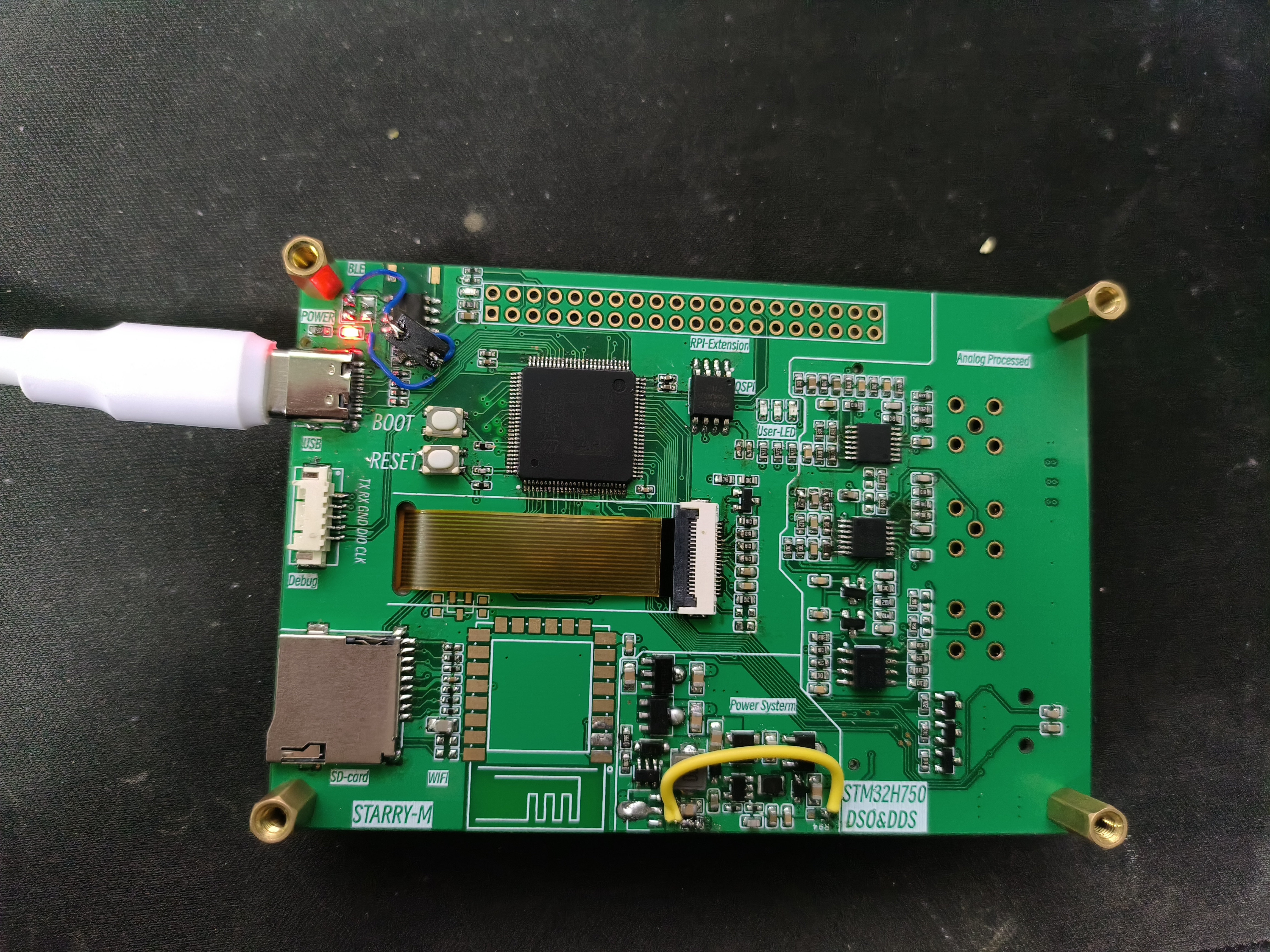

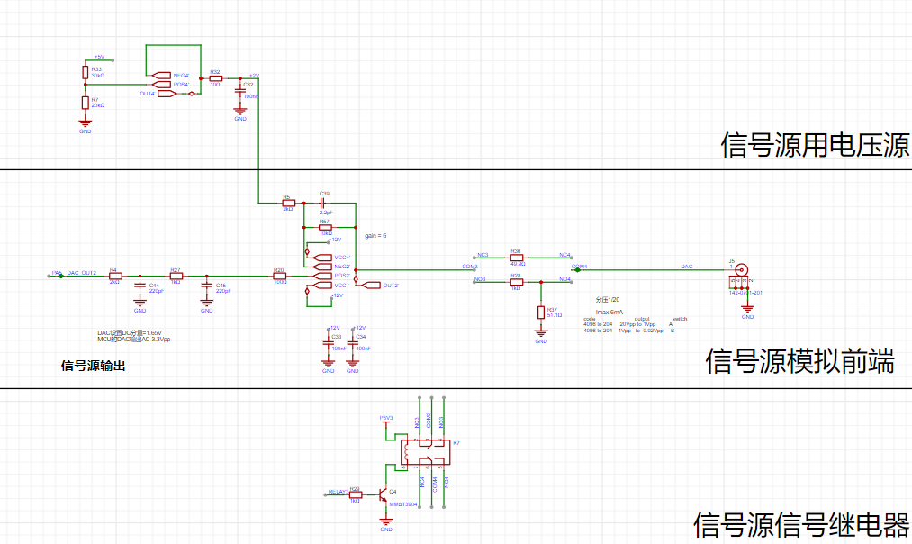

DSO and DDS based on STM32H750
The MCU is integrated with the oscilloscope, DDS analog front-end, power supply, etc., and features such as TF card, WIFI, and Bluetooth are added.
Preface to a Simple Oscilloscope and Signal Generator Based on STM32H750
I've always wanted to build a simple oscilloscope to fully learn the hardware and software development process. Last month, I was fortunate enough to see this training camp held by LCSC and excitedly participated.
Although I was too busy with work to rewrite the software design from scratch, I gained a lot in hardware design. I'm setting a goal here to definitely complete the software design of an oscilloscope myself.
Hardware Circuit

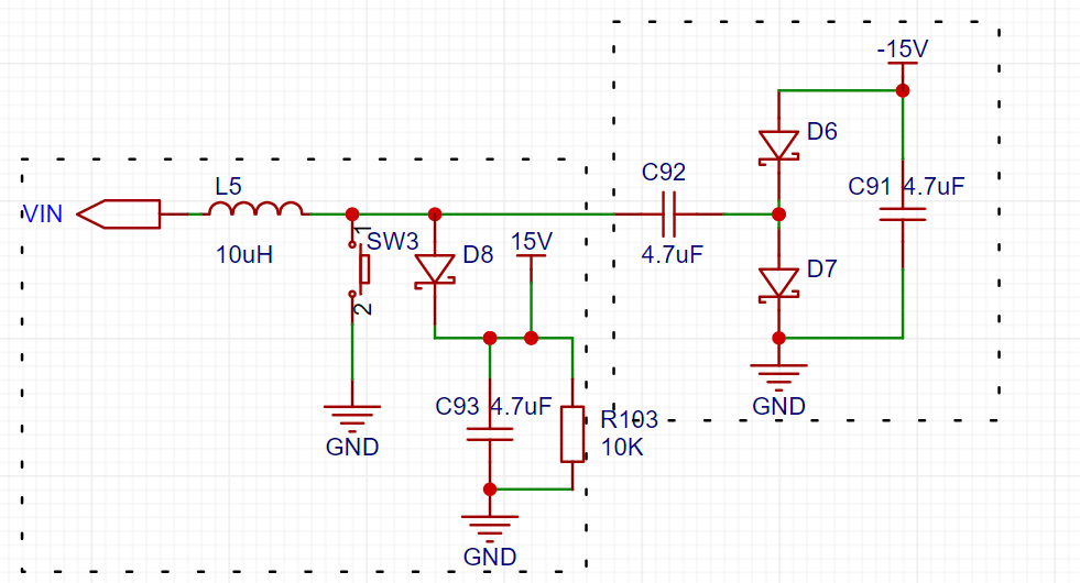

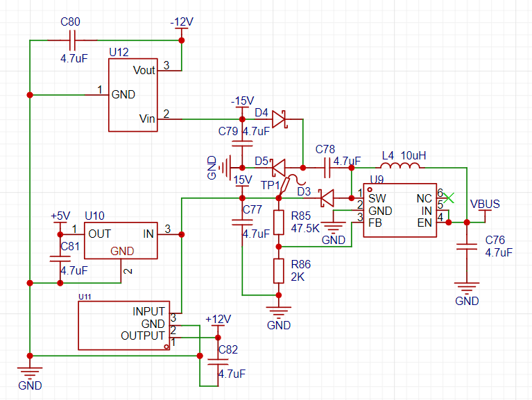

Because this is a simple oscilloscope, all the examples in this training camp are only small-scale signal input detection. The hardware circuit has been greatly simplified. However, I believe that a deeper understanding of this hardware circuit, and the ability to apply the knowledge to other situations, will definitely enrich our circuit knowledge. The

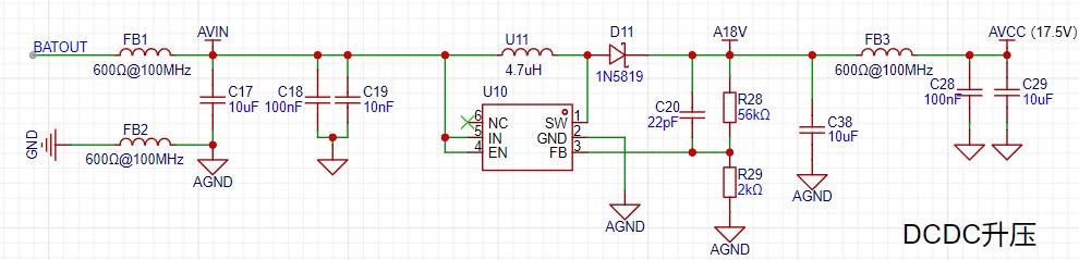

positive and negative power supplies for the op-amp section are provided by this part.
We are all familiar with the MT3608 BOOST circuit, but adding two diodes and two capacitors to generate a negative voltage is quite advanced. Currently, it's too messy, so the circuit has been simplified. The circuit shown in the
left box is a simplified BOOST section, which will not be analyzed here. Let's look at the circuit in the right box. Because the high-speed switching of the switch on the left side turns the power supply on the left side of C92 into a pulse signal. When the signal goes from low to high, the capacitor C92 charges (left +, right -). When the signal goes from high to low, the left side of C92 becomes 0 volts, but the voltage difference across the capacitor cannot change abruptly, causing the voltage on its right side to become -V. This allows the current to flow through GND->C91->D6->C92->GND. The final result is that the voltage at the positive terminal of D6 is a negative voltage slightly higher than -V.
Later, when I searched for relevant information online, I found that the structure of the block diagram on the right is a typical charge pump circuit, where energy transfer relies on the voltage difference of the capacitors. Because the current that can be provided is generally relatively small, around tens of milliamps, it is usually used as a power supply for simple op-amps.

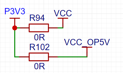

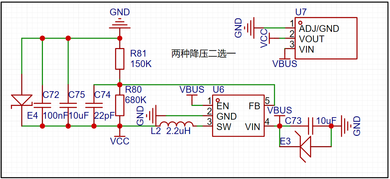

This is the 3.3V power supply of my system, which includes both the switching power supply and the LDO. In actual soldering, I only soldered the switching power supply.
In my initial version, I only made a jumper to 3.3V for the signal relay power supply, but the signal relay I bought was a 5V power supply specification, which was a careless oversight. Therefore, two power supply options were added here.

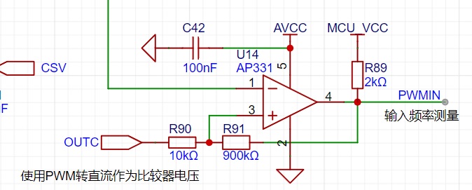

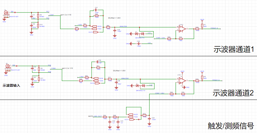

The official documentation for the oscilloscope's analog front-end clearly explains attenuation, gain, DC bias, and comparator triggering.

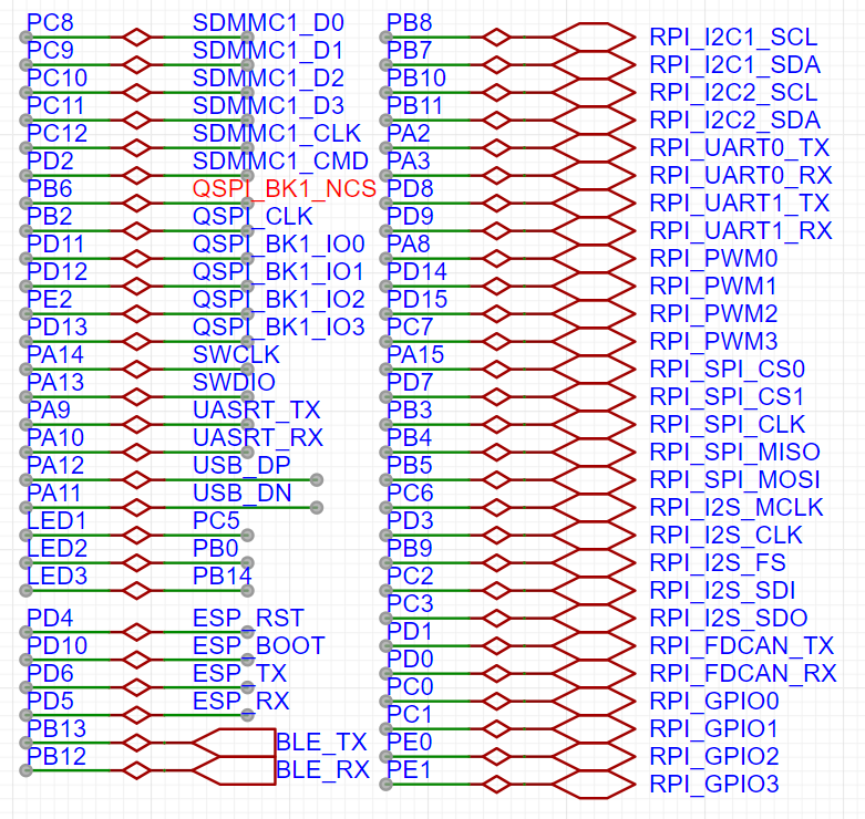

Currently, the STM32H750VBT6 chip costs only around 20, so I chose to integrate the chip directly without borrowing a development board. Also, considering that the DSO, DDS, LCD, buttons, and relays don't use many pins, it would be a waste to leave the remaining pins unused. To increase its versatility,
I added some peripherals to the board, such as a TF card for expanding waveform capture functionality; QSPI for external FLASH; and KT6368A Bluetooth and ESP8266WIFI for remote control and display. For the remaining pins, I chose the Raspberry Pi expansion interface, which has the most compatible modules, allowing for easy direct connection of various modules. To simplify layout and routing, I modified some interface pins
in the software ; the modified pins are shown below. For ordinary I/O, only the pins need to be modified. It's important to note that when modifying SPI, the priority of the SPI transmission interrupt and DMA transmission interrupt should not be too high, otherwise, a freeze may occur. Regarding saving waveforms on the SD card, I initially planned to save the waveforms as BMP images, as shown in the screenshot taken at the beginning. However, when I tried to take screenshots during runtime, it froze. I currently suspect this is due to the blocking mode used for writing and reading from the TF card, which is frequently interrupted by the ADC interrupt. I will try switching to DMA mode later. This function is not yet complete. The flying wire in the lower right corner is related to the relay power supply issue mentioned earlier (already modified in the PCB). The flying wire in the upper left corner is because the 3225 package crystal oscillator I purchased cannot power the Bluetooth chip, so I used the included 2-pin crystal oscillator for testing. Later, there is a video showing the ADC DMA buffer data being uploaded to the VOFA+ display via the Bluetooth transparent serial port. The ESP8266 is not yet soldered because I am still learning about network-related operations and knowledge. Once I learn, I will complete this part and create some fun functions. That's about it for now, a summary of my progress in participating in this training camp in my spare time. The code is on GitHub; feel free to follow it if you're interested. I will update it if new features are developed (if I have time). https://github.com/starry-m/H750_ADCDAC.git Future Plans and Ideas Functionality Completion Status Screenshots (To be completed ) Host Computer Display and Control (Bluetooth) (To be completed ) USB Simulated USB Flash Drive Firmware Upgrade (To be completed) WIFI Control (To be completed ) Although I'm still far from my goal of building a complete oscilloscope, this training camp experience allowed me to go through the design and drawing of hardware circuits, which is not bad. Problem Log The downloader can run after downloading, but the screen does not display after resetting and powering on . Solution: It should be due to unstable power supply during startup; a 1-second delay before startup resolves the issue and allows for normal display.

Photos of the soldered PCB:
The soldering order for the H750 core board was: first solder the Type-C interface and power supply; after testing the power supply and confirming it was working, then solder the STM32 main unit and peripheral circuits; after testing it again, write the main program; the third step was to solder the LED screen circuit, then test if the screen lit up; after it lit up, solder the other peripheral circuits and pin headers! The test passed completely!
The expansion board also started with soldering the power supply circuit; after testing and confirming it was working, soldered the other components!
Here's a pitfall to note regarding the expansion board's power supply section: the FB pin feedback circuit of the MT3608 must be correctly connected; otherwise, it will burn out the MT3608 chip upon power-on testing, causing a short circuit in the entire power supply circuit! I initially bought only one 3608 diode, then bought ten more. After using half of them and repeatedly disassembling and testing the peripheral components, I finally found the cause: I don't know if the D6 transient suppression diode from the original official project was faulty, or if the component I bought was faulty. This diode wasn't labeled with positive and negative terminals, and I might have connected it backwards, causing the feedback circuit to fail and burning out the chip!
Later, I tested D4 and D5, and the circuit using the same diode at -12V also didn't work properly. I replaced D4, D5, and D6 with SS34 diodes, and the circuit worked normally!
Regarding the core board, I initially didn't notice and bought a common cathode RGB LED from the 3528. After replacing it with a common anode LED, it lit up normally! Please be careful not to make the same mistake!
Assembly test photos:
Program writing:
There's not much to say about the program part. I used the original official program, installing KeilMDKARM5.35 and STM32H750 from the pack provided in the group file, version 2.7.0.
Because the official H750 pin header connectors PB8 and PB9 were incorrectly labeled, I didn't notice this when designing the core board, so these two pins were reversed. I modified the pin definitions during compilation, and it compiled successfully!
The modified relay.h file is shown in the image.
Since this H750 core board includes a USB interface, flashing the program was relatively simple. Open the STM32CubeProgrammer software, connect the core board to the computer using a Type-C data cable, press and hold the Boot button to power on the core board, adjust the USB connection in STM32CubeProgrammer, and then open the compiled DAC.hex file to download and flash the program.

A Young Person's First Oscilloscope [LCSC Training Camp] Oscilloscope Expansion Board Designed Based on Hardwood Classroom H750 Core Board_Bilibili_bilibili
The four capacitors for the signal input can be removed. C2, C3, C5, and C7 are two 24pF and two 220pF
capacitors. It's best to choose a different package for the signal relay; the relay I purchased is significantly larger. Also, it's best not to place the signal relays side-by-side, as it causes significant difficulties during soldering.
Adding some test points can improve testing (I've seen many problems with this in the training camp).
Try adding a reset button and a power switch; this would be much more convenient (or provide a via for pressing the reset button).
It's best to replace the selected encoder, as it's quite expensive. Consider replacing it with a plug-in encoder or a cheaper one. The encoder's button can also be utilized to replace a physical button.
The spacing between the SMA connectors can be increased; even a slight misalignment makes them difficult to screw in (SMA connectors can have their signals soldered first, while GND connectors are too large to solder easily).
The position of the surface mount female connectors can be repositioned to accommodate BNC sockets between boards. Converting SMA to BNC is quite complicated
. Some holes in the 3D template are designed to reduce errors in PCB design and can be reduced as needed.
V1.1 The relay package has been modified, but the spacing is too small, which can easily cause problems.

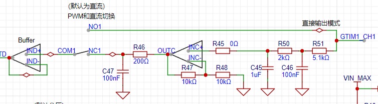

  2. PWM and DC Output:
        Supports direct PWM output with adjustable frequency and duty cycle. The PWM signal is filtered before being used as the DC output, with a DC output voltage of 0~+6V. The DC output also serves as the reference voltage for the comparator, used for the oscilloscope's trigger level and frequency measurement.

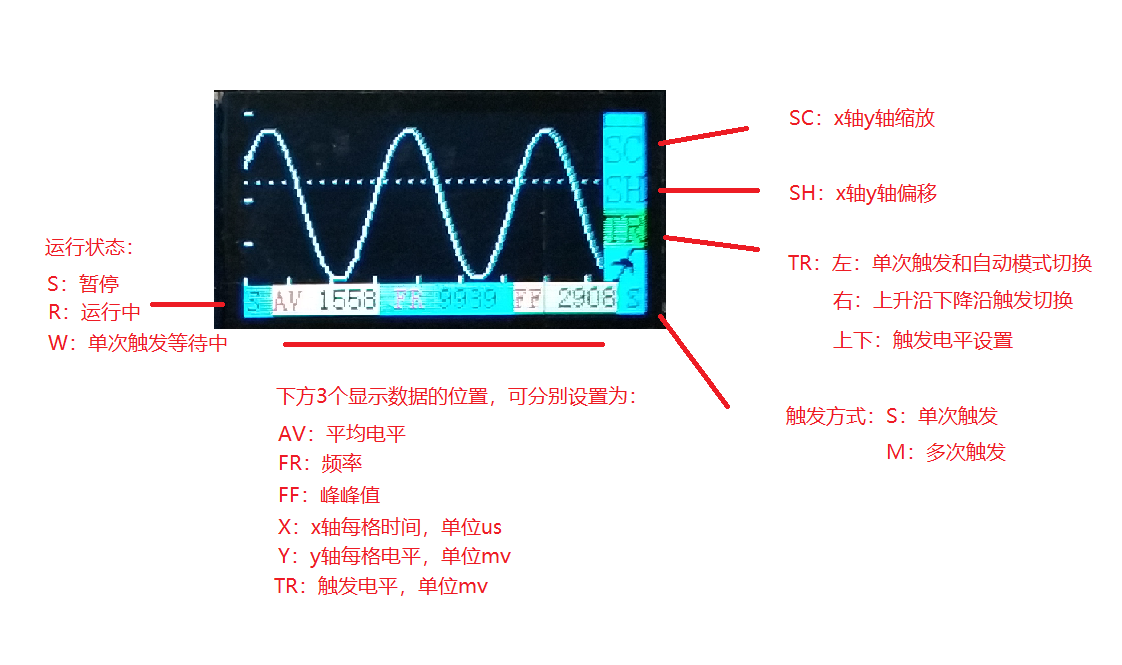

      : Oscilloscope Menu Explanation: SC, SH, and TR on the right are the control menus. The three middle positions at the bottom display data, and the single letters on either side indicate status.
  SC: When SC is selected, pressing the middle button highlights SC in green. The up and down buttons control the waveform's scaling on the y-axis, and the left and right buttons control the waveform's scaling on the x-axis, controlled by the ADC clock frequency.
  SH: When SH is selected, the waveform can be moved along the x and y axes.
  TR: When TR is selected, the up and down buttons set the trigger level, the left button sets rising and falling edge triggering, and the right button sets single and multiple triggering.

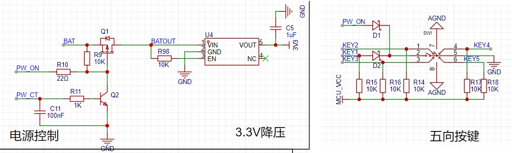

  1. Power
    On: Press the middle button, PW_ON is pulled low, Q1 conducts, BAT supplies power to the buck chip, the main control chip powers on, the pin connected to PW_CT is pulled high, Q2 conducts, the green light illuminates, and the middle button can be released to complete the power-on process.
    Power Off: Press and hold the middle button for 2 seconds, the PW_CT pin is pulled low, Q2 is cut off, release the middle button, Q1 is cut off, and the power-off process is complete.

    The analog switch chip HT4053A used for boost is 18V. To allow for some margin, the system voltage is designed at 17.5V, using MT3608 for boost. When laying out the PCB, pay attention to the isolation between analog ground and digital ground,
    the inductor should be close to the chip, and the feedback circuit should be away from interference sources.
  3. Output Circuit
      : There will be a voltage drop when the PWM filter is converted to DC. After being amplified by 2 times by the amplifier, the output is 0~+6V, and then after a first-order filter, it is output or directly fed into the comparator.

      The DC output of the comparator circuit serves as the re
参考设计图片
