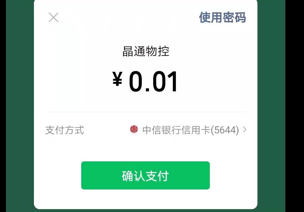

[Please fill in during the registration stage↓] * Brief introduction to the work: By scanning a specific QR code and paying a certain amount using WeChat, the corresponding device will run for a certain period of time. The device can be paused during operation and execution can be terminated. And record the bill, the balance will still be available next time you scan the QR code.

**3.1, ** The hardware part uses ESP8266 as the main control chip. There is no other MCU. Three FJ11001BH digital tubes display the remaining time, and five LEDs display the network and working status; **3.2, ** Use WeChat To pay, scan the QR code of the device and pay a certain amount to purchase the corresponding remaining time. Each time the remaining time is used, the corresponding time will be deducted and the remaining time will be available next time; **3.3, **MQTT is used between the device and the server Protocol, WEBSOCKET is used between the mobile page and the server; REDIS is used between THINKPHP and SWOOLE;
