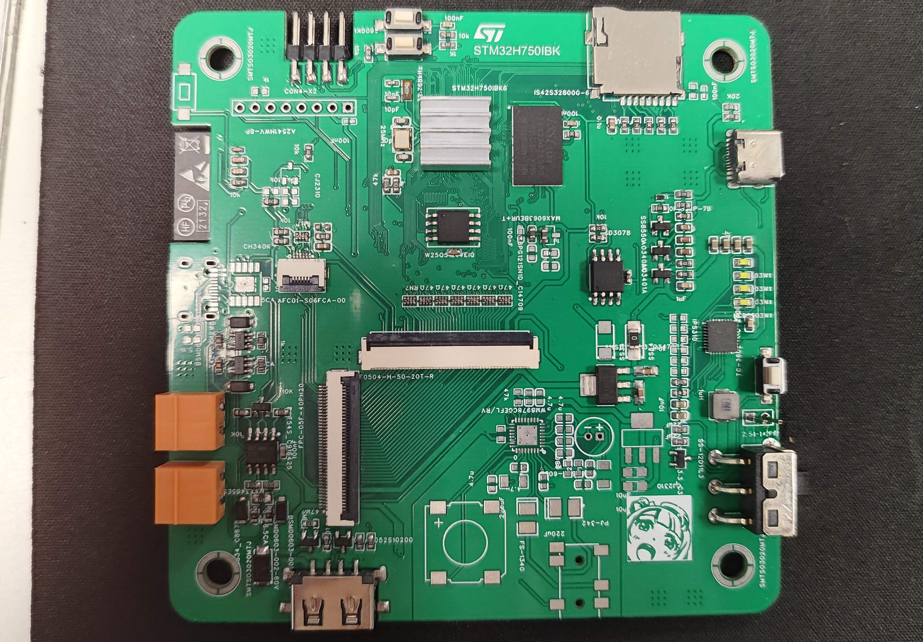

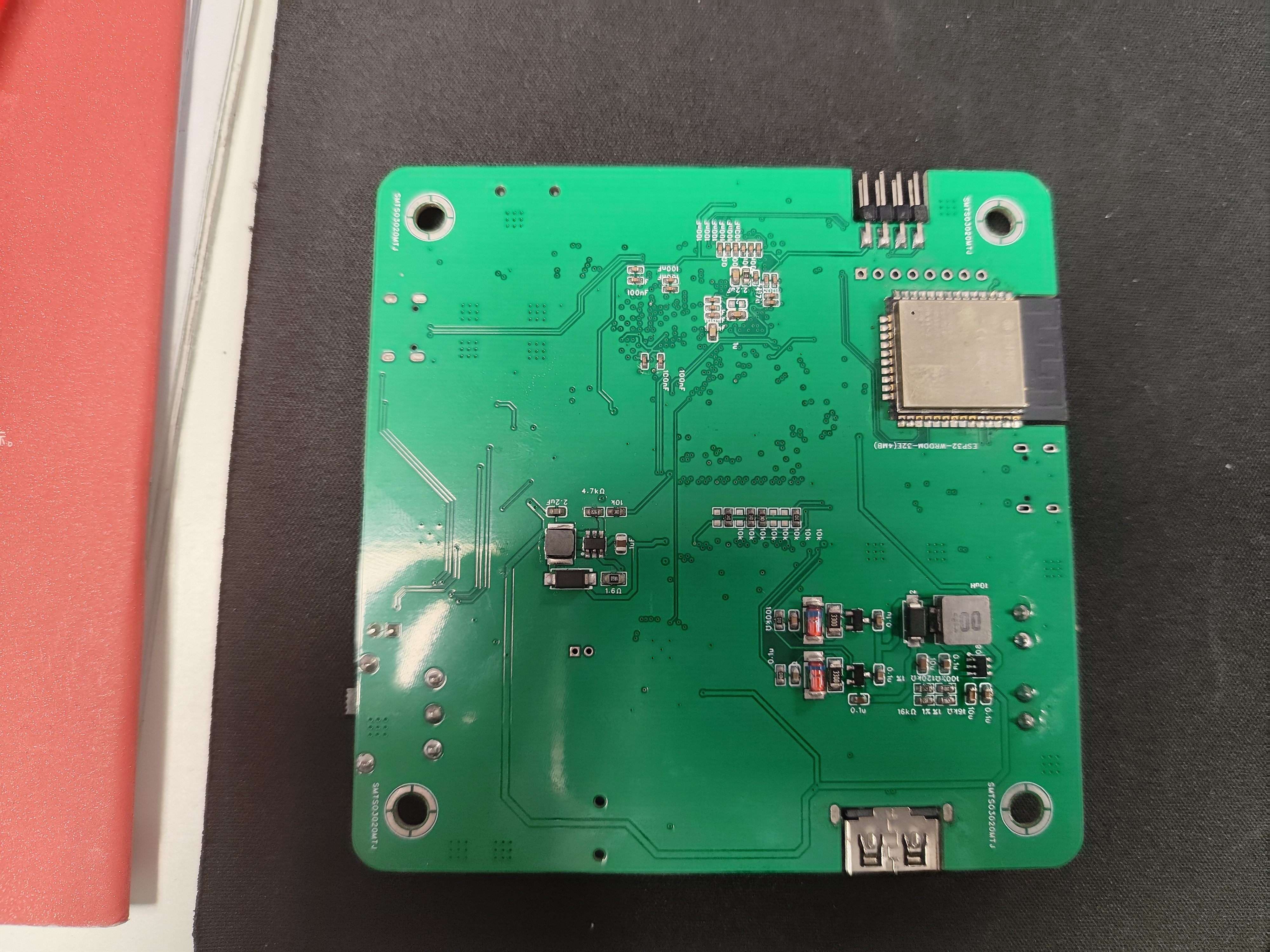

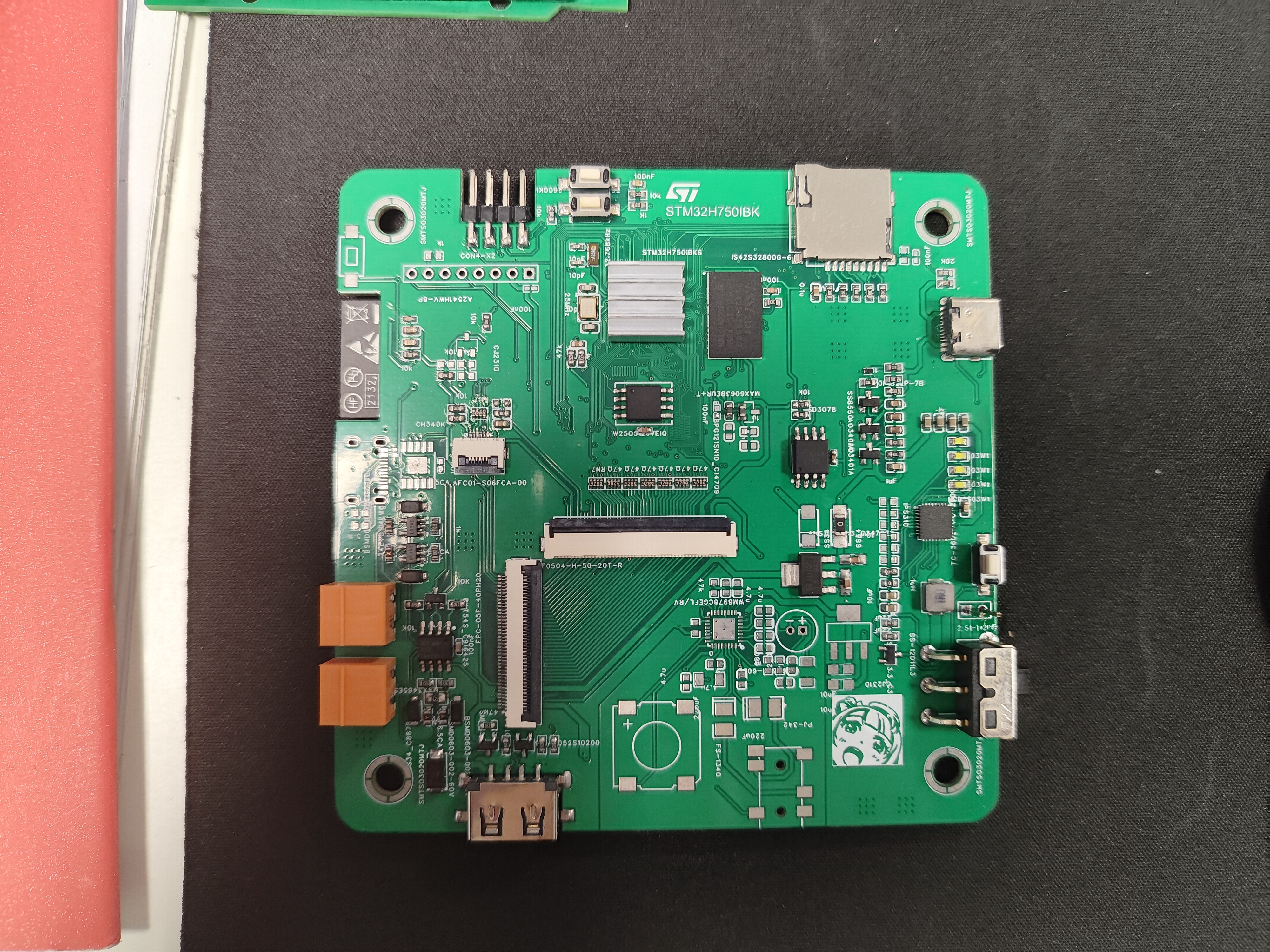

STM32H750IBK6 Development Board
**Highlight:** Achieving the remarkable feat of using only 4 layers of board while maintaining an extremely small BGA pitch of 0.65mm for the MCU, resulting in a fully fan-out (NC 1 Pin) configuration! (Signal integrity not guaranteed.**
![1700123650608.jpg] ![1700123650603.jpg]
The peripherals of this project are:
Clock: 24MHz HSE, 32.768KHz LSE, SD3078RTC chip
; Memory: 32-bit wide SDRAM, QSPI interface; FLASH;
Communication interface: SP485, 5V SPI (Transmit only), **USB-A (unverified, only 5V power supply control verified)**, USB-C, TF card slot
; Audio: **WM8978 (unverified)**
; Wireless: ESP32-WROOM-32E (equipped with a USB to serial chip for firmware burning)
; Power supply: IP5310 **(requires a 3.7V lithium battery for normal operation)**;
FPC interface: RGB50Pin (can be directly connected to common 50Pin FFT LCD panels, the board has built-in screen driver), FANKE RGB40Pin **(Incompatible with Zhengdian Atom)**, TouchPad6Pin (IIC interface with built-in external pull-up).
My implemented project file is: [GitHub - KotoriProject/STM32H750_USBdfu_BOOT: USB DFU BOOT based on STM32H750, which realizes reading and programming of 750's FLASH and external W25Q64 through STM32CubeProgrammer's USB interface](https://github.com/KotoriProject/STM32H750_USBdfu_BOOT)
