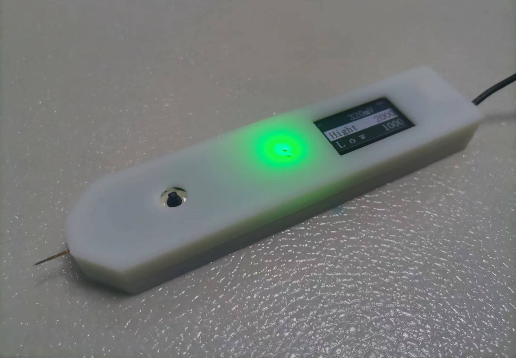

This project involved building a CW32-based multi-functional test pen,
based on the schematic diagram provided by Engineer He from the training camp. Several components and circuits were modified. Specifically:
1. The LDO chip in the 3.3V voltage regulator circuit was replaced with an RT9013
. 2. Only the pull-up resistor was retained in the five-way rocker switch circuit; the filter capacitor was removed.
3. Some modifications were made to the display backlight circuit.
4. The board size was slightly increased by 4mm; the original width was 14mm, which was increased to 18mm, while the length remained 100mm.
The casing was designed using LCSC EDA.
The following is a picture of the actual product.
Due to cost considerations, the Bluetooth chip, antenna, LED lighting, and buzzer were not soldered.
