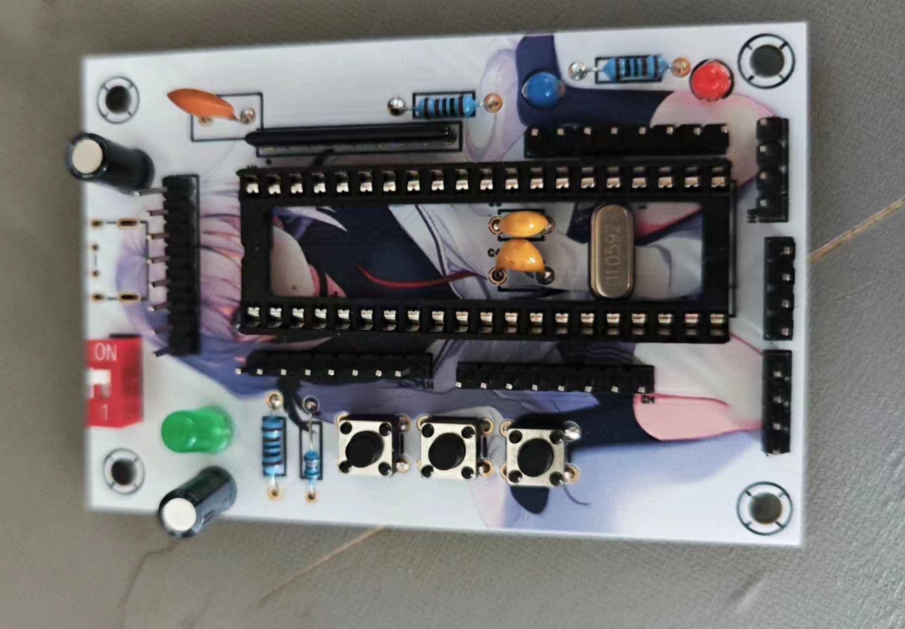

Looking back, my first development board was the 51 microcontroller. It successfully opened the door for me to learn microcontrollers. Today, I'm taking this opportunity to build a 51 development board. This board uses a fully through-hole design, making soldering easy. It also has very few components, making it easy to learn both PCB design and development board learning – a truly ingenious tool for beginners. Interface Simplified
Instructions:
[Image of the board]
Soldering Instructions:
Regarding LEDs: The longer lead of the LED is positive, and the shorter lead is negative. When soldering, align the longer LED lead with the end marked with a plus sign on the pad, or align the shorter lead with the end with a notch on the pad.
Regarding electrolytic capacitors: Similar to LEDs, the longer lead is positive, and the shorter lead is negative. Align the longer lead with the end marked with a plus sign on the pad
. Regarding resistor arrays: Align the end of the resistor array with the end marked with a white dot on the pad. [
