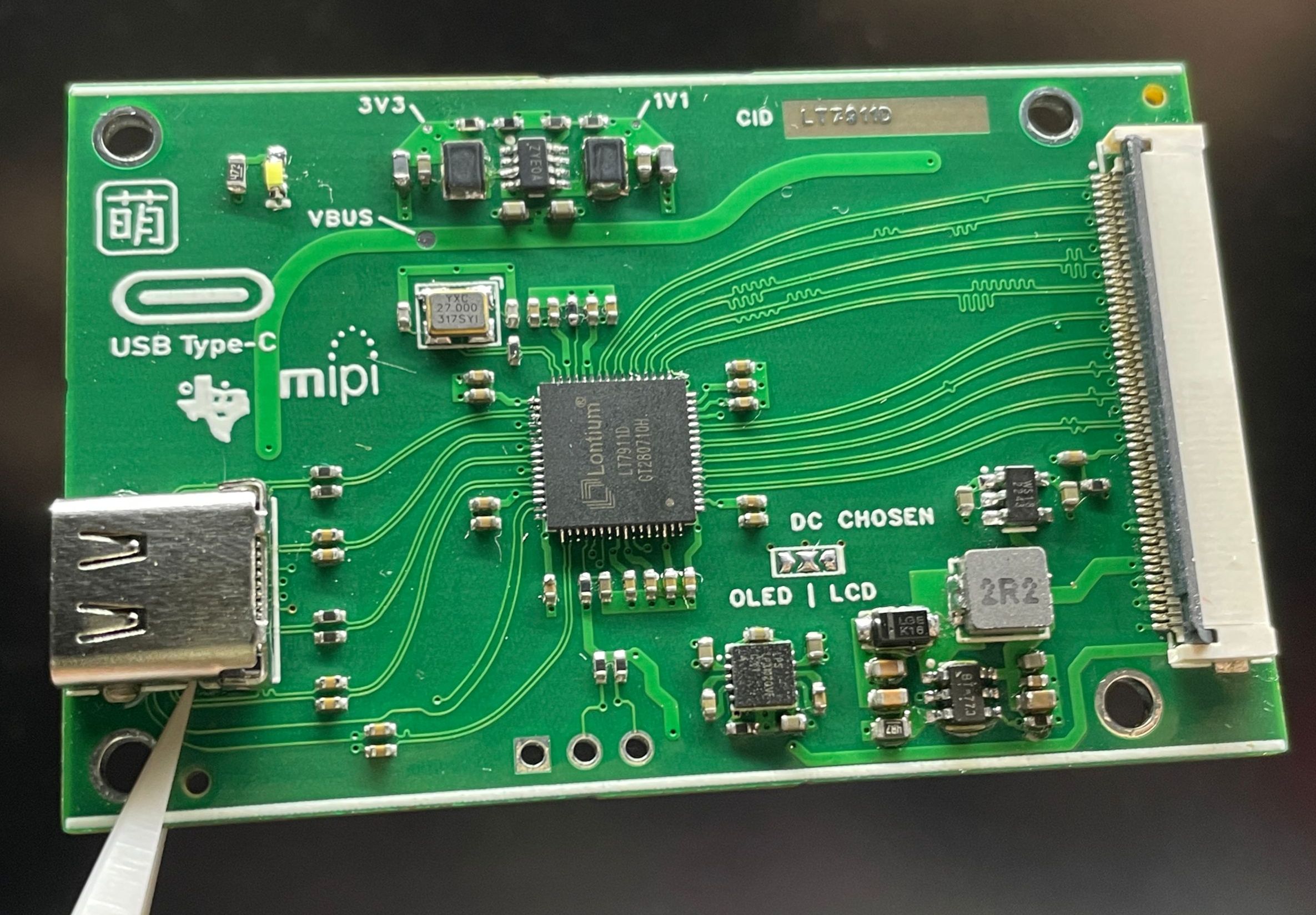

LT7911D MIPI Development Board
Longxun LT7911D MIPI Development Board
[Commercial Use Prohibited] [Adjustable Resolution]
[Supported Devices (Tested): PC, Raspberry Pi, etc.]
[Unsupported Devices (Untested): Switch]
Updated to V1, supports EDID name renaming
- Future Updates:
Planned support for
image sets (some are older images)
Notes
- 1. Requires a USB to I2C adapter for downloading. Refer to:
LT6911C Burning Instructions for detailed download steps.
- 2. The [J4] pad is used to adjust the LCD backlight driver or LCD positive/negative voltage backlight driver:
     Default uses LCD backlight driver, jumper to the right.
- 3. Currently compatible screens:
[Amelin] [Discontinued]
[LT089CL02]
