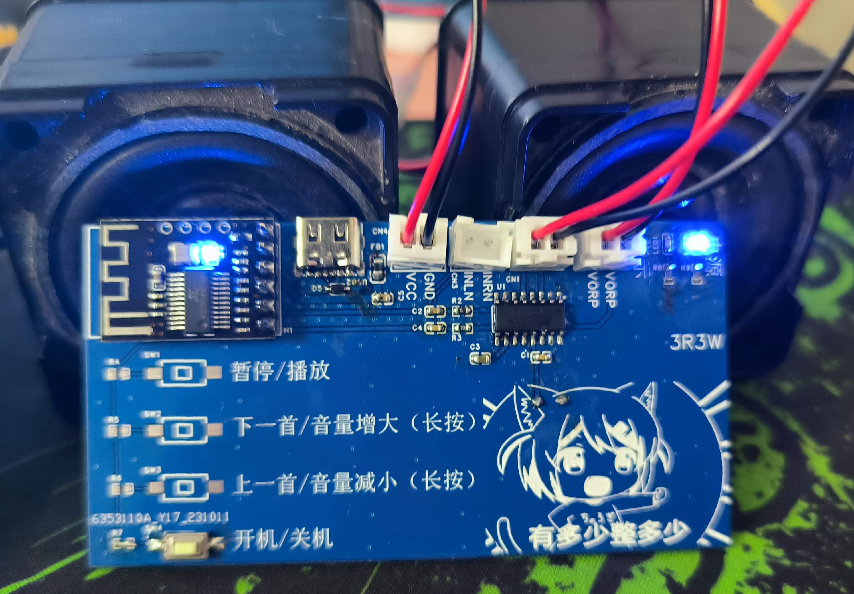

Stereo Bluetooth Speaker 1
A Bluetooth speaker made with an M18 Bluetooth module and NS4248 can be powered by 5V and batteries.
It is recommended to use a 3R3W speaker, and the maximum that can be used is 8R. However, it is not recommended
to use a 4R3W speaker, as it cannot be used with a 5V1A adapter and will cause a restart.
