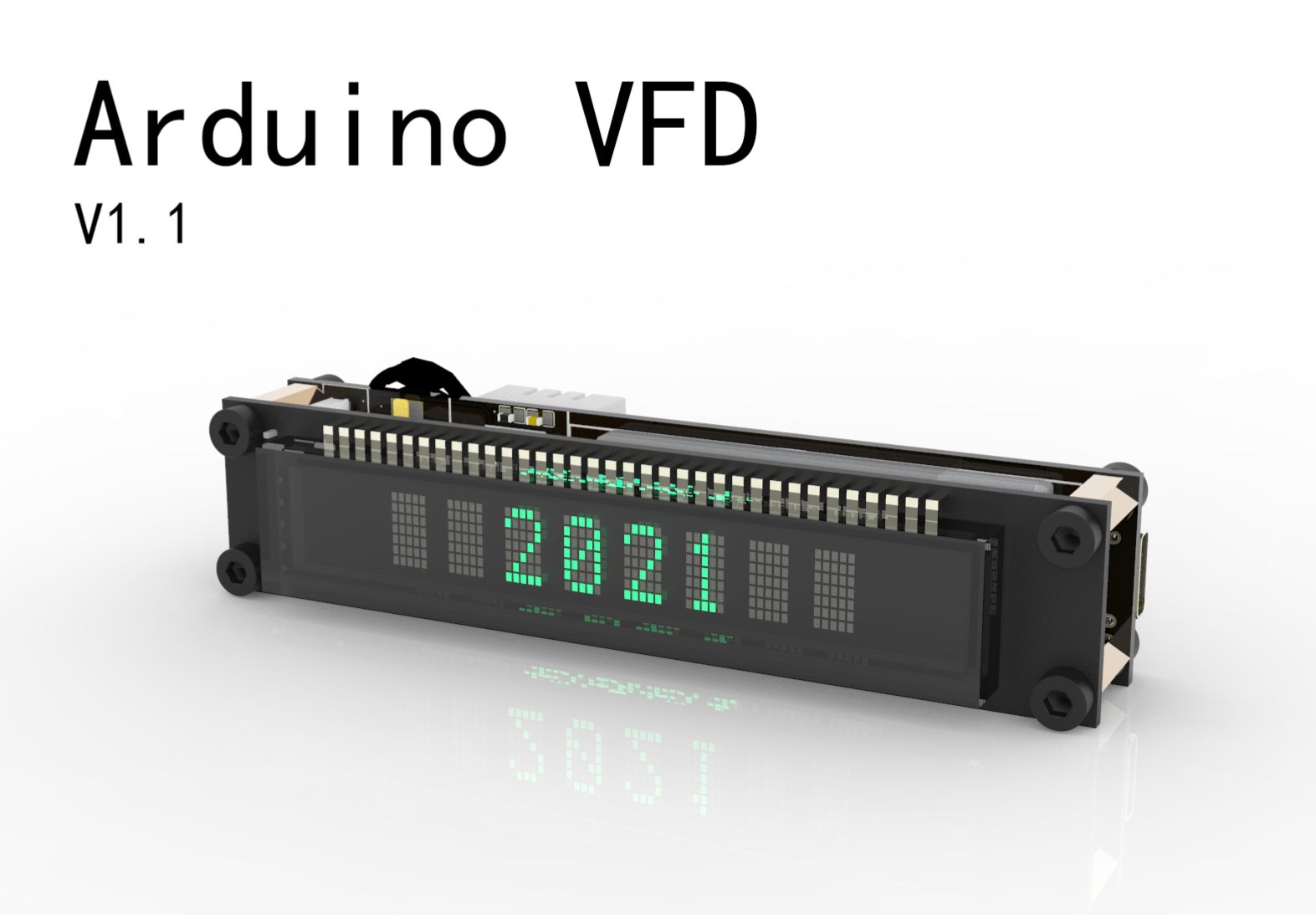

       Because I like the color of VFD fluorescence, I made a VFD clock in 2020. Later, due to a sudden attack of laziness, the program only realized the basic functions and was shelved... and then forgotten.
       Now when I was looking through the folder, I saw this VDF clock project and wanted to share it with everyone. I hope you like it.
The main technical parameters:
Main control: Arduino mini pro main control (328PAU), this one can be removed from the Arduino board and comes with its own bootload;
VFD screen: Futaba 8-bit dot matrix VFD display module. This can be purchased from Taobao. You can buy a bare screen and make your own VFD driver board.
Onboard sensor: photoresistor, adjusts the brightness of the VFD screen according to changes in ambient light, making it brighter during the day and darker at night;
                      Temperature and humidity sensor AM2302, detects indoor temperature and humidity;
                      Clock chip DS3231, accurate travel time;
                      Buzzer, used as reminder sound and alarm clock;
                      Dial switch, used as power on and control keys;
Power supply: 500mAh 3.7V lithium-ion battery and Type-C power supply. There is a dual power switching circuit. Powering Type-C will automatically light up. Battery power can only keep the screen on for about 2-3 hours;
Burning: Onboard CH340C, you can directly use Type-C to burn programs and serial port printing;

Appreciation of renderings
Front renderingFigure 1 Front
Top view renderingFigure 2 Top view
Rendering from behindFigure 3 Back
Later rendering 2Figure 4 Back
