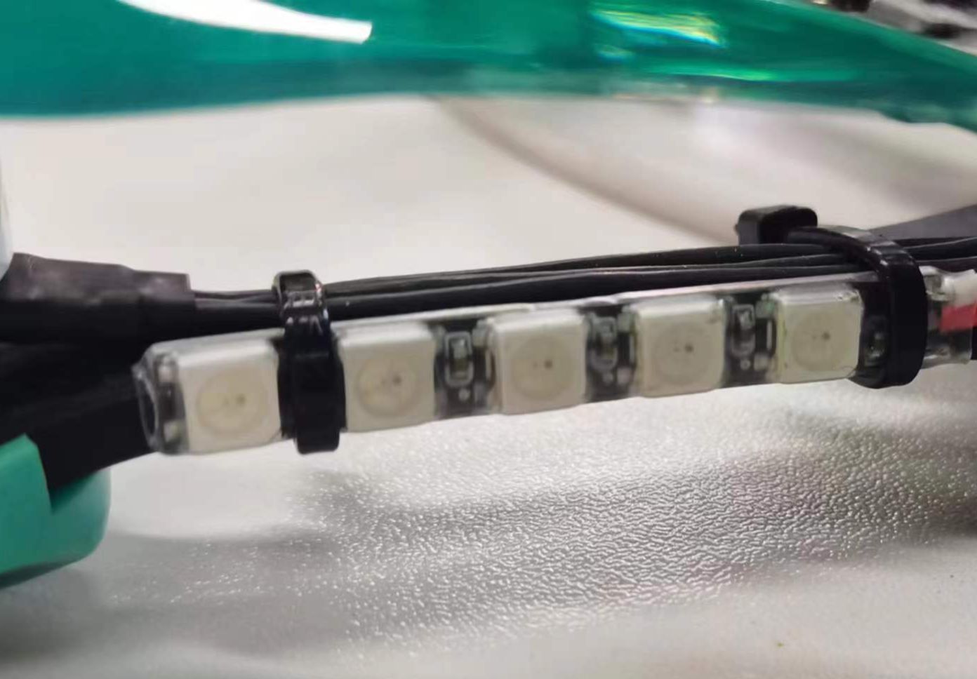

Racing drone light strip
1. Usage Requirements
: BF firmware is compatible with most racing drone flight controllers.
2. Soldering: Pay
attention to the soldering direction of the LEDs. Do not use excessively high heat from the heat gun, as this can
cause yellowing. Poor soldering is a major cause of LEDs not lighting up.
3. Instructions: For
some flight controller LEDs, you may need to press and hold the BOOT button to switch to BF control, such as with Speedbee flight controllers.
4. A thumbs up from a junior member of the Beike team!
