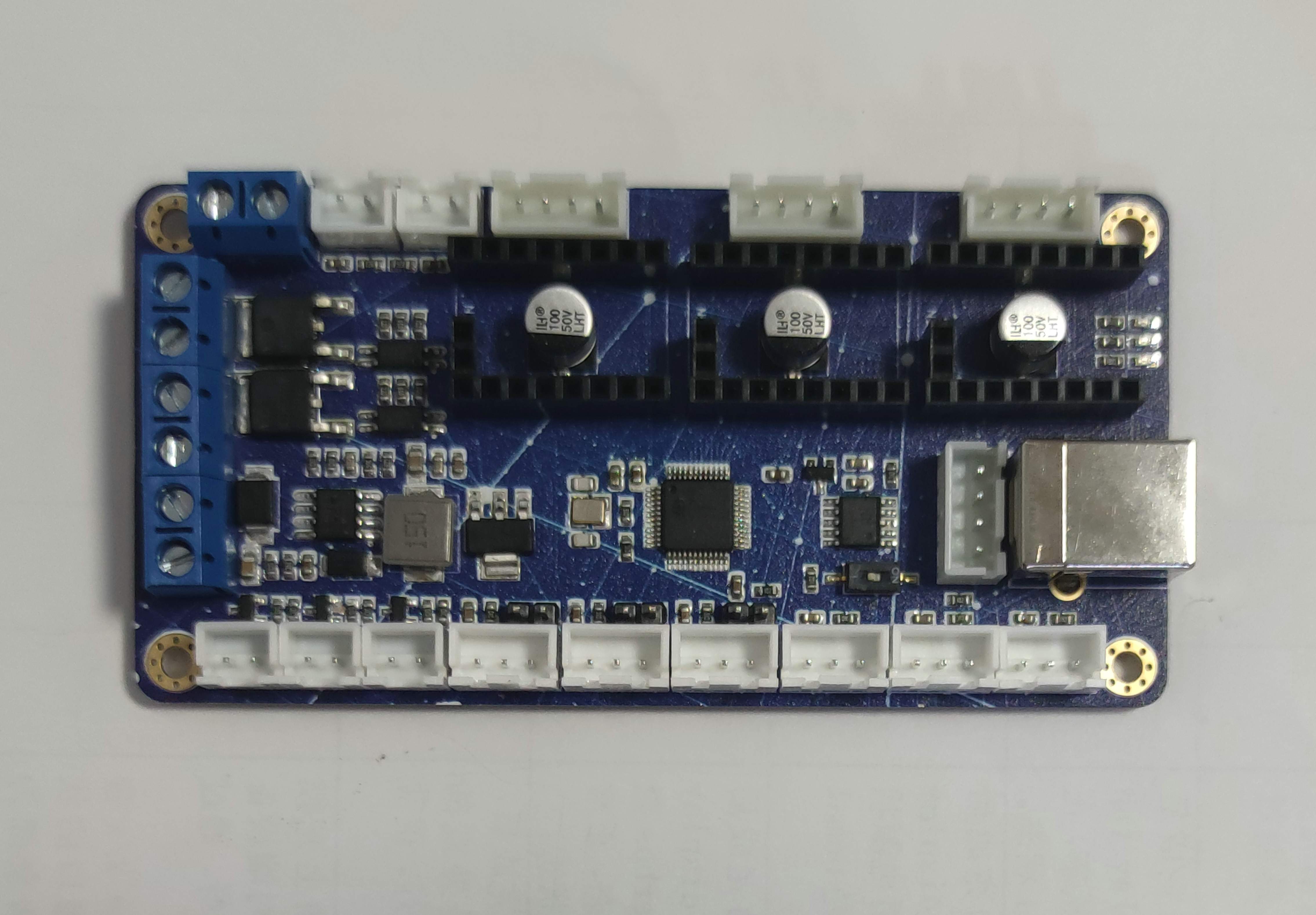

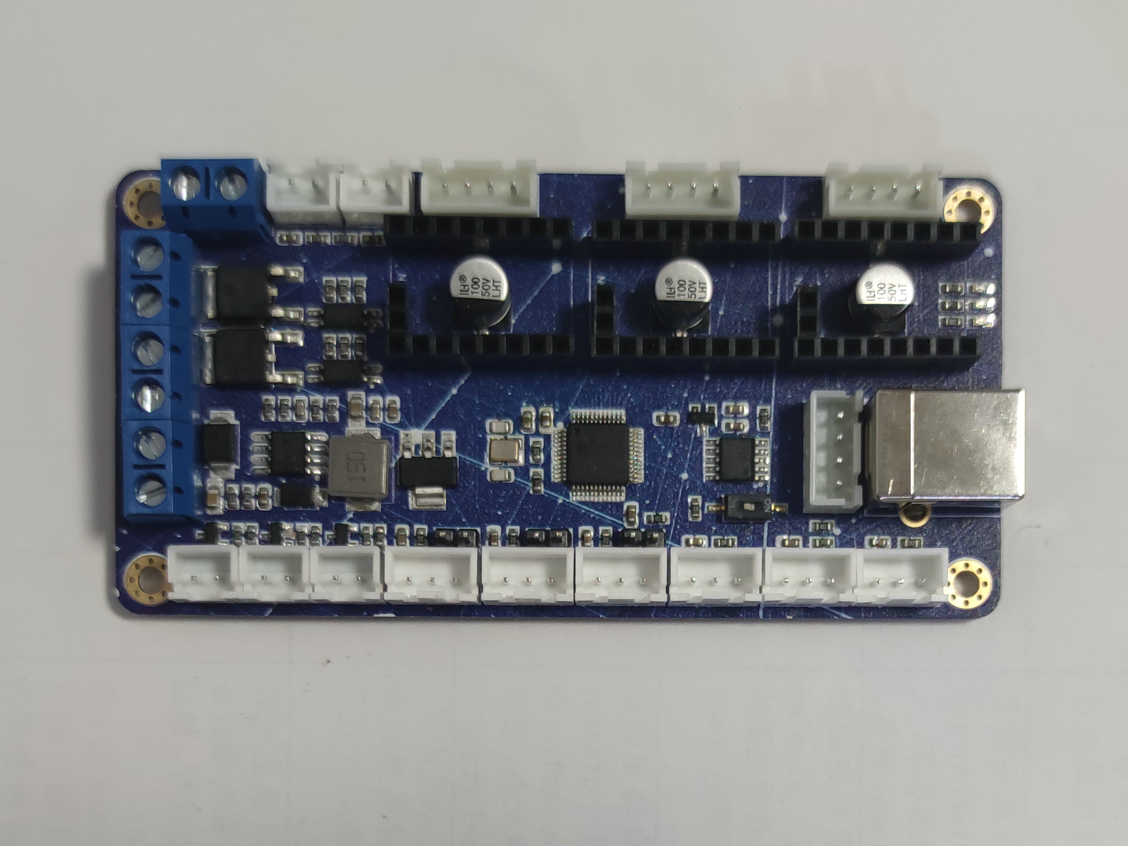

Voron 0.2 3D printer control board
Designed specifically for Voron 0.2, this board requires a tool head for use.
It supports three driver modules, but due to its design for Voron 0.2, it only supports the TMC2209 driver, omitting the driver jumper selection. It features two high-power MOS control interfaces, two thermal interfaces, three controllable fan interfaces, and six multi-function interfaces supporting limit switches, consumable detection, servo motors, etc. Connection to a host computer can be made via USB-A or XH2.54 connectors.
The power supply section supports 24V input, with an onboard DC-DC converter for 5V and 3.3V power, and three power indicator lights.
It only supports the Klipper system.
A physical diagram is shown below.

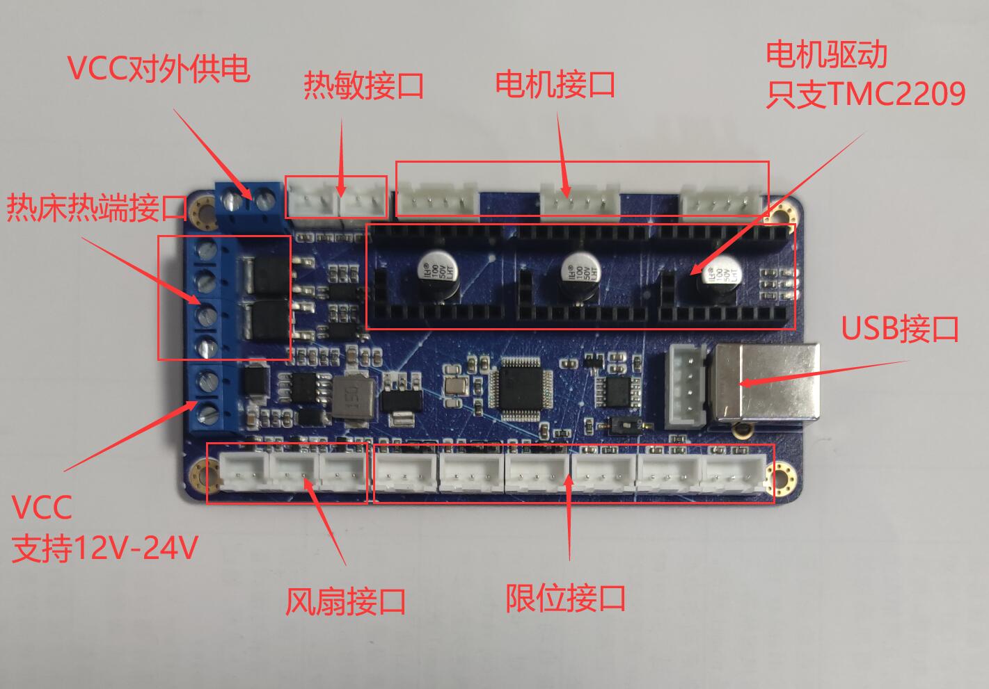

The control board interface is shown below.

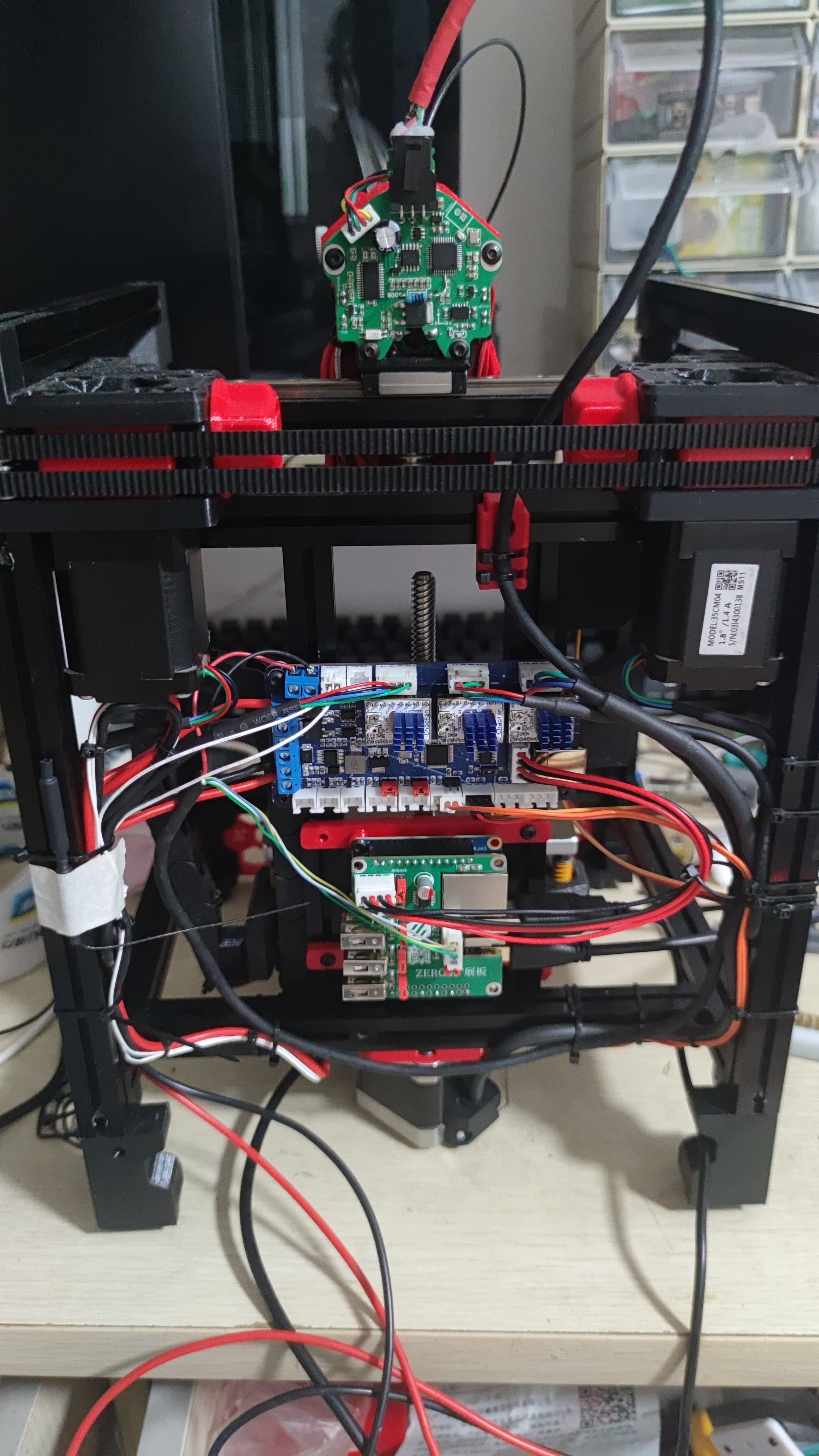

Note: Please refer to the schematic diagram for interface pinouts
when installing on Voron 0.2.
