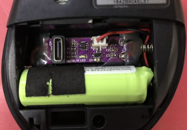

Rapoo RAPOO M500 wireless mouse originally used two dry batteries connected in parallel for power supply of 1.5V. Now it is changed to a 3.7V lithium battery + LDO output voltage of 3.0V for power supply. It is rechargeable. The charging current is now 350mA, and the charging current can be set through a resistor.
