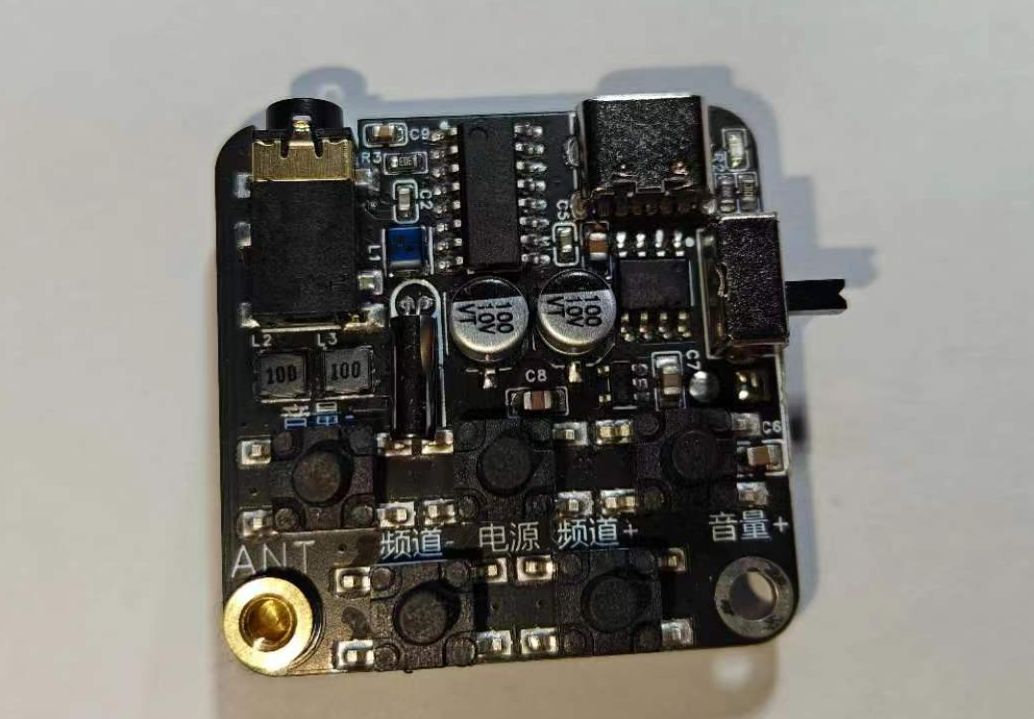

The Mini Radio based on the RDA5807 is compact and has a long battery life.
1. Project Introduction:
Project Name: Mini Radio;
Station Search Method: Automatic;
Supported Frequency: 50-108 MHz;
Demodulation Method: FM;
Dimensions: 36*36*15mm;
Battery Life: Approximately 20 hours of continuous listening using 220mAh*2 batteries; Finished
Product Weight: Approximately 18g.
Employs RDA5807 integrated chip for simple circuitry; built-in headphone driver for high reliability.
The step-down LDO section uses RT9013-30GB for high conversion efficiency and stability.
The charging section uses TC4056 for affordability and fast charging.
