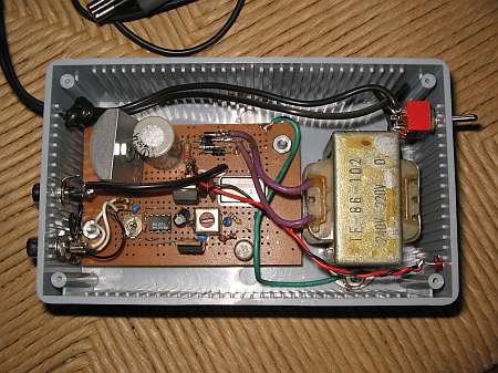

The transmitter is housed in a plastic project box and uses a perforated board instead of a printed circuit board. While a printed circuit board would certainly be more elegant, designing and fabricating one would increase construction time by at least five times!
The RF transformer is actually a 455kHz intermediate frequency transformer salvaged from a discarded transistor radio from the 1970s. I removed its internal 470pF capacitor. With the addition of an external 100pF capacitor, it can easily tune to 1MHz. The higher impedance winding must have approximately 250 microhenries, and the turns ratio of the low impedance winding is approximately 1:10.
The 7812 voltage regulator is mounted on a heatsink. Other components do not require any heatsinks, and even the 2SC1173 gets quite hot.
I'm using RCA jacks for audio input and RF output. You can certainly use other connectors if you prefer. A shielding box would be nice, but not really necessary. After all, you want this thing to radiate a signal!

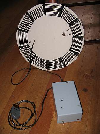

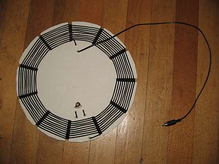

The antenna is a resonant multi-turn loop. It has 19 turns of ordinary household multi-strand wire wound around a sturdy cardboard with 11 slits cut into its edge. Why 11? Well, 10 or 12 would sound better, but we need an odd number so we can create a low parasitic capacitance winding! The wire passes through each slit, altering the side of the cardboard, and to avoid all the turns touching adjacent turns, the number of slits must be odd.
The cardboard disc has a diameter of 30cm and a slit length of 5cm. This makes the innermost diameter 20cm and the outermost diameter approximately 28cm.
The coil is tuned in parallel with a fixed capacitor via a nice old Philips air-dielectric trimmer capacitor. This capacitor is connected across the two ends of the coil. The feed is mounted on a single turn, with the shield positioned exactly in the middle of the coil (midpoint of the 10th turn) for optimal balance. A small coaxial cable (RG174 or standard audio shielded cable) is mounted through holes punched in the cardboard for stress relief. The trimmer capacitor is also mounted through the board.
The tuning system is simple: First, you connect a load resistor of about 50 ohms to the transmitter and tune T2 to obtain the highest signal. You can measure this with an oscilloscope, or with a simple RF probe and multimeter. Then you connect the antenna and tune its trimmer capacitor to obtain the maximum signal. The two sides of the trimmer capacitor are hot on RF, so use an insulated tool, or tune in small increments with your fingers, removing your hand between them to eliminate hand-introduced detuning. You can measure the signal at both ends of the feed tap, or with a pickup loop placed close to the antenna. When tuning, there will be about 5V on each turn, so a single turn placed close to the antenna (10cm is close enough) will pick up about 5V RF, which is easy to measure.
The antenna's natural Q-factor is above 300, so it would be too high to allow a full 10kHz wide amplitude modulation signal to pass through! Therefore, I fed the antenna through a full turn. This damped it significantly, resulting in an overall Q-factor of nearly 60. This is great for achieving sufficient bandwidth while strongly suppressing the rather strong harmonics generated by the transmitter. The RF signal picked up from the antenna is very clean, while the signal entering the dummy load from the transmitter is anything but clean.
This is a screenshot of the picked-up signal, modulated with a triangle wave to the point where distortion begins. Up to 80% modulation, the transmitter is highly linear. As modulation is increased further, the distortion becomes visible on the oscilloscope and audible on the radio! I recommend setting R4 to 80% modulation for the highest audio peak. You can do this using an oscilloscope or by ear, adjusting R4 to get the highest possible modulation without audible distortion.
The antenna radiates only a fraction of the 50mW the transmitter can provide. When tuned, the antenna's input impedance is much higher than 50 ohms, causing a significant mismatch with the transmitter. This is perfectly fine, given the transmitter is fully anti-VSWR (thanks to R6), and considering the transmitter's purpose is simply to send a signal to a radio in the same household! For that, you don't need more than about one milliwatt of effective radiated power. The system does a great job. At a distance of 6 meters between the transmitting antenna and a 1935 tube radio, the received signal is about as strong as two of the three strongest local AM stations I can receive. Outside my house, the signal quickly becomes undetectable.
