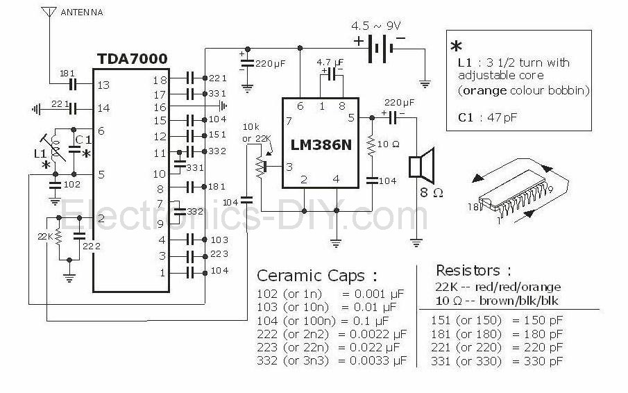

This project is an FM radio based on the TDA7000 and LM386 integrated circuits. The unique aspect of the TDA7000 integrated circuit lies in its operation. It's a standard FM superheterodyne receiver with a typical local oscillator, mixer, intermediate frequency amplifier, limiter, and phase detector. The difference is that it only has one tuning circuit: the local oscillator. Similar to pulse-count receivers, the TDA7000 relies on a low intermediate frequency (IF), so ordinary operational amplifier circuitry can handle the gain and bandpass characteristics. The TDA7000 only uses an IF of 70 kcal/s. Now, you might recall that the deviation of a broadcast FM signal is +/- 75 kcal/s. Therefore, a fully modulated signal would sound quite distorted. So, how does this IC work?
Simply put, Philips calls it a frequency-locked loop. Essentially, the local oscillator is offset based on the detector output, ensuring the mixer output bandwidth never exceeds +/- 15 kc/s. It effectively compresses the frequency range of the modulated signal.
The mute or suppression function is, to say the least, novel. While it works like any other mute circuit, the TDA7000 provides an artificial noise generator so that the receiver still sounds active when tuned away from the radio station. If you don't need this function, simply remove the .022uF capacitor at pin 3. Not all Philips datasheets show this, but connecting a 10K resistor from the power supply to pin 1 will disable the suppression function.
Block diagram of the TDA7000 used in a typical FM receiver. The audio output is approximately 75mV.
At this point, I recommend you check out Philips' application notes. They provide good background on the design and use of this IC. Out of curiosity, check out the application notes on narrowband FM here. If you think low IF is suitable for NBFM receivers, you're right. Note that the TDA7000 is not suitable for feeding into a stereo decoder.

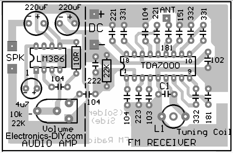

I bought my first TDA7000 IC in 1988 and tried to build a receiver on a matrix board. Here, I learned my first important lesson: layout and ground planes are crucial for using this IC. Philips' datasheet provided the PCB layout, which shouldn't be changed too much. Of course, my matrix board receiver didn't work properly.
Purchased from Tandy in Chatswood; like all their components, the packaging is overly extravagant. Includes an abbreviated reprint of the Philips AN192 application notebook.
Shortly after, Electronics Australia published an article (June 1988) using the TDA7000 and LM386 for audio. So, I bought the PCB and built only the TDA7000 portion. I didn't like the LM386 (and still don't), so I made a dual-transistor Class A amplifier on a separate PCB. Another change was using BB809 varactor diodes for tuning. I didn't like EA's idea of using trimmer capacitors.

I built this receiver in 1995 and used it on trains for several years. The circuitry is very typical, using an LM386 for the audio stage. The LM386 is a very noisy IC, and I certainly didn't like it.
Initially, I built it in a plastic case with a speaker, but wanting to make it smaller, I made a new housing out of aluminum with a Lexan cover (January 2004). I didn't bother including a speaker because I rarely used it. However, once I did, the performance seemed very poor. The sensitivity was really bad. Eventually, I noticed that there seemed to be some kind of stray oscillation occurring. Bridging the negative battery terminal directly to the housing brought a huge improvement and permanently fixed it by connecting the PCB ground plane directly to the chassis instead of just relying on the headphone jack. This perfectly illustrates how picky things are in the VHF band.
I mounted four AA batteries on the PCB, where the Silicon Chip was originally intended to house the speaker. No suppression switch was used; instead, suppression was permanently disabled. The telescopic antenna extends 75 cm, which is a quarter wavelength.

How does it perform? It works very well for strong local radio stations, with excellent sound quality. Sensitivity is good... I hesitate to agree with Philips' claim of 1.5uV... I'm more inclined to agree with Elektor's 7uV. I should mention that Elektor's article includes an RF amplifier, which supposedly increases the sensitivity to 0.5uV.
The first significant limitation is the very wide acquisition range due to the AFC circuitry. It is quoted as +/- 300 kc/s. This makes it impossible to receive weaker stations on frequencies close to those of stronger stations. For example, at my home, I have 2ONE at 96.1 Mc/s, about 5 km away, and I cannot receive 2WL at 96.5 Mc/s, about 90 km away. Nova at 96.9 Mc/s from Sydney (50 km away) makes the situation even worse.
The worst feature is on weak signals. It's not just noisy, there's also terrible distortion. Super-regenerating and pulse-counting receivers sound much better on weak signals.
Tuning the receiver is crucial, despite what Philips says in their application notes. In fact, it's better to enable suppression during tuning, because you'll only hear a signal when the receiver is properly tuned.
Mentioning these limitations is by no means a negative criticism. All receivers are ultimately limited in some way; I'm merely assessing the performance of the TDA7000. The average listener won't use the receiver the same way I do. In this respect, the TDA7000 performs no worse than most commercially made portable FM radios. In fact, it performs much better than some I've tried.
My suggestion is to use a speed reduction drive to lower the tuning control, or use a potentiometer with a varactor diode. Keep suppression enabled, or at least have a switch to disable it if you wish. Don't expect it to perform like a super DX receiver. As with all types of receivers, give it a decent antenna!
I highly recommend this IC for use in situations where sound quality is important but the user is not technically skilled. In itself, and due to its ease of use, it makes for an excellent FM receiver.
