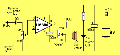

LM386
The LM386 is a high-power operational amplifier. It is used to drive speakers. The inverting input is connected to the negative power rail, and the non-inverting input is connected to a capacitor. Internal resistors provide bias to this input, so only about 7mV is needed for the chip to turn on. This voltage is called the offset voltage.
When a signal is applied to the "+" input, the chip amplifies the waveform, and the result appears on pin 5. The chip's gain depends on the impedance of the path between pins 1 and 8. We have placed a variable impedance between these pins, consisting of a 22uF capacitor and a 10kΩ potentiometer; by changing the resistance of the potentiometer, the chip's gain will be adjusted.
The gain can be adjusted from 30 to 200, and these numbers are displayed on the board's overlay.

The probe amplifier has a volume control in the form of a gain control to change the output volume from the earpiece. Approximate gain is indicated around the control.
An additional probe can be connected to the board via a small socket, which will allow the mini amplifier to be placed close to your ears so you can monitor the audio.

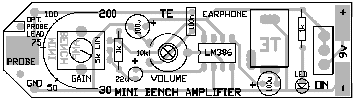

If it doesn't work
Turn on the audio probe and set the gain control to maximum. Touch the active probe with your finger. You should hear a slight hum from the speaker. This is a quick test to show the project is working. If nothing is detected, you should follow these steps:
If the power LED is not lit, the most likely reason is that the battery is dead or the battery terminals are not making contact.
Also check the placement of the LEDs, as they may be facing the wrong direction.
Next, check the current drawn by the circuit across the switch (with the switch in the OFF position). It should be approximately 10mA.
If the earbuds are not making a sound, use a multimeter to measure their resistance. When you do this, it should produce a slight "click" sound and measure about 8 ohms.
Check that pin 1 of the IC is close to the cutout on the cover layer and see if all pins of the chip are in the socket. Sometimes pins are bent and not making contact. Also ensure that all pins of the socket are soldered to the board. This applies to all other components. Finally, ensure that the positive terminal of the battery is connected to the positive power rail on the board and the negative terminal is connected to the negative power rail.
There are almost no other areas where things could go wrong, and the project should be working now.

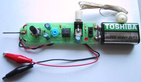

Using an audio probe
All you need to do is connect the ground wire to the project you are testing, turn on the audio probe and the project you are testing. Use the probe or active leads to probe various points on the project under test and listen for audio. The gain control on the audio probe is very similar to the volume control, allowing you to hear the audio without overdriving it.
Most amplifier stages have a gain of around 50-70. Some have a gain of around 100, but that's the highest you'll get.
It's impossible to determine whether a stage has high or low gain simply by listening. The only way to calculate the gain factor is to use a CRO (cathode ray oscilloscope).
A clever fault-finding method is to obtain another identical unit and compare them.
To do this, you need to place both side by side and connect the ground wires together. Turn both on, and then you can probe each level and compare them.
