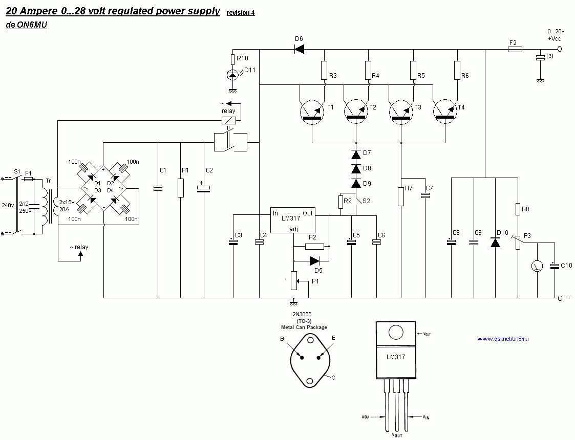

0-28V 20A power supply (LM317, 2N3055)
S2 switches between ±3 amps and full output current.
The relay is used to cut off the power supply voltage when the power supply (S1) is turned off. Therefore, there is no delay caused by the discharge of C2, thus ensuring that the output voltage returns to zero immediately.
Use the MB2504 because it is a 25-amp rectifier bridge and also requires cooling. Alternatively, you can use eight BYW29 8-amp diodes (TO220 package) mounted on a heatsink.
Install a small heatsink on the LM317 IC.
Remember to isolate the 2N3055 transistor from the chassis/heatsink! Use a heatsink of appropriate size and surface area; insulating and thermally conductive pads or at least thin mica; thermal adhesive and thermal paste.
2 x 15 volts ± 20 amperes
D1...D4 = Rectifier bridge MB2504 (25 amps, cooled)
Or eight BYW29 8-amp diodes (TO220 package, cooled)
Alternatively, 8 x MR750 (MR7510) diodes (MR750 = 6 Ampere diodes) or 16 x 1N5401 (1N5408) diodes.
F1 = 2 amperes
F2 = 25 amperes
R1 2.2k 2.5 Watts
R2 240 ohms
R3, R4, R5, R6 0.1 ohms 10 watts
R7 6.8k
R8 10k
R9 47 ohms 1 watt
S2 micro switch
R10 8.2k
C1,C7,C9 47nF
C2: Four 4700uF/50V capacitors or one 22000uF/50V capacitor.
C3, C5 10uF/50v
C4, C6, C9 100nF
C8 330uF/50v
C10 1uF/16v
D5 1N4151
D6 1N5401
D10 MR750
D11 LED
D7, D8, D9 1N4001
IC1 LM317
Two 2N3055 transistors
P1 5k
P3 10k fine-tuning potentiometer
Relay = 30 volt AC, 2 x 10 amp switch
