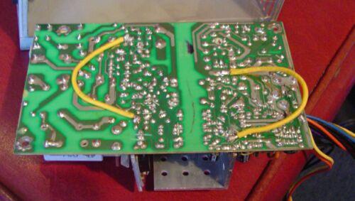

The heatsinks used in power supplies are typically soldered to the PCB via small metal plates. Current usually flows through them, meaning they carry voltage and are part of the circuit. What you need to do is cut these plates, remove the heatsinks from the circuit, and then replace their parts in the circuit with wires.
When finished, it might look like this (where the wires are on the metal plate):

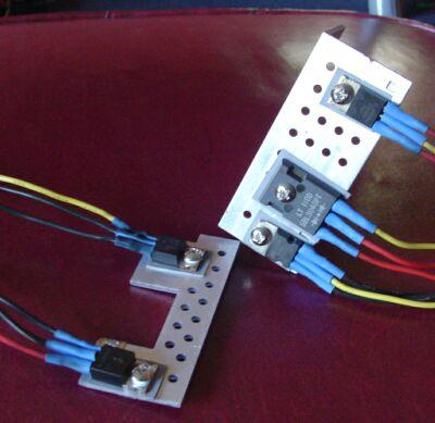

The second part can be accomplished in several ways, such as making heat sinks to replace the existing ones and mounting them onto a larger heat sink (which is what I do below), or extending the transistors with wires and mounting them directly onto a large heat sink.

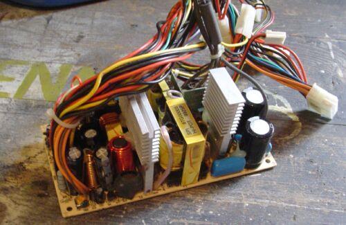

I was lucky enough to get a 150-watt Micro ATX power supply with a grounded heatsink:

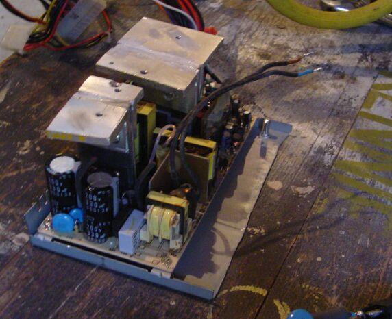

Then I made a similar heatsink using regular 5mm aluminum. I did this because the original heatsink was difficult to bolt onto the larger heatsink.
