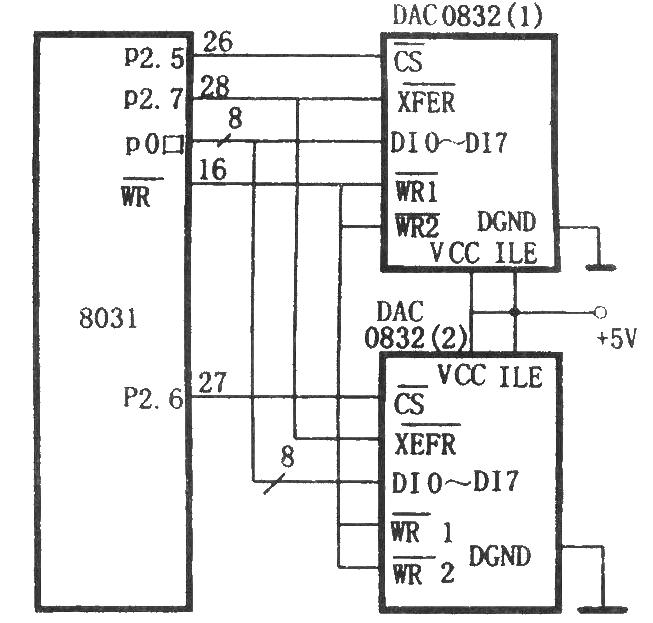

Double buffer synchronization interface composed of DAC0832 and 8031 microcontroller
Source: InternetPublisher:fish001 Updated: 2021/08/02
DAC0832DAC0832 is an 8-resolution D/A conversion integrated chip. Fully compatible with microprocessors. This DA chip is widely used in microcontroller application systems due to its advantages such as low price, simple interface, and easy conversion control. The D/A converter consists of an 8-bit input latch, an 8-bit DAC register, an 8-bit D/A conversion circuit and a conversion control circuit.
8031 is one of the most common mcs51 series microcontrollers. It is an early mature microcontroller product of Inter Company, and its application range involves all walks of life.
