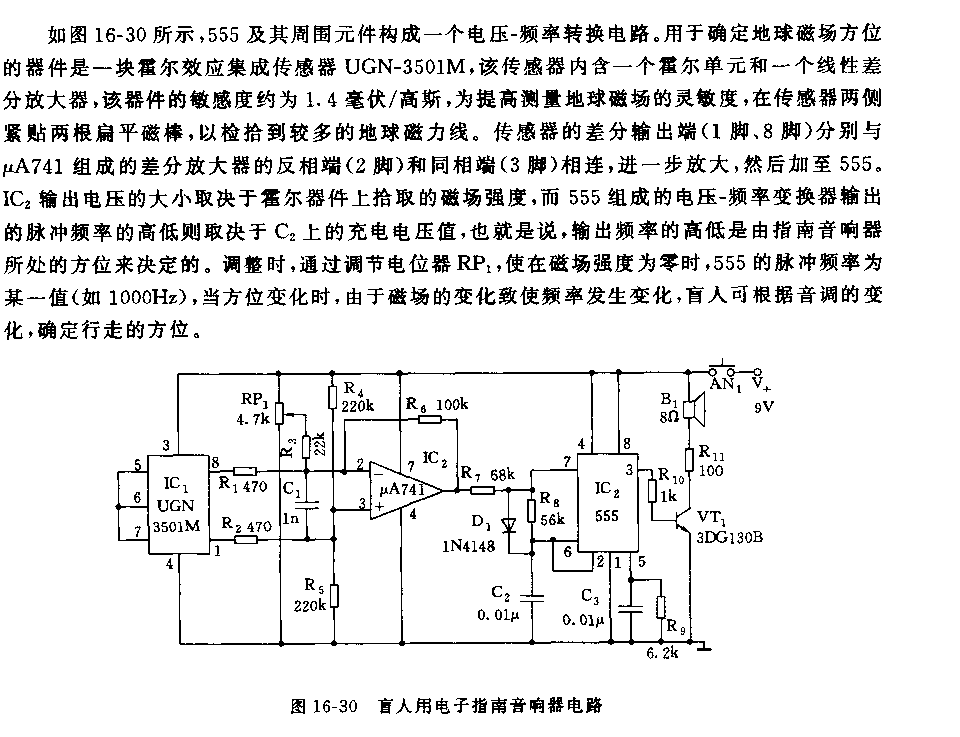

555 electronic guide speaker circuit for blind people
Source: InternetPublisher:MartinFowler Updated: 2021/02/16
UGN3501MA741NE5553DG130B
