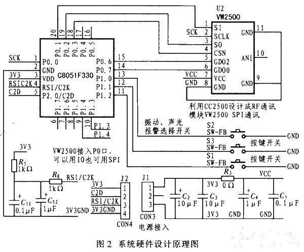

This article designs a mobile phone anti-theft alarm system using the fully integrated mixed-signal system-on-chip (MCU) C8051F330 and the wireless transceiver CC2500. The alarm system uses radio frequency transceivers to achieve short-range information transmission. The mobile phone anti-theft alarm system uses the highly integrated C8051F330 device and the RF communication device CC2500 to realize real-time communication between the mobile phone and the user, effectively preventing the loss and theft of the mobile phone. Since the system uses C805lF330 and CC2500 as core devices, it has a simple structure, stable performance, small size and low cost. It has been successfully used for anti-theft alarms on mobile phones, and the effect is very good.
System hardware design
The hardware design of this system is mainly used to realize RF communication between C8051F330 and CC2500. Since C805lF330 integrates a high-precision clock source, its internal 64 KB Flash is sufficient for system use. Therefore, when designing the oscillation circuit and storage circuit, there is no need to expand, only the power supply circuit, CC2500 communication circuit, and reset circuit are designed. This allows the system hardware design circuit structure to be simple, highly integrated, and reliable. Figure 2 shows the system hardware design schematic diagram. In order to improve the communication speed and reliability of the system design, CC2500 can be used to enable the system to achieve SPI communication with the C8051F330 through the RF communication module VW2500. VW2500 and C805lF300 are powered separately through R3 to reduce the interference of radio frequency signals to the MCU and ensure reliable operation of the system.
