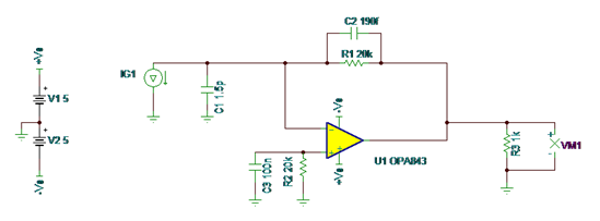

    Let's start with the OPA843, a bipolar amplifier with excellent noise and gain-bandwidth. Set to a gain of 20kW and using a 1.5pF input capacitor with the photodiode, the OPA843 achieves a flat frequency response of approximately 57MHz under these conditions. See Figure 1 below.
     How to Build a TIA Circuit Using a Fully Differential Amplifier
    Figure 1: OPA843 TIA configuration

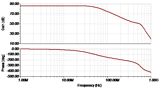

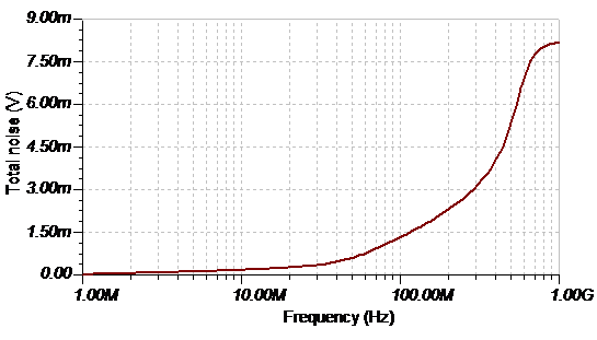

    Figures 2 and 3 show the performance of the OPA843 monitored here.
    Figure 2: OPA843 frequency response
    Figure 3: OPA843 integrated output noise
    The OPA843 consumes approximately 200mW when operating on ±5V supplies.

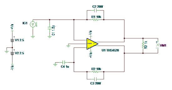

    Looking at the 14mA on the +5V supply FDA (70mW) THS4520, we can achieve the same 20kΩ transimpedance gain by using a 10kΩ resistor in the feedback path. C4 is required to achieve this gain of 20kΩ. Note that for frequencies below the pole formed by R2 and C4 (here, 16Hz), the gain is reduced by 6dB.
    Figure 4: THS4520 TIA configuration

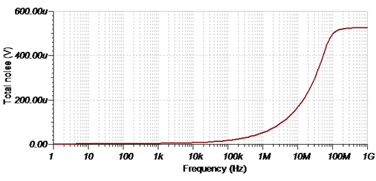

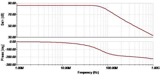

    Despite the increased bandwidth, the THS4520 achieves approximately 74MHz of bandwidth with significantly lower integrated noise than the OPA843. This reduced noise is due in part to the THS4520's lower current noise density (for the same voltage noise density), but also due to the lower noise gain resulting from the lower feedback resistor and higher compensation feedback capacitor used to achieve the same gain. The two main terms contributing to the noise reduction are lower noise gain vs. frequency and lower feedback resistor and its associated thermal noise. The results are plotted in Figures 5 and 6.
    Figure 5: THS4520 frequency response
    Figure 6: THS4520 integrated output noise
