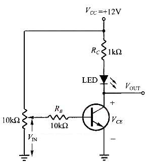

Experiment: The switching function of a transistor

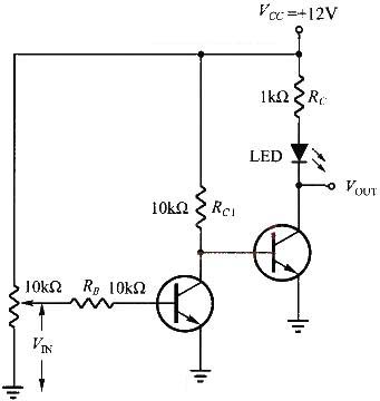

is simple. Transistor switch: The circuit is shown in Figure 5. Resistor RC is the LED current limiter to prevent excessive voltage from burning out the LED (light-emitting diode). Adjust the input signal VIN from 0 to maximum (divided into approximately 20 equal steps). Observe and record the corresponding VOUT and LED brightness. When the transistor switch is off, VOUT = VCC = 12 V, and the LED does not light. When the transistor switch is on, VOUT = 0.2 V, and the LED lights up. Improved transistor switch: Because a transistor transitions from the cutoff region to the saturation region through the linear region, the switching effect does not have a clear boundary. To make the switching effect more clear, two transistors can be connected in series. The circuit is shown in Figure 6. Similarly, adjust the input signal VIN from 0 to maximum (divided into approximately 20 equal steps). Observe and record the corresponding VOUT and LED brightness.
Figure 5: Simple switching transistor circuit diagram.
