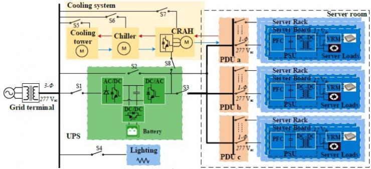

    Figure 1 shows a common and widely used data center AC power distribution system. The power system includes a centralized uninterruptible power supply (UPS), power distribution units (PDUs), rack-level power supply units (PSUs), server boards, and loads. The air cooling system includes cooling towers, chillers, pumps, computer room air handlers (CRAHs), and server room fans.
    Power Simulator Predicts Data Center Dynamic PerformanceFigure 1: Typical AC power distribution system in a data center
    To improve system power efficiency and maintain reliable server operation, data centers typically use multi-mode operation. The following three main operating modes are used:
    1. Normal Eco mode, used when utility power is within acceptable limits to directly support server loads through the PDU and PSU. In this mode, the UPS is bypassed and operates at light load.
    2. Double conversion mode, used when the utility voltage is not within the permitted range but still within the UPS input range. In this mode, the UPS turns on to regulate the power and supply power to the server load.
    3. Battery mode: used in the event of a power failure or major grid outage. In this mode, the UPS is disconnected from the grid, and the backup battery provides the required DC power to the inverter. The server load is continuously powered by the UPS until the utility power is restored.
    In the event of a severe power outage, the cooling system is disconnected from the grid and the CRAH is powered by UPS backup power to keep air flowing until AC power is restored.

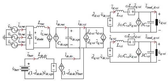

    Data centers can be represented using a nonlinear average model that does not account for switching ripple. The average model of a UPS operating in continuous conduction mode (CCM), as shown in Figure 2, includes the front-end boost power factor correction (PFC) rectifier, VSI, DC/DC converter, and battery pack for energy storage. The UPS battery pack consists of two parallel stacks of 182 lithium-ion cells. Appropriate mathematical equations are used to simulate the battery charging and discharging processes.
    Figure 2: UPS average model

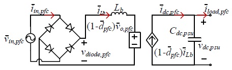

    In CCM operation, the average model of the PFC converter (PSU front end) is shown in Figure 3. Its purpose is to improve the power factor and provide DC bus voltage regulation.
    Figure 3: PFC average model

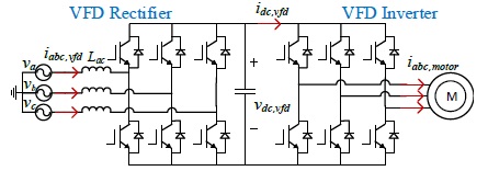

    Regarding the cooling system, aggregated grid-connected induction motors are used to represent the cooling towers, chillers, and pumps, while the CRAH is modeled by motors based on two-stage variable frequency drives (VFDs) (Figure 4).
    Figure 4: VFD-based motor model

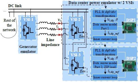

    The next step involves converting the nonlinear average model into a discrete-time version through digitization. A generalized model with explicit input and output variables is required, and all data center model and control functions are implemented on the HTB platform's VSI digital signal processor.

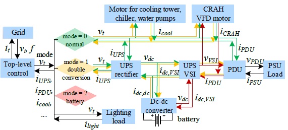

    First, the entire nonlinear average model is digitized with a 0.2 millisecond sampling period and converted into discrete-time equations. Subsequently, a generalized model with top-level control is proposed for a data center power simulator, as shown in Figure 5. Given the terminal voltage (Vt) and grid frequency (f), the top-level control determines the operating mode based on the Vt value. At each model level, the input variable is the output voltage of the previous level, while the output variable is the calculated input current, which is passed to the next level. Finally, the top-level control updates the grid terminal current (it) and begins a new operating cycle.
    Figure 5: Generalized model with top-level controls
    The data center simulated on HTB is shown in Figure 6.
    Figure 6: Structure of the data center simulator on HTB

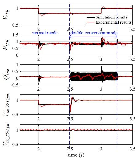

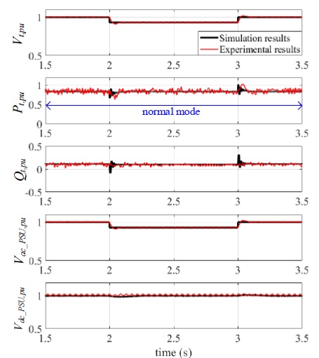

    The experimental results are shown in Figures 7-9, each of which refers to a different voltage sag event, as this is one of the most common grid disturbances. The comparative waveforms include the terminal voltage amplitude (Vt,pu), terminal active and reactive power (Pt,pu and Qt,pu), the power supply AC input voltage (Vac_PSU,pu), and the power supply DC bus voltage (Vdc_PSU,pu). Figure 7 shows the case of a 7% terminal voltage sag. Because the terminal voltage did not exceed the allowable input range, the data center system continued to operate in normal mode. However, the dynamic changes in Vt,pu affected the induction motors in the cooling system. When a 26% voltage sag occurred (Figure 8), the data center switched from normal eco-mode to double conversion after 500 milliseconds at t = 2.5 seconds. Simultaneously, the UPS switched from a very light server load to a heavy load, resulting in a transient response and subsequent Vt,pu fluctuations. Due to the sudden voltage change, the data center performed transient power changes at the beginning and end of the voltage sag.
    Figure 7: Experimental and simulation results of a 7% voltage sag for 1 second

    Figure 8: Experimental and simulation results of a 26% voltage sag for 1 second

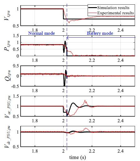

    Figure 9: Experimental and simulation results for voltage sag > 30%
    Figure 9 shows a more severe voltage sag, greater than 30%. Here, the data center load was disconnected from the grid 20 milliseconds after the sag to protect the PSU and maintain normal server operation. The UPS battery powered on to continue supporting the load, while P t,pu and Q t,pu dropped to zero after the load shedding. In summary, these results demonstrate the consistency between the experimental simulation and the simulation model, validating the accuracy of the power simulator.
