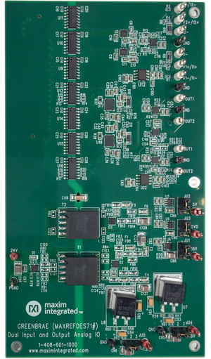

Advanced manufacturing, custom production and cost pressures continue to drive factories toward higher production speeds and greater flexibility. To meet the requirements of "no compromise" factory environments, the MAXREFDES71# subsystem reference design provides two high-speed, high-precision, 400ksps, 16-bit analog input channels and output channels. All input and output channels support ±10V and ±20mA signals, plus 20% margin, providing flexibility for low- and high-speed systems using voltage or current signals.
The MAXREFDES71# design uses four dual-channel fast-settling, high-voltage op amps (MAX9633); two 16-bit 500ksps ADCs (MAX11166); two low-noise, fast-settling, high-precision, 16-bit DACs (MAX5316); two ultra-high Accurate 4.096V voltage reference (MAX6126); seven high-speed digital isolators (MAX14850); H-bridge transformer driver for isolated supplies (MAX13256); and regulation of +18V, -18V, +5V, and -1.25V power rails device (MAX8719, MAX8881). By using high-precision and high-speed components, the subsystem performs well in both process control applications (such as sensor inputs) and control applications (such as servo drives, resolvers and encoders).
