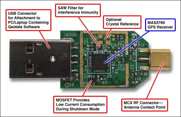

GPS USB Reference Design Using the MAX2769
GPS USB Reference Design with the MAX2769
Figure 1. Top view of the GPS reference design that features the MAX2769 universal GSP receiver.
Figure 1. Top view of the GPS reference design that features the MAX2769 universal GPS receiver.
Figure 2. Bottom view of the design board.
Important Design Features
  • Complete USB Solution When Paired with Geotate Software
  • MAX2769 Offers 1.4dB Cascaded Noise Figure, and 115dB Gain with 60dB AGC Range
  • Receiver/Software Combination Provides -139dBm Acquisition Sensitivity and -152dBm Tracking Sensitivity
  • Choice of Two LNAs for Use with Active or Passive Antenna
  • Choice of Single or Dual Frequency References
  • Fractional-N Synthesizer and Wide Range of IF Filters for Maximum Flexibility
  • SAW Filter for Noise Immunity
